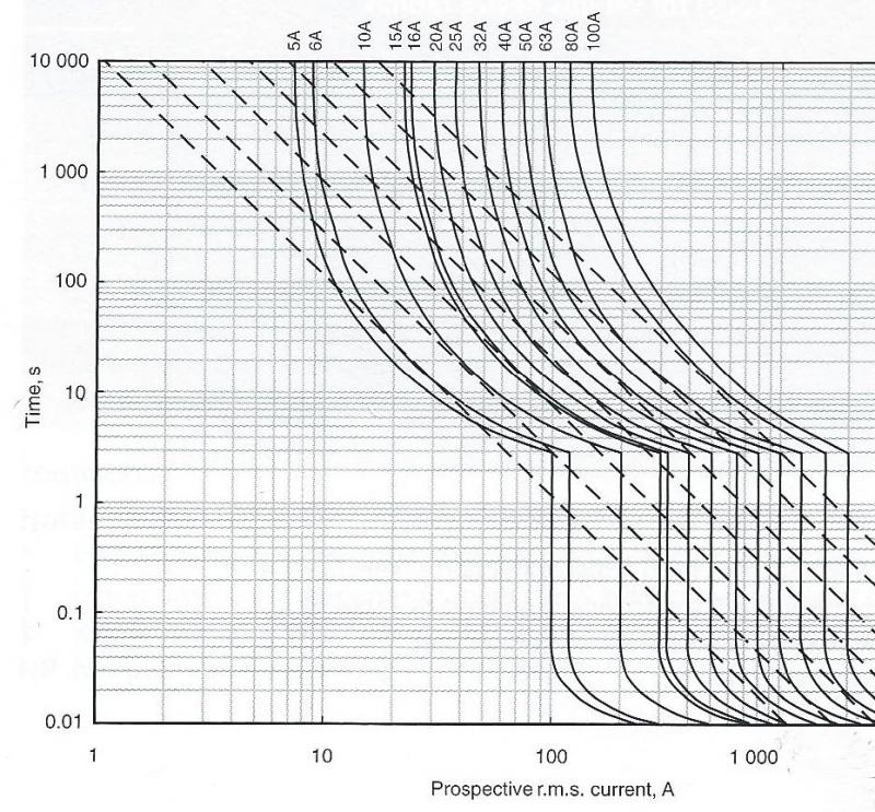

Further to my recent response, I think I may have discovered why the 'general practice', which most of us follow, does not assume a disconnection time of 0.01 secs (and probably why we usually use 0.1 secs).
I recently wrote to EFLI that MCB operating curves are essentially vertical '...in the region which interests us'. What I should have said is '... over disconnection times from well over 1 second down to 0.01 seconds' (0.1 seconds being where the BS7671 curves stop). However, I've now found a curve in the IET Elecrical Installation Design Guide which gives (unfortunately only for a Type D MCB) some insight into what happens to the curve below 0.1 seconds....
As can be seen, the curves remain 'straight and virtually vertical' down to about 0.05 sec but, below that, things change dramatically. If you consider the D10 curve above (the easiest to see!), the curve is, as expected, 'straight and virtually vertical', at a current of 200A (20 x In) from about 3 seconds down to about 0.05 seconds. However, since the curve then deviates from its previous straight line, to get down to 0.01 secs requires a current of about 500A (50 x In). Although much more difficult to see on the curves, for a D32, the curve is 'vertical' at a current of 640A down to about 0.05 secs, but to get down to 0.01 secs requires a current of around 1600A.
I obviously don't know whether Type B and C MCBs behave in the same fashion, but I suspect they are probably similar. If that is the case, then to use 0.01 sec would only be appropriate if one knew that PFC was more than about 2.5 times the 'magnetically operating' current (i.e. that Zs was less than about 40% of what would be needed to just satisfy disconnection time requirements). The curves above suggest that it would probably be reasonable to assume 0.05 secs (rather than 0.1 sec) for a Type D. However, maybe the curves are not 'vertical and straight' down as low as 0.05 secs for Type B and C MCBs - which could well explain the generic 0.1 sec which seems to be assumed in calculations (by most people!) for any type of MCB.
Of course, if (at least for a Type D) one knows that the PFC is at least 2.5 times the 'magnetic trip' current (which obviously implies a Zs which is 2.5 less that that which would be necessary to satisfy disconnection time requirements), then one could legitimately use 0.01 secs for adiabatic calculations.
What we now need is to see some of these 'below 0.1 sec curves' for Type Bs and Cs!
Kind Regards, John

Page 3.36 Fig.6
http://www.neweysonline.co.uk/neweys/pdf/Hager_Protection_Devices_Technical.pdf
Doesn't this show what I said is correct in that if the use of Ia and 0.1s shows the cpc to be adequate then it will also be satisfactory at higher currents because currents above Ia cause proportionately greater increases in the speed of disconnection (within usual peramaters).
That is not necessarily true - it depends crucially upon the actual shape of the t/I curve in the region when currents exceed the minimum required to achieve a magnetic trip. The required CPC depends upon I²t. If, for example, you double the current, the required csa will actually increase unless the effect of that increase in current is to reduce the disconnection time by a factor of at least 4 - which I actually doubt is the case with the curves we are looking at. To illustrate, an example ...
start with I = 300, t=0.1, k = 115
minimum csa = sqrt(300² * 0.1)/115 = 0.825 mm²
increase I to 600 (2 times). If this resulted in t reducing to exactly 0.025 (4 times less),then
minimum csa = sqrt(600² * 0.025)/115 = 0.825 mm²
...i.e., as expected, exactly the same.
However, if the doubling of current only resulted in, say, a halving of disconnection time (to 0.05 secs) then:
minimum csa = sqrt(600² * 0.05)/115 = 1.17 mm²
... an appreciably higher csa requirement!
So, whether what you say is correct depends crucially on the nature of the t/I relationship (i.e. the shape of t/I curve). I may be wrong but, as I said above, I somewhat doubt that t is inversely proportional to I². If the effect of I on t is less ‘violent’ than that, then increasing current would result in an increase in required CPC csa.
Kind Regards, John
Sorry, where does 300 come from?
Did you not look at the graphs to which I linked.
It would appear that B, C, and D are the same for Ia.
It would seem that for B Ia (5In) the time is 0.02s and for 6In (+ 20%) the time is 0.01s ( - 50%).
Above 6In it seems to be still 0.01s.
I did say with the usual parameters so it would seem that 0.01s can be used for currents greater than 6In.
So, for a Zs of 0.2&#937; (1150A) the csa has to be a minimum of 1mm².
1150A / 6 = 191A, therefore all usual MCBs are very adequately covered.
Therefore my supposition that a csa being satisfactory by using Ia and 0.1s is very conservative and only if not are more accurate calculations required.

Did you not look at the graphs to which I linked. It would appear that B, C, and D are the same for Ia ... It would seem that for B Ia (5In) the time is 0.02s and for 6In (+ 20%) the time is 0.01s ( - 50%). ... Above 6In it seems to be still 0.01s. ... I did say with the usual parameters so it would seem that 0.01s can be used for currents greater than 6In.
Yes, I did look at the graphs, but seemingly not carefully enough, since I didn’t notice/realise that they are very different from the one I posted last night. Also, in terms of the calculations I recently presented, the Hager curves indicate that a 20% increase in current ( from 5*In to 6*In) results in a disproportionately large (50%) decrease in disconnection time, much more change than I had expected.
Of course, the situation is a bit complicated by the ‘spread’ of operating characteristics (as illustrated in your graphs) which is permitted by the Standards. Whilst one MCB might not achieve 0.02s until 5*In, another might achieve 0.01s at about 3.5*In. However, I agree that, on the basis of those curves, the ‘worst case’ appears to be that one achieves 0.01s with about 6*In. I am, however, more than a little concerned that this differs so much from the curves in the IET Guide (which I posted last night), which seemed to suggest that (by extrapolation from a D10), one would need about 12.5*In to get 0.01 sec with a Type B MCB, and also indicate that disconnection time is about 0.05s (rather than 0.02s per Hager) with a current of 5*In.
The fact that the Hager curves flatten out at 0.01s, regardless of how high the current gets may reflect the fact that this is around the shortest time in which the mechanism can physically operate and/or the fact (as recently discussed) once one gets down to less than a half-cycle, things become much less predictable due to the dependence on the part of the cycle at which the fault arises.
So, for a Zs of 0.2&#937; (1150A) the csa has to be a minimum of 1mm². 1150A / 6 = 191A, therefore all usual MCBs are very adequately covered.
I can’t disagree with that, provided those Hager curves (which, as I said, are very different from the one in the IET Design Guide) are correct and generally applicable. So I suppose I am essentially ‘conceding’. I suppose the fact that I can now do that is not actually inconsistent with what I have been saying all along - that if we had decent data on how MCBs behave below 0.1s, we would be able to work out the true answer.
Having said that, you can probably understand that I’m still unconvinced that we do have ‘decent data’ about the curves, given the dramatic difference between Hager’s ones and those in the IET Design Guide - so maybe the jury is still at least partially out!
Mind you, even if one assumes that the Hager curves are the correct ones, the steepness of the curve between 5*In and 6*In means that it is a pretty critical/‘fragile’ situation - i.e. small changes in Zs (hence PFC) result in large changes in disconnection time. For that reason, and assuming we accept the Hager curves, I think I would probably be inclined to use 0.02s, rather than 0.01s, unless I was sure that PFC was well above 6*In.
