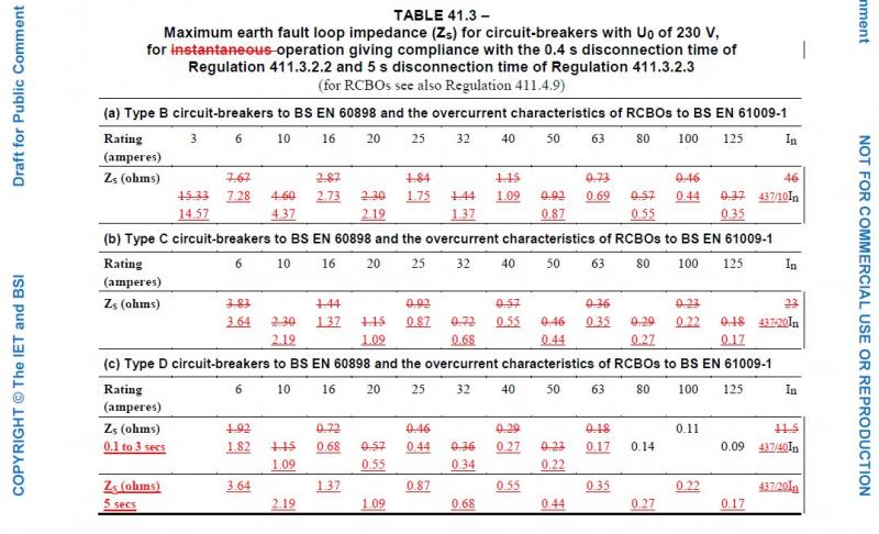

I'm not really bothered what figure we have to use as maximum Zs. ... However, I am slightly irked by the methods being employed. ... Why are new tables not just issued which apply this new nominal voltage? ... Will there be ANY occasions when this new method will not be necessary? ... So, we look in the table at the maximum Zs for a device and reduce it to 76% of this so-called maximum which now can never be used.
I don't really understand your point. As I illustrated in an example Table from the DPC, the proposal IS to 'issue' (put into BS7671) new tables which indicate the maximum Zs that will (with the proposed new method of calculation) ensure compliant disconnection times. If/when those 'new tables' appear in BS7671, the OSG will presumably eventually follow with corresponding changes in its Tables.
Ah. Sorry. ... I thought there was just going to be a correction factor (Cmin) which would always have to be applied.
Oh, no - they propose to 'issue new tables'. If you recall:
The corresponding OSG Zs figures will, of course, (if/when changed) be lower than these by a factor of 1.24, since the OSG gives maximum Zs at 10°C, whereas BS7671 gives figures at 'normal operating temperature' (commonly 70°C).

Moving back ‘on topic’, but taking on board the intervening discussion, it seemed appropriate to look at the impact of next year’s proposed changes to maximum permissible Zs values (for ADS) on the fault protection of conductors which are undersized’ (in relation to the In of the OPD protecting them). In the below, I have modified the maximum Zs figures to reflect the current proposal of ‘Cmin’=0.95 (i.e. calculating maximum Zs at a supply voltage of 218.5V). If the authors of BS7671 were to accept my suggestion that Cmin should really be 0.94 (i.e. calculating at 216.2V, the minimum permitted supply voltage), these Zs figures would reduce slightly.
It also occurs to me that if we are (I would say reasonably) moving to calculation of the maximum Zs which will still give adequate disconnection times at (or near!) the lowest permitted supply voltage, to be equally conservative (i.e. considering the ‘worst case’), I really ought to use the maximum permitted supply voltage (253V) to calculate the minimum Zs required to give adequate fault protection to the ‘undersized’ cable (per adiabatic calculation). I have therefore added such figures to my tabulation.
As can be seen, the combination of those two ‘conservative’ changes means that it is (just) effectively no longer possible for a 1mm² or 1.5mm² T+E cable to have adequate fault protection when protected by a B50 MCB, since the minimum Zs to achieve this for the CPC now coincides (at 0.70 Ω) with the maximum Zs for satisfying ADS requirements (disconnection times). Similarly, all the ‘Zs windows’ for an undersized’ cable having adequate fault protection get appreciably narrower - for example a 1mm² or 1.5mm² T+E cable protected by a B40 would have adequate fault protection if Zs were between 0.70Ω and 0.88Ω.
