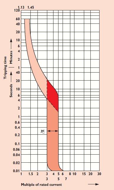

I presume the Hager curves are correct for Hager devices; others probably different. Perhaps that is why, for the problem being discussed, there are no standard charts and advice is given to contact the manufacturer's figures.
I rather doubt that they are Hager-specific. Although I don't have access to verify it, I think they are very probably BS EN 60898 curves. If they were empirically-derived curves based on their own devices, it's almost inconceivable that they would get exactly the range of Ia values that is required by the Standard (e.g. 3*In - 5*In for Type Bs)
What text is associated with the IET curve chart you gave? I suspect it is formed from the calculations.
No, the text is unhelpful. The graph exists in the context of illustrating the graphical (rather than calculation) method of examining CPC adiabatics - with the 'conductor adiabatic curves' (the dotted straight lines) superimposed on the "operating characteristics of a Type D MCB".

I'm going to have a look around and see what other MCB curves I can find.
Well, I don't know :) ...
This one from Wylex looks very similar, certainly 'down the bottom', to the Hager ones (goodness only knows what the "ac~" is all about!):
... but what about this one, from the same page of Wylex!!....
... and this offering from MK ...
I cannot help by wonder whether the latter two are to some extent theoretical/hypothetical, since they appear to be showing curves going down to disconnection times which I would have thought were less than any ('cheap') physical mechanism could achieve.
Kind Regards, John
