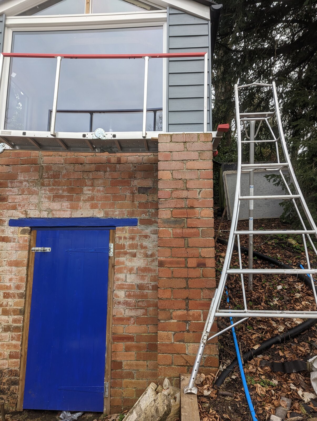

Remedying vertical crack in unused chimney
9 Jan 2020
837
29

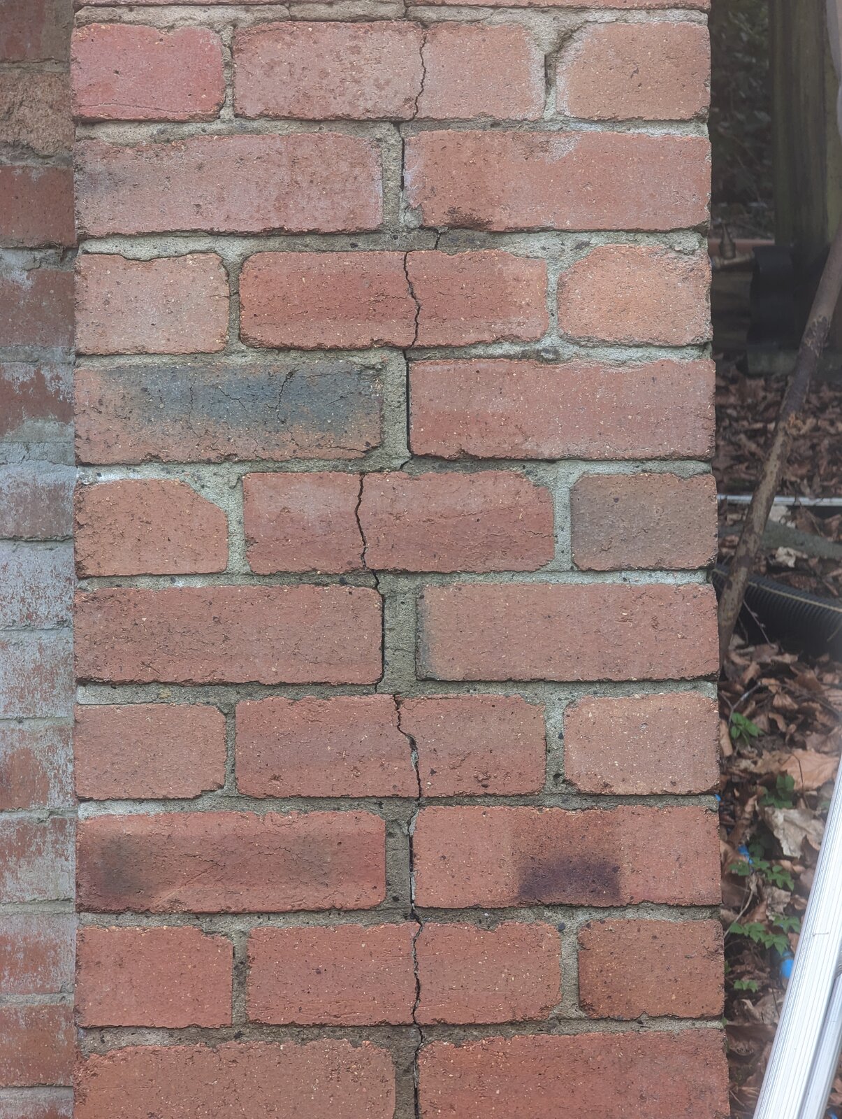

This is a former Victorian hot house, now being converted as a garden room. We've already reduced the chimney to about half height but I've noticed a crack running up the remainder. It doesn't reach the top or bottom for now and isn't actually functional, but I'd like to stop it getting worse
The pointing is obviously ready to fix but what do you do with cracked bricks? The crack seems too narrow to get mortar in.
The chimney is tied in to the wall so I don't really want to take it down as it will look naff, if it can be protected?
I do plan to cap the top but this crack was there already.
You could drive those helical bars through to tie in the bricks but the underlying cause - which appears to be subsidence from tree roots, will remain.

Thanks, I hadn't heard of those before, assume this sort of thing is what you mean - they self drill and provide reinforcement? https://www.toolstation.com/brickfix-helical-bar/p58328
It may well be subsidence although there doesn't seem much vertical displacement and the crack starts partway up, so I'd assumed it was just old age. But if I stabilise, I would still want to fill cracks to stop water getting in and causing problems I assume? Is grout the product I want here, basically to use as filler on cracked bricks? Searching for the helical bars showed up "brick fix" kits including them and a bucket of special grout. But are these cracks wide enough for that?

Have you got any spare cedral to clad it with? Probably quite difficult to make a "mortar" repair that won't crack again.

Yes something like that
