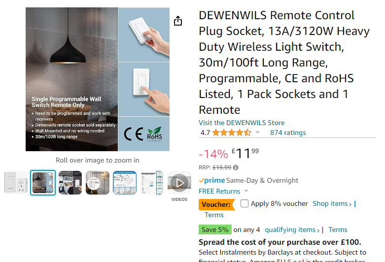

Hi,
In a new extension, I want to have several Floor and Table lamps but to control them all from wall switches at the same point as the Ceiling lights.
[i.e. I don't want to use a separate, Remote Controller, that will no-doubt be misplaced].
I'm not saying they need to be switches precisely with the Ceiling lights (they'd be on totally different circuits), but at least I want the switches co-located (i.e. right next door to one another).
I'd also (ideally) like quite a bit of flexibility, so that I've a switch for turning all the Floor lamps on in a single go, or I can switch some on/off at a time. Also, ideally, some may need to be dimmable.
Again, I do not want to do this from a separate 'Remote Controller', or from my phone! I want to do it from (albeit separate) wall-mounted switches.
I appreciate that this may mean a large bank of switches on the wall, but I'm happy with that.
Cost is also a significant factor.
Can anyone suggest a suitable solution or products?
I'm not sure if Bluetooth-based technology would have the required range (4-5m max from the Floor lamps to the (proposed) Wall-Mounted Switches?
Are there Ultra-sound based technologies?
Or would it have to be WiFi-based technology stuff? I'm guess that's a lot more expensive.
Thanks in anticipation,
Ezio
Something like this, but this switch only controls a single Power Socket.

2A round pin sockets at the lamp positions.
The same number of switches/dimmers on the wall.
No need for any Bluetooth, Wi-Fi, apps, smartphones, AI powered spyware or anything else.
As flameport says 2a sockets in the room switched by a switch or dimmer in the same switch plate as the main light. Its what I have done. Two ccts fed from separate switches feeding three sockets per cct dotted around the room so giving the chance to move a light to different position but still have it switched from the same switch. Simples...

I will admit using the phone is a pain, but I do have remote controls Remote control.jpgfor some of my lights and sockets, they work direct, and don't need the internet or router. I have used them for bedroom lights for years, first installed in late mothers house. Easier that setting up two way switching.
One can combine the two using relays, DSC_6061r.jpg I have used relay shown with landing light, mainly as the down stairs switch is not in a convenient place, so I can use voice, phone or the existing two way switches.
However I will admit not all plain sailing, of the 5 energenie light switches, only 2 remain, this is over around 7 years in total, they were great to start with, but any switch without a neutral needs to pass current through the bulb when off to power the switch unless it has a battery, so it depends on the bulb as to how well they work, I have found one switch TPLink (Tapo) that does use a battery, far better idea where there is no neutral, and up to now work well.
