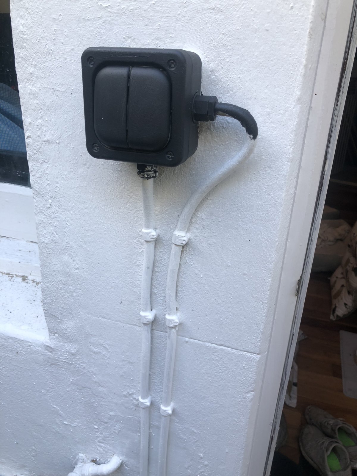

Hi all,
I have two outside light circuits, see attached photo of the switch. I want to remove one, is it simply a case of unbolting and removing the wire from the box, or should I be doing something else also? I haven’t touched outside electrics previously.
Many thanks.
I presume you mean you have two outside lights - which are likely to be on the one circuit.
Just disconnect the light you don't want and also disconnect the other end of that cable and remove it.
Outside electrics do, indeed, work (electrically) the same as inside, but they come with 'water-tight' glands which are not usually found indoors, and I suspect the OP was asking about measured needed to maintain water resistance when he pulls one cable out of its gland.
Timotei: if that is your issue, you just need to find some plastic (or even wooden) rod roughly the same size as the cable you're removing, and then tighten the gland nut onto that. (my favourite for that is a bit of 'glue stick' - as in hot glue guns!_

Thanks John, nice hack with the glue stick!

There is also, of course, always the option of doing it properly.
