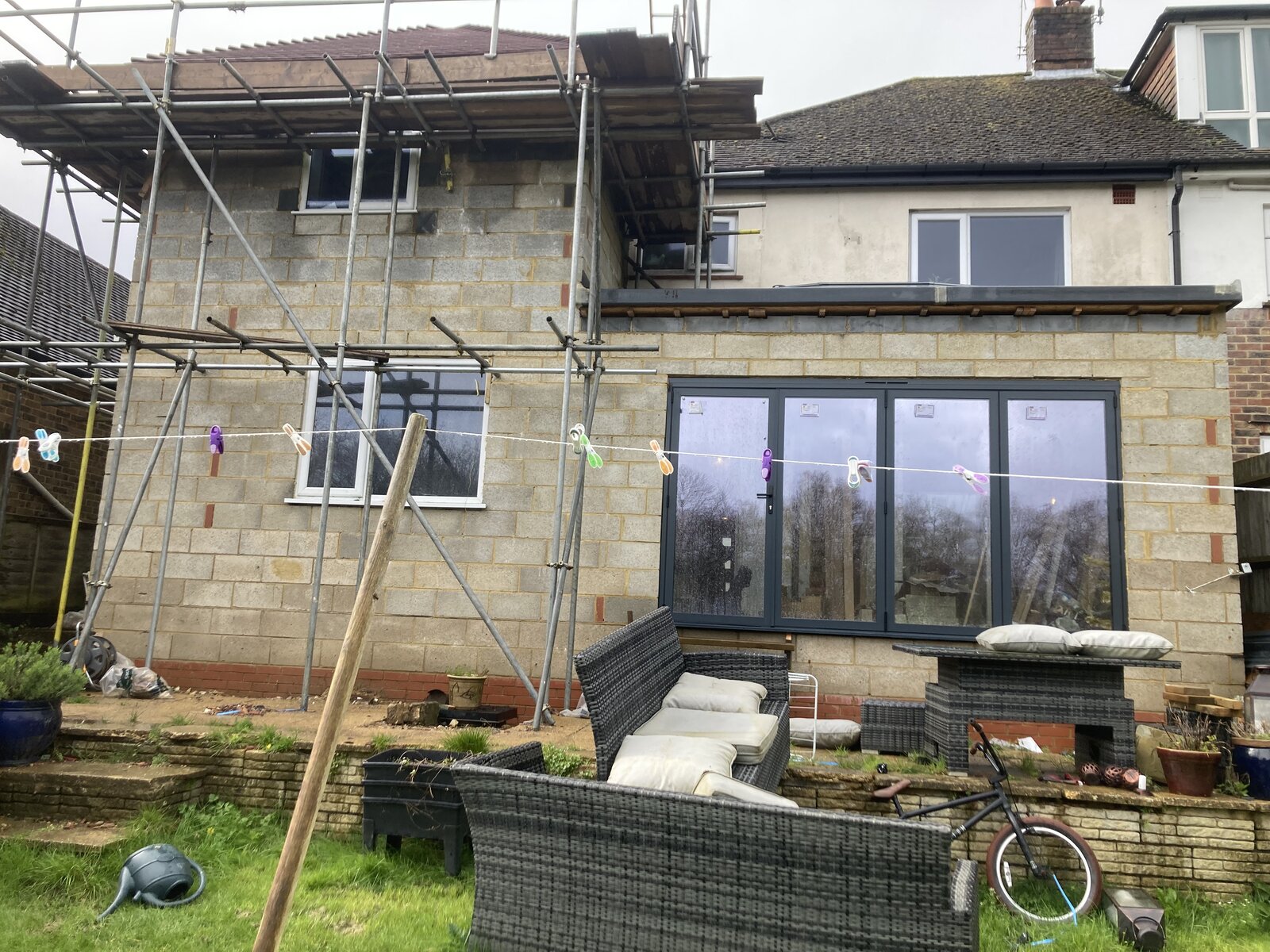

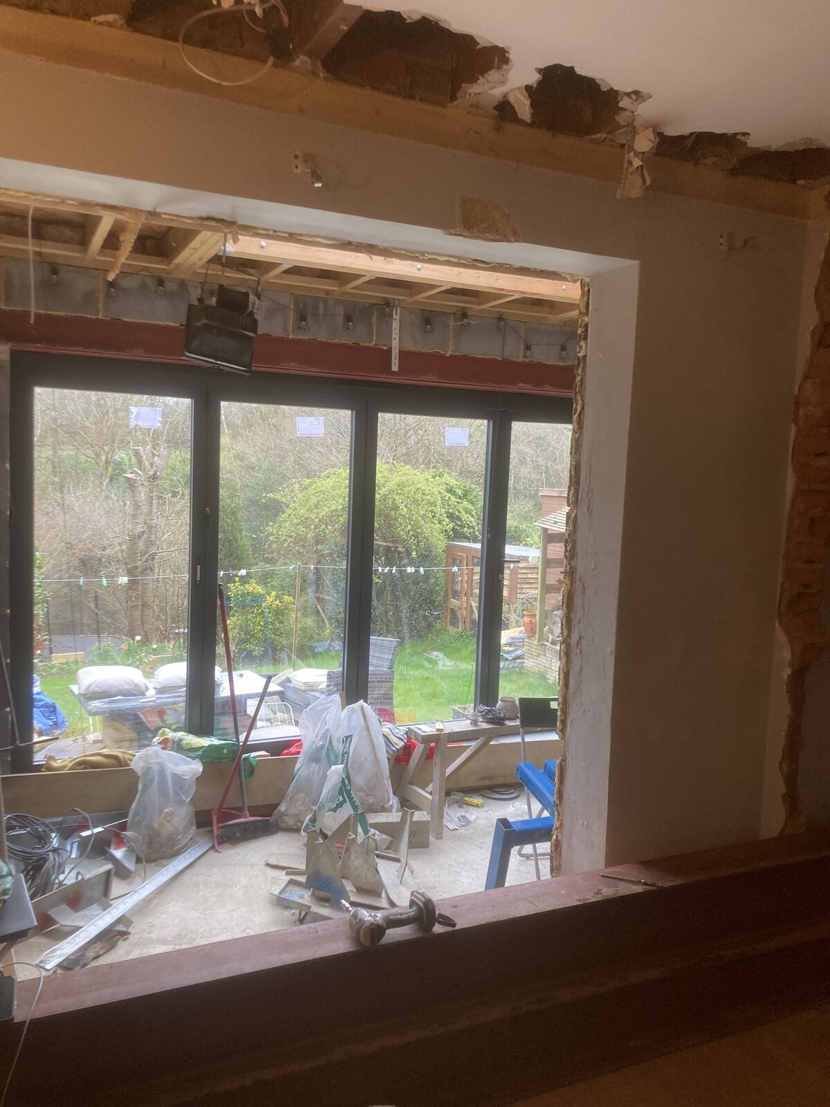

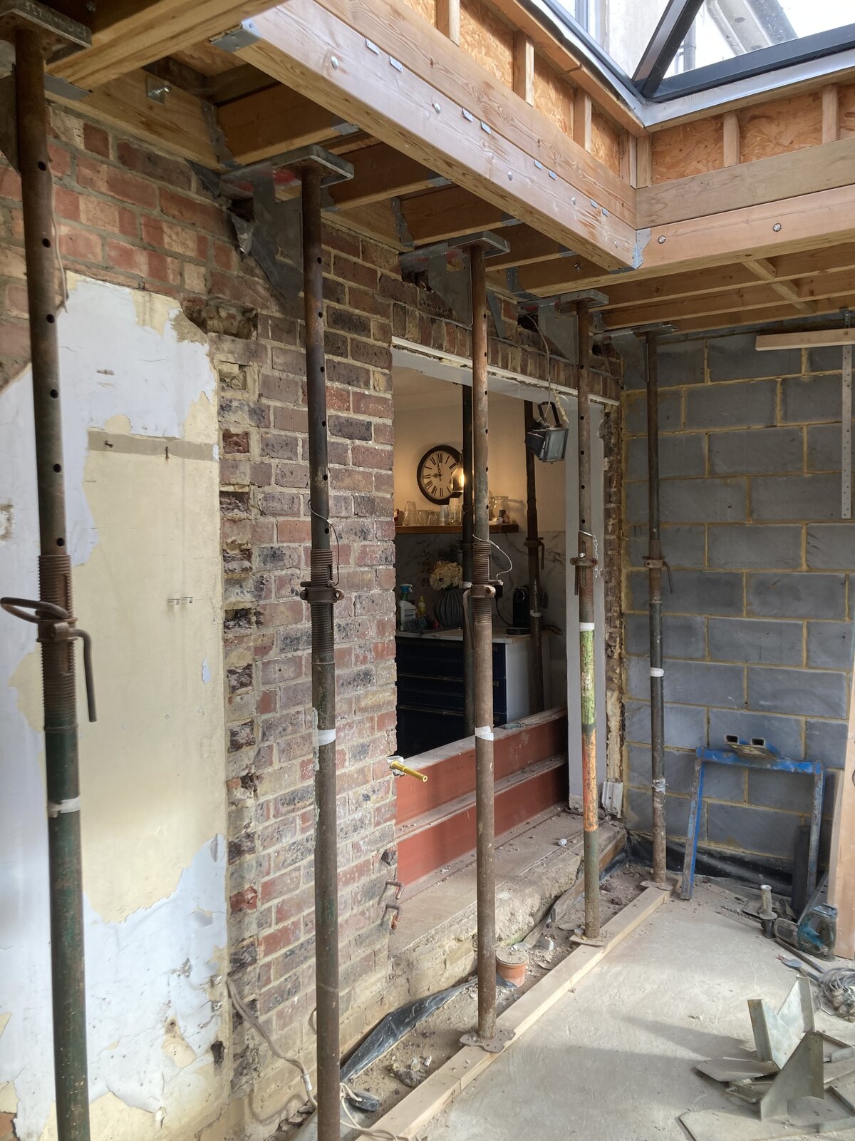

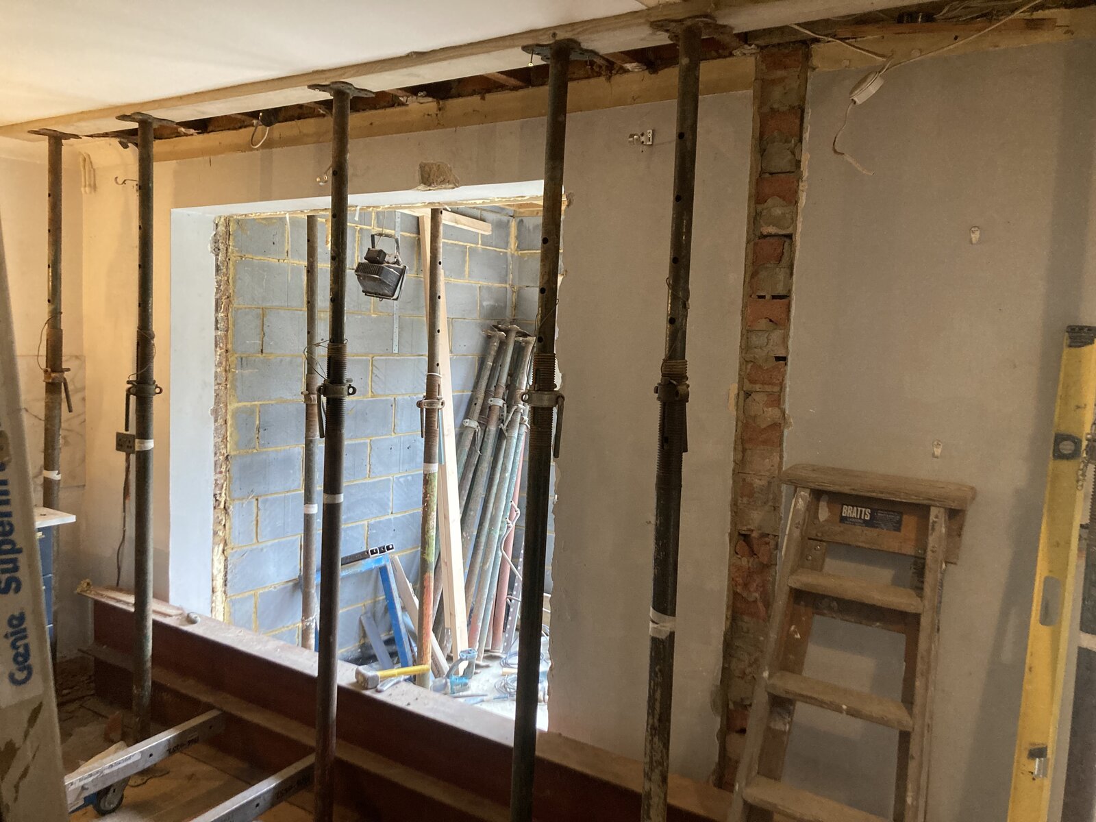

Here are some images from
Both side internally and also an image from the outside, showing the full extend of the extension. The wall being removed is the section behind the bifold doors, There is a bedroom & bathroom above. We have build all of the extension ourselves (foundations, brickwork, drainage, roof ect), have relevant planning permission & building control who has passed everything up till now. My partner is a builder (carpenter), but Im a naturally nervous person, and suppose Im just worried about removing this wall

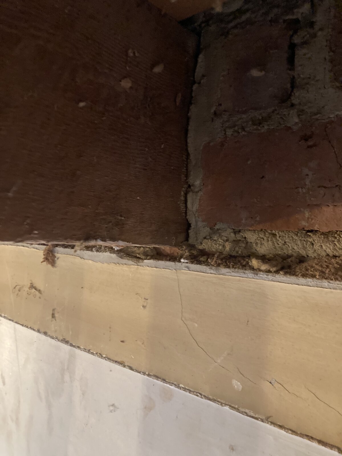

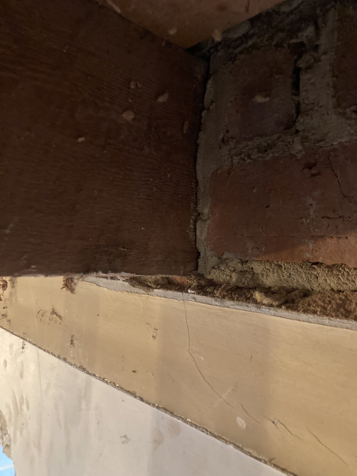

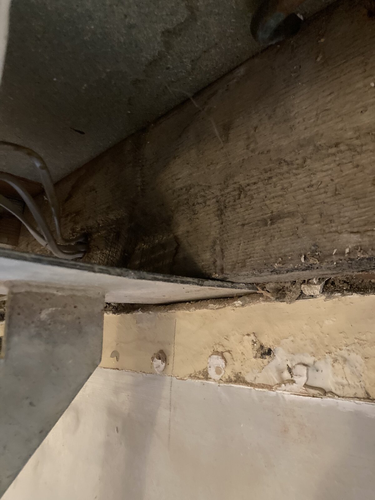

Can you take some more close up pics of the internal wall leaf please, near the tops of the acrows and where the floor joists meet the wall
Remember that the forum software downgrades their quality

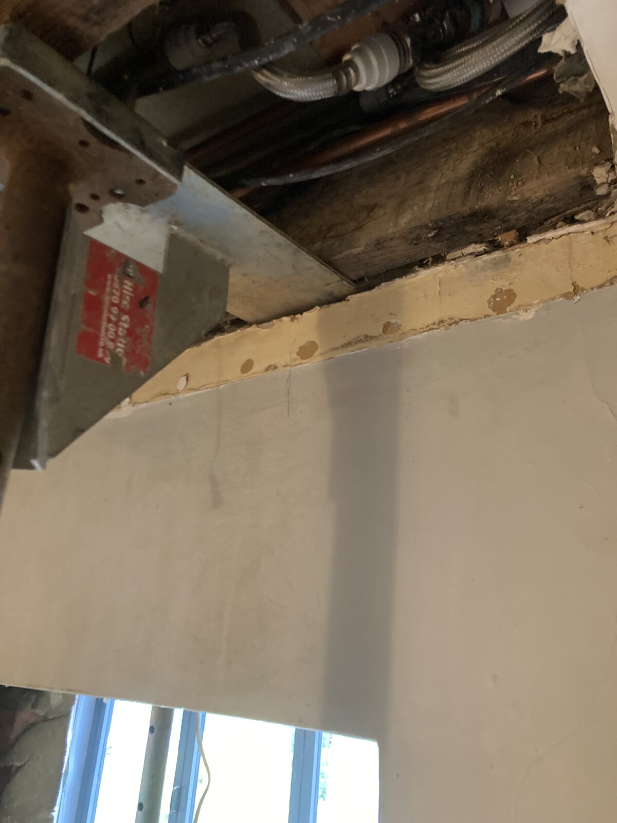

Yes & thank you :-) The span of the wall is 5.1m, 2m of this, the joist sits parallel with the wall (under the bathroom section), the other 3m the joists sits on the wall (under the bedroom). I have attached images of both. You can see the strongboys are in place - but not yet fully in the wall hence why there is still a gap between the strongboys and the wall.

Confusing. The zoomed in pic shows a strongboy but the zoomed out pic doesn't?
