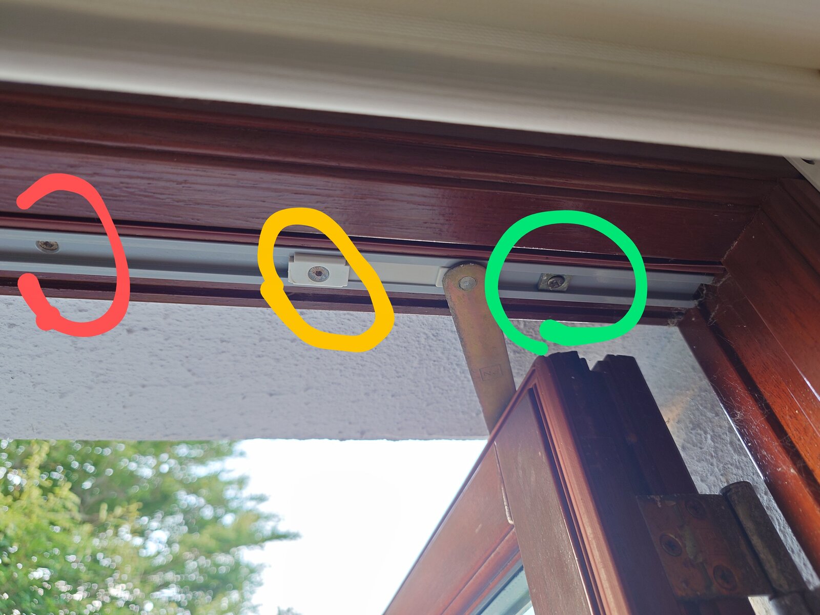

Thanks, can you tell me - do the side hinges look like they might lift off without having to unscrew ?

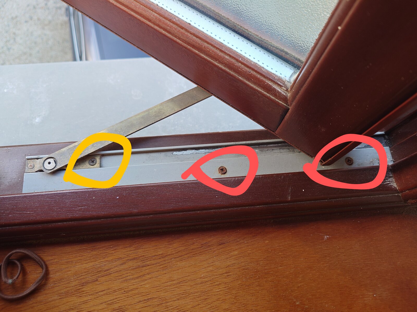

For for the windows with top and bottom sliding hinge only, how would I disconnect them ?
Nothing lifts off, they need unscrewing at the frame leaving the hinges on the casement, thats the opener
Thanks so in the photos attached which screws need to be removed ?

Ok thanks so essentially remove the piece as one.
Would you do it yourself or do you recommend leaving and painting it in place ?
Paint in place, if you remove to paint you'll have to wait till it dries before you can refit, can see it becoming very messy very quickly
