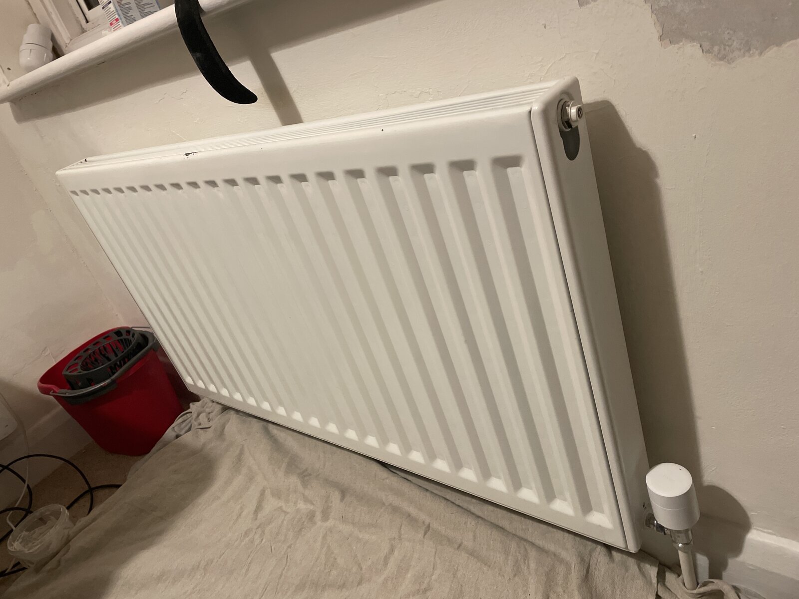

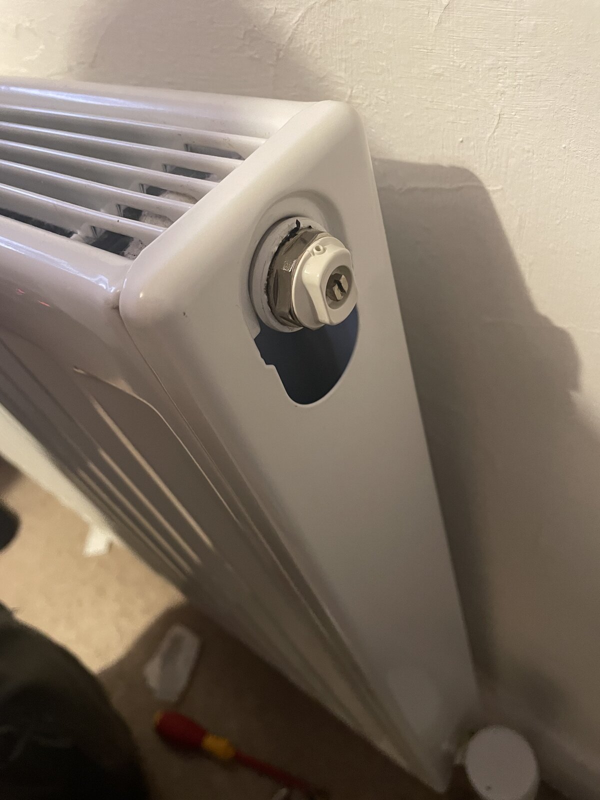

Hi, does anyone here know how to get this grill out of this Myson rad? I want to clean and paint it, and can not for the life of me find a way to get it out.
Ive watched a heap of vids and search here but nothing seems specific to this design.
Ive got the clips off and tried to raise the side panels up, or out, but they are not budging on either side.
Any suggestions?

A teeny whack with a hammer on a bit of wood on the edge of the covering (not rad) may help. Can't see from pic but the bottom tail may have a plastic insert in panel which can either be rotated so the cutout's in the correct place to allow the panel to lift or it may be gently leverable out with a screwdriver.
Take a pic of the bottom of the side panel where the valve is, some use a plastic clip that needs to be turned 180deg to release it and allow the side panel to be slid up and off.
Thanks for the responses.
I ended up removing the whole thing (need to paint behind anyway).
Still couldn’t budge it, so resorted to the hammer and piece of wood. The first split the pine I was using! Was stubborn but finally got it to shift.
Thanks again!
