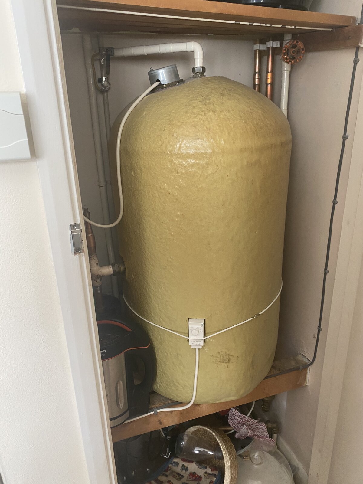

Hi All,
I’m doing a loft conversion to my bungalow and I need to remove the header tank to make the layout work. I have a 10 year old baxi combi boiler and hot water tank. The intention is to add one bathroom and two rooms with a rad each. Would it be feasible to simply fit a pump. I’m aiming to install a whole new system in a couple of years when I do a side extension.

The boiler is a Baxi Solo 18 HE, pretty sure it’s open vented. Not sure on the spec of the cylinder but I’ve added a picture, looks unvented. Not 100% sure on the header tank volume but based on its overall size I’d assume it is 500 litres. It serves the kitchen sink and one wash hand basin, that’s it.

That's a heat-only boiler. The cylinder is vented, so would be fed from a cold water storage tank (CWST) in the loft, holding something like 500 litre. The primary circuit (boiler and HW cylinder coil) could be pressurised, with an expansion vessel, or vented, with a header tank. Do you also have a small tank in the loft?

There is a second smaller tank up in the loft, located above the cylinder. Does this mean it is a vented and not pressurised.
If so, what solutions are available for removing the header tank without replacing the boiler? Is the installation of a pump a realistic option?
The smaller tank will be what's called the Feed & Expansion (F&E) tank and is needed for the central heating, yes it is an open vented system
The system can be converted to a sealed system and then the small tank can be removed. It should be a fully pumped system so should have a pump already fitted.

But unless he goes for a pressurised HW tank (quite a big change) he still has the CWST.
