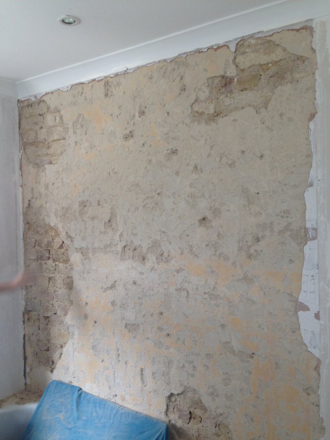

Hi, we just removed the tiles in our bathroom which we put up onto a newly plastered wall about 6 years ago. Problem is its taken the new plaster and old plaster/cement stuff away with it leaving bare brick work in places. The house was built in 1880 so the old plaster is crumbly and made with a weird mixture of sand and hair. We just want to tile in that location again so can we just get some cement/filer mix (not sure what you call it) and fill over the brick work bits and re tile? Or will it all have to be taken back to brick work and something else done? Lady novice here so any help/advice would be appreciated :) thanks

I'd say the wall needs a skim of bonding coat, then a skim of muilti finish plaster, then tile it. I've try and pull the rest of it off depending if it's pretty loose.
I agree it needs re-skimming. What you have there is a combination of bits that have fallen off, and bits that haven't fallen off *yet*.

Might be an opportune time to fit something like aqua board?
Basically a waterproof/resistant sheet product that would be nice and flat to tile on

.... and that folks is why you don't tile directly over 100year old lime plaster.
I'd take it back to brick and plaster/wet board then either tape and skim the joints or get a plasterer in.
when working with the existing plaster for god's sake wear a mask and goggles. 1 it can burn mixed with sweat and 2 there is all sort of nasty crap in the horse hair. it's fairly toxic
Get rid of the old muck then you can technically tile over the brickwork. Personally I would fit Hardibacker and then tile onto that.
