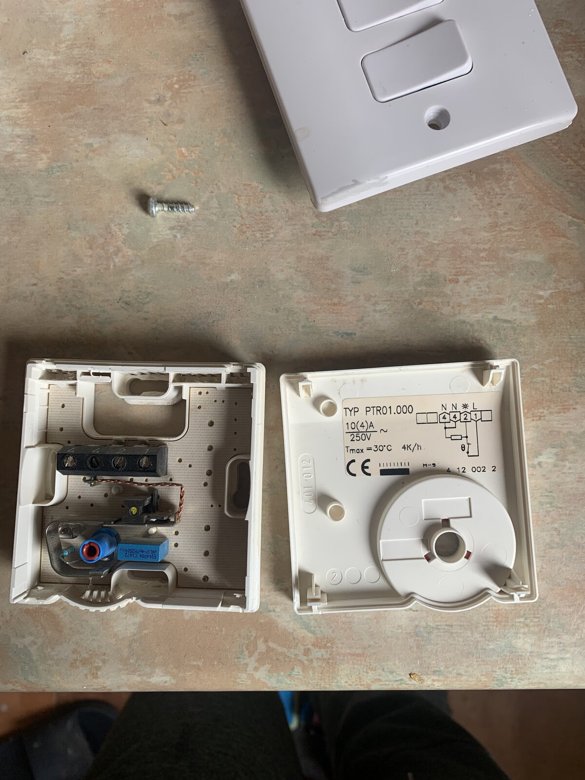

Wiring must have been via the potterton. Can you post photo of the removed pr2?

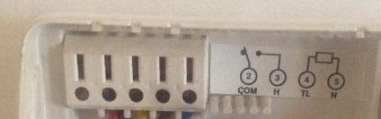

The wires that were in terminals 2 (COM) and 3 (H) should be electrically connected together to complete the circuit. The neutral in terminal 5 (if present) should be isolated and not connected to any of the other wires. Any link to terminal 4 (if present) can be discarded.
If you are leaving the old thermostat cable in place. The wires should be terminated in a visible junction box to indicate the presence of live wires in the surrounding area. Ideally the complete cable to the old thermostat should be disconnected and the link made at its origin instead, but it's not always straight forward for DIY.

Whatever colour the installer used, wiring colours mean nothing in a heating system, in @stem pic they are red and yellow, but that doesnt mean yours will be

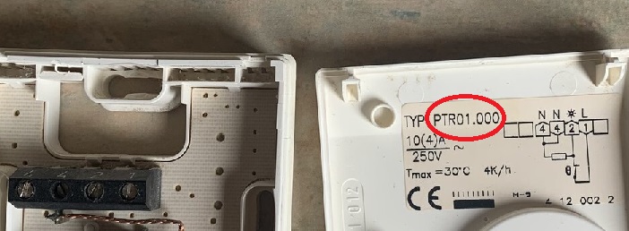

So for a PTR01
Link together the wires that were in terminals 1 & 2
Isolate the neutral wire that was in 4 (If fitted)
You mention removing the programmer, but I've assumed that you mean thermostat, as you must have already removed the programmer before you installed the Tado surely.
