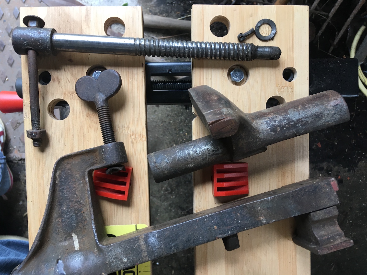

Removing a cotter (split) pin from an old vice?
Done! :) As @conny suggested, I managed to get a Dremel disc in there to cut it, then punched it through. Given it a quick going over with a wire disc drill bit, but think I'll need some small wire brushes to clean the inside as it's pretty gunky there.
