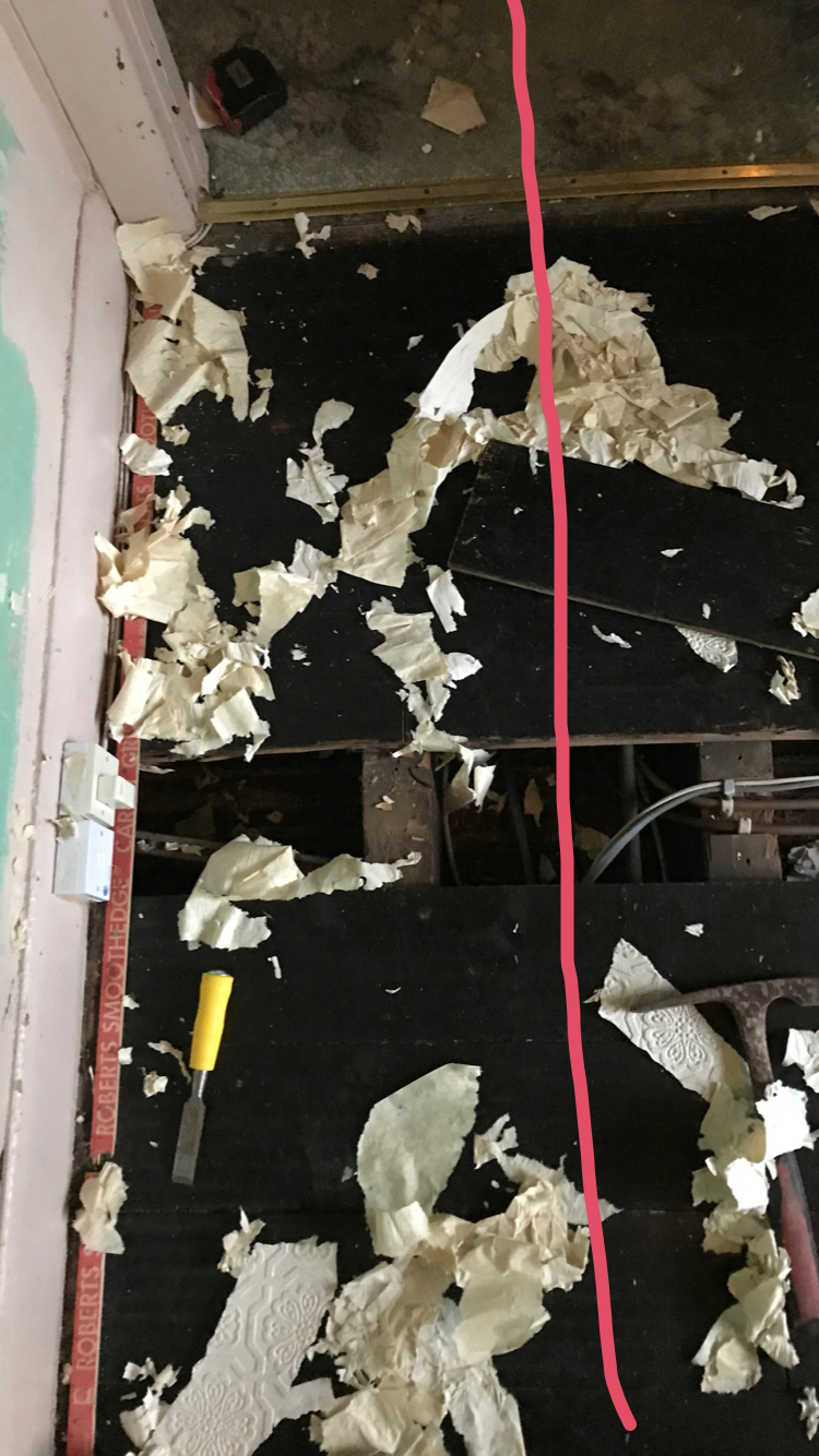

I lifted a floor board upstairs and the wall isn’t directly below a joist, it runs between 2 and just has the laths sat on it. It’s where this red line is:
Could this wall be giving the house some support more that what the floor joists give it?

now I look again, I see I was wrong about the joists, as they are parallel with the wall upstairs.
The wall is just on floorboards? Or is there a joist under it?

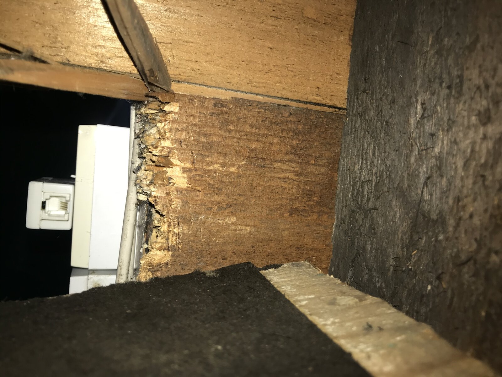

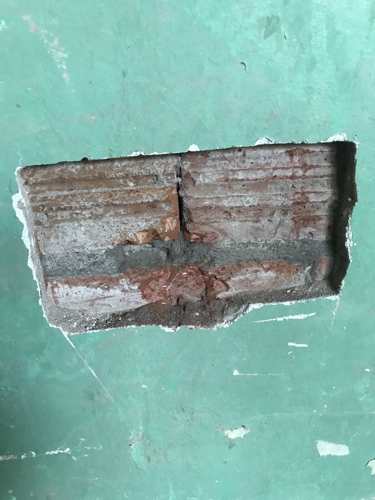

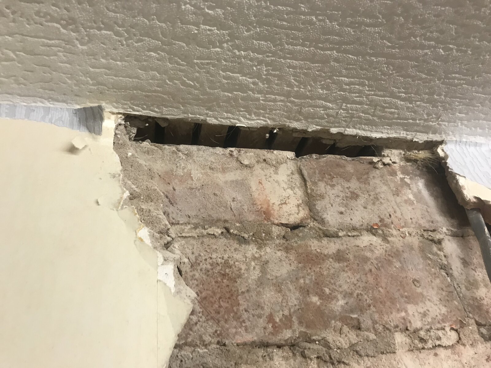

I couldn’t get in the loft to see the top of that wall, it’s wood at the bottom and feels like brick on top of that. I’m going to put a double back box on the wall tomorow so will be opening the plaster.

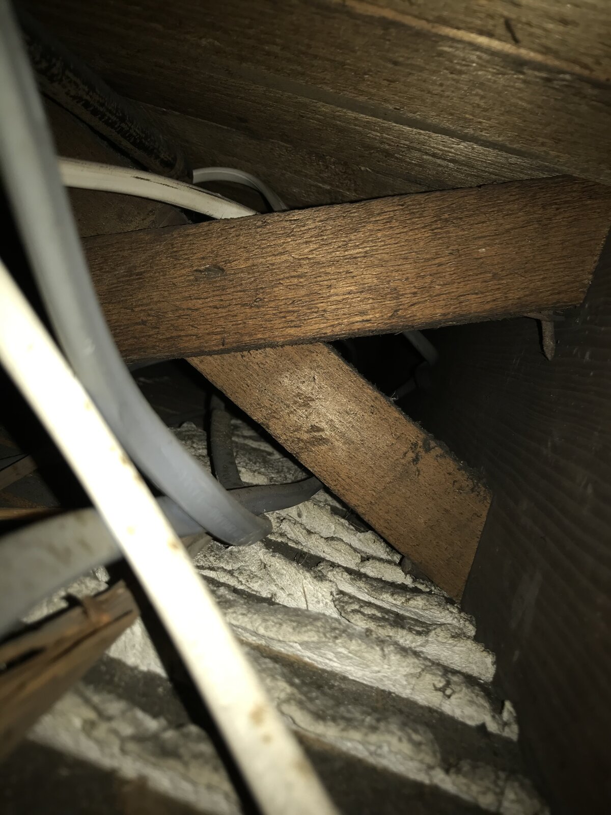

I can see down between the joists, above the downstairs wall, and there are herringbone type noggins between them but no full size timbers.
The upstairs wall is built off a timber that touches a joist but it’s not directly on it.
The downstairs wall that she want to get rid of, I assume it’s on a foundation. The living room floor is timber and the kitchen concrete.
I hate walls built off floorboards. You only need a plumber with his chainsaw to hack a few up, and the wall is supported by air.

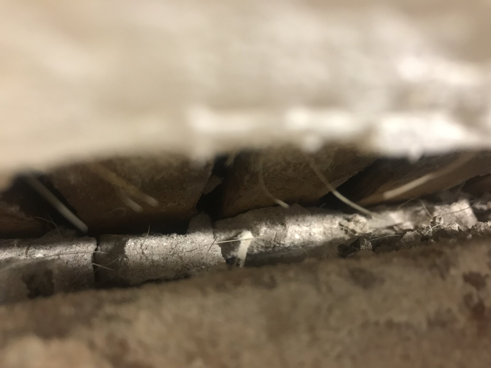

If it is studwork and L&P it will not be very heavy.
The wall upstairs is made of those hollow terracotta things that I would call cinderblocks and it’s just built up off the floorboards with about 10mm overlapping a joist below.
