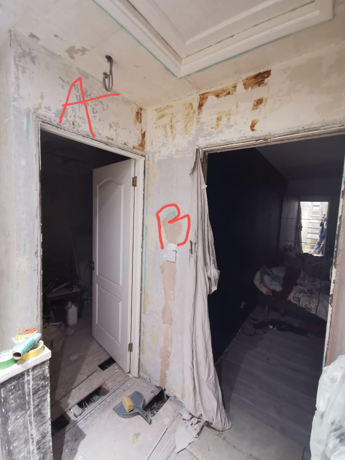

Hi,
Please can someone help? I wanted to remove 2 small walls shown in the picture. One of them has a doorway (wall A) and the other (wall B) is joined to a load bearing wall at 90degrees. I only want to remove the part of wall B that is on the left and leave the door way.

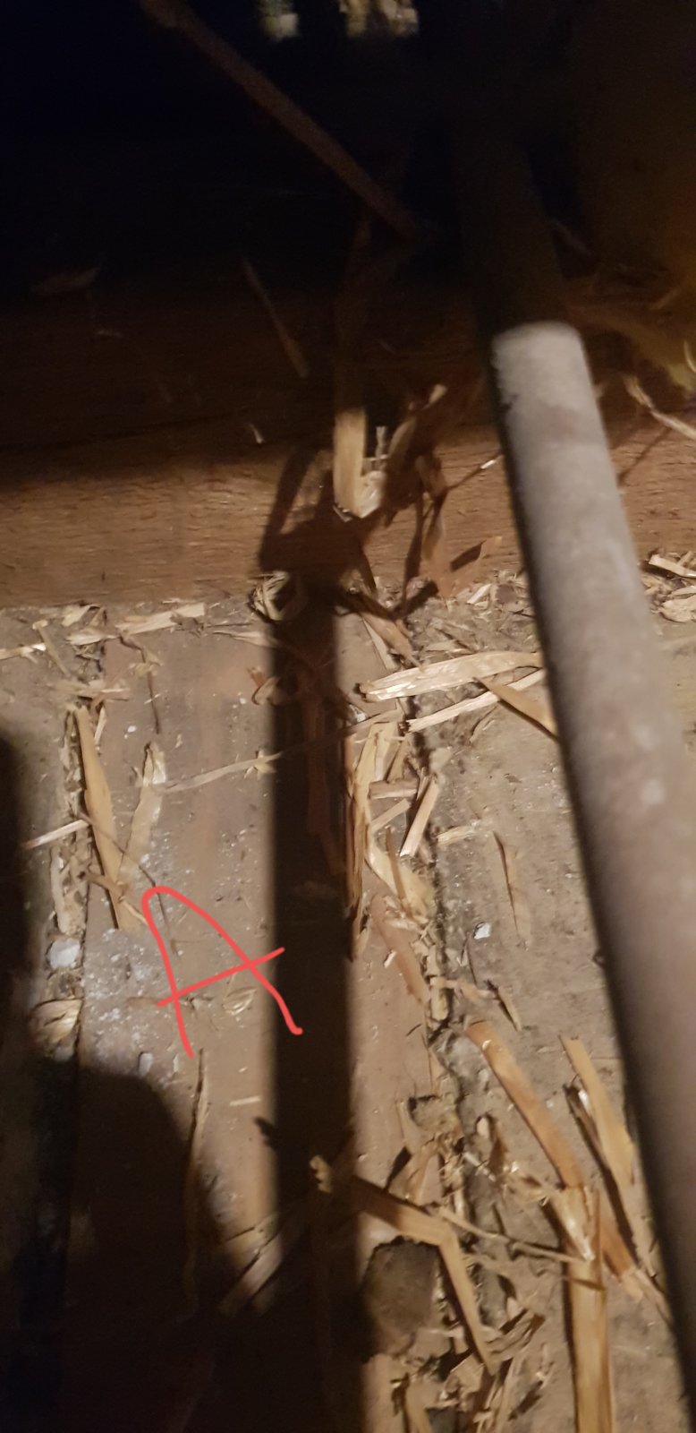

In the attic, wall A is perpendicular to the roof joists however there is a piece of wood on top of the masonry so the brick isnt visible at all as shown in the picture. There is a load bearing wall on the ground floor parallel to this wall on the first floor about 10cm away from the wall.

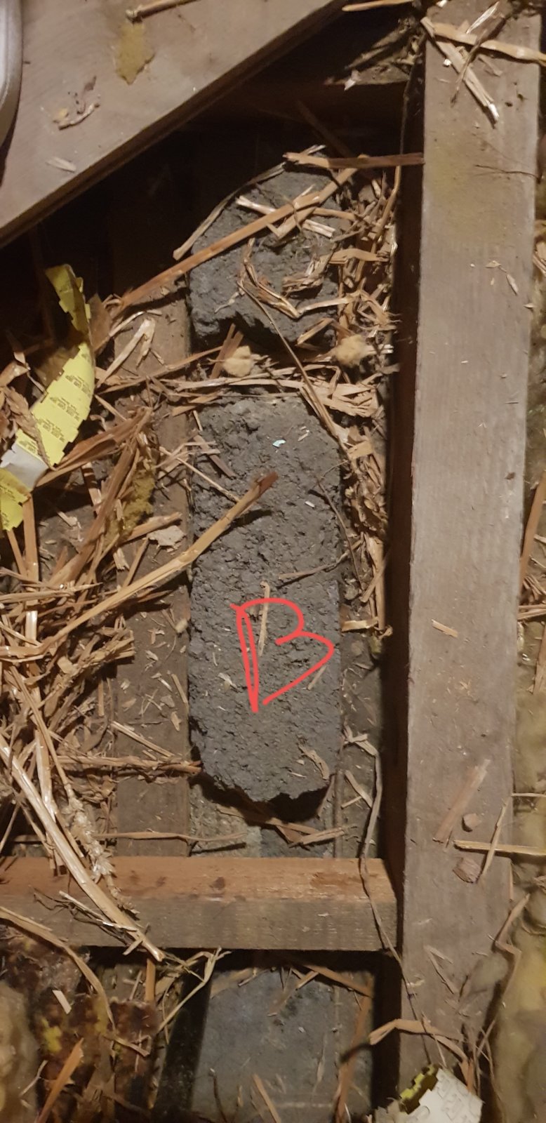

Wall B is resting on the floorboards with nothing directly underneath the floor boards. As I said, there is a wall joining on the right hand side that is load bearing. In the ceiling the bricks for wall B are visible but it doesnt look like anything is resting on it and it is parallel to the joist.

Hi, It's a 1950s house. We've had someone round today who seems to think B can be taken down but before A is taken down a joist hanger will be needed. I'm not sure what makes a top plate or wall plate, but @bobasd only wall A seems to have a top plate? The wood plate is only on top of wall A and doesnt extend any further

Is wall 'A' 100mm thick? The images shows the section of the wall above the door to be 3" partition? 'B' is deffo not load bearing. (only just seen the other images oops)
