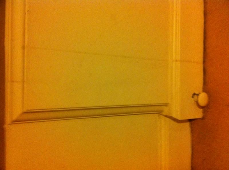

Don't know if anyone has removed one of these, But i have a 1930's house that has a heating system with invisible Radiators built into the walls. They are mainly recessed into the brickwork and plastered over with a single valve mounted in the skirting board. I believe the system is completely disconnected and empty of water (but not completely sure). We also have a more tradional working system probably installed in the 70's. I want to remove one of the old cast iron radiators which actually sits proud of the wall but is stiil plastered over to make a feature.....has anybody done this or can anyone offer any advice/tips etc...

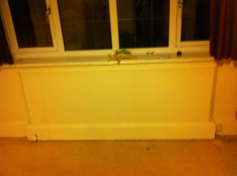

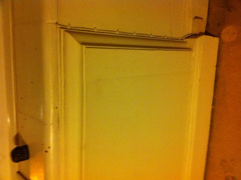

Images uploaded, I am a novice to this website so I hope this works? if not maybe you can review the album I created? I only know of one other property that has this system so it must be unusual, can't image that it was very efficient either as the heat would have to pass through plaster......
Thaks for posting them, is that 'panel' made of plaster? that must be the warmest window in the UK!!!!!

Thanks John, I managed to remove it at the weekend with help from a friend...to answer your question, It's actually a complete cast iron panel made to look like plaster moulding with water veins on the inside. The steel pipework is mounted inside the Walls and if you look at the photo you can see the Bakerlite valve mounted in the skirting board. Wasn't actually that hard to remove in the end, just very very heavy.....once we had the skirting board off we could see that it was supported on a wooden frame attached to a lintel under the floor boards. The whole thing was attached by two cast brackets to very large stud in the wall. unfortunately we managed to damage it by removing it so it won't be propping up in a reclamation yard, but it's still a bit of interesting 1930's central heating history that never caught on.....just relieved it came out really. Thanks again for your interest....
