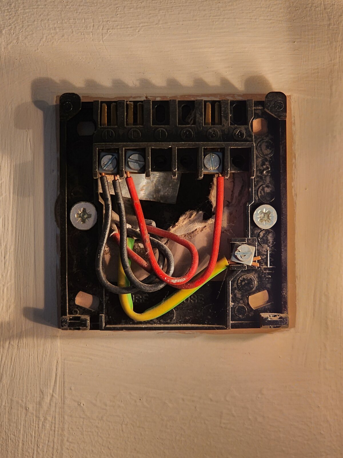

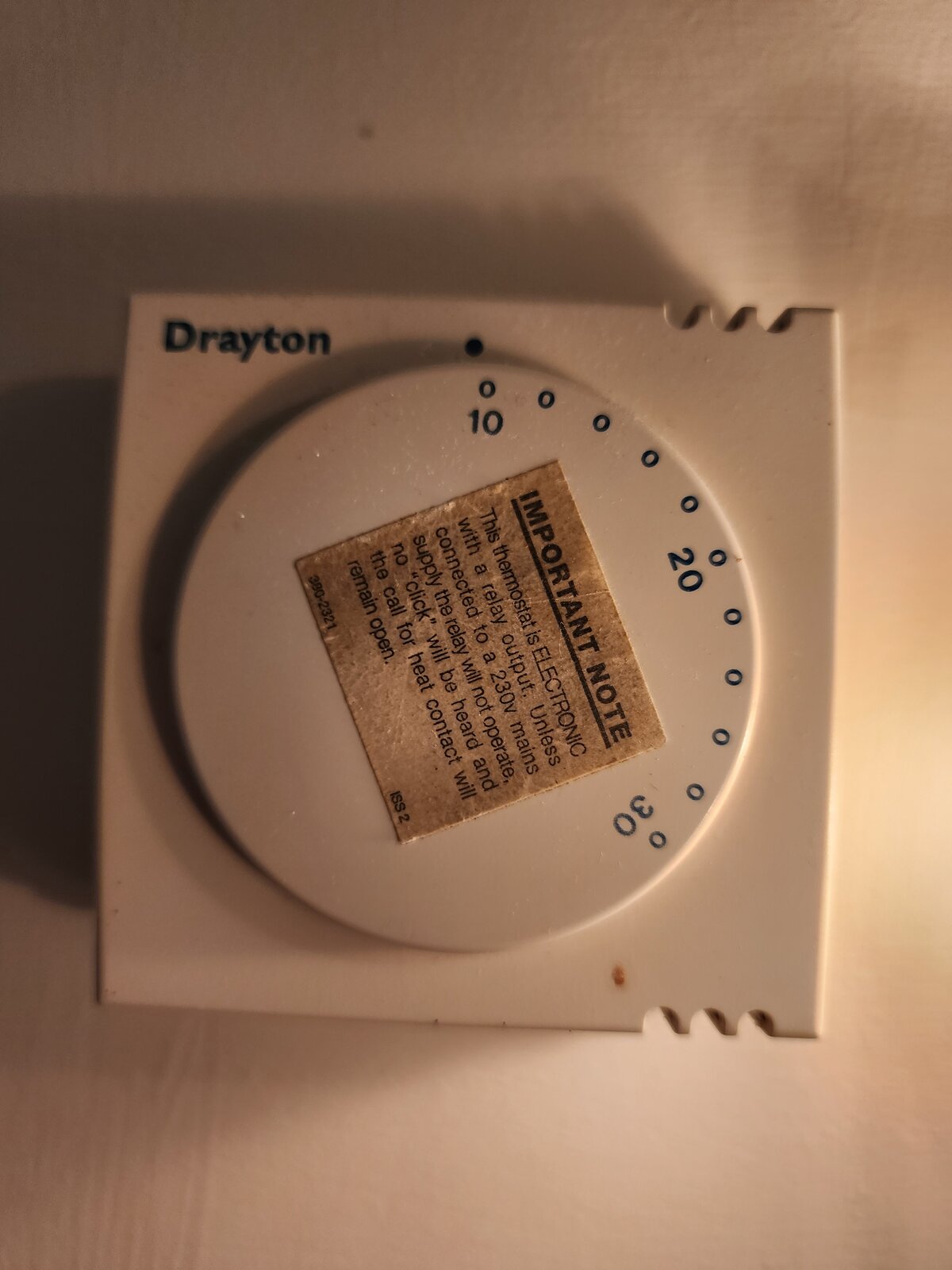

Hi I'd like to remove an old Drayton thermostat in my lounge and plaster over where it used to be. My combi boiler was replaced 6 years ago with an Ideal combi boiler and a new thermostat installed in the kitchen. The Drayton thermostat no longer works. It looks like this. Any help is appreciated. Thankyou in advance.

Any tips on how to do that cross thread? It doesn't work and I checked it with an electricians screwdriver and no electricity running through it. It may be connected somewhere. Thanks lots

An electrician’s screwdriver as you call it isn’t a suitable device for proving dead. Hse GS38 gives guidance on what is required, but a 2 pole voltage indicator is common practice.
So, it's not acceptable to turn off the electricity, dead end all wires with insulating tape and pop them behind the wall to plaster over the hole where the thermostat was? Thanks all
I don't see why not. The wire to it must have been disconnected at the boiler end, and the new stat connected in its place.
No, if it is still connected somehow then that is an accident waiting to happen.
Not necessarily, I’ve been to plenty where the old thermostat has been left connected at the fcu.
Thanks for your views. How do I check if it's still connected at the FCU? What's an FCU please? I want to stay safe
OK. Will try to do that. I'm assuming that'll be in the cupboard where the combi boiler is? Thanks for pointing me in the right direction guys
FCU = fused connection unit (people refer to them as a fused spur). If the last boiler was indeed a Combi boiler then the wiring should be there, but should be disconnected, or even cut back.
That seems a bit odd. Might end up with old stat firing the boiler. If that is the case he should disconnect it.
Odd, but it definitely happens. I attended one where someone had wired up the new boiler, existing stat was still connected somehow, and either the temperature dropped or someone turned the hard wired stat down and the boiler went off too.
Even odder that the boiler went off when the temperature dropped, I'd expect the boiler to go on. In the latter case, maybe the stats were wired in parallel, so boiler on when either or both calling. Perhaps that was the intention (though not an ideal arrangement).
