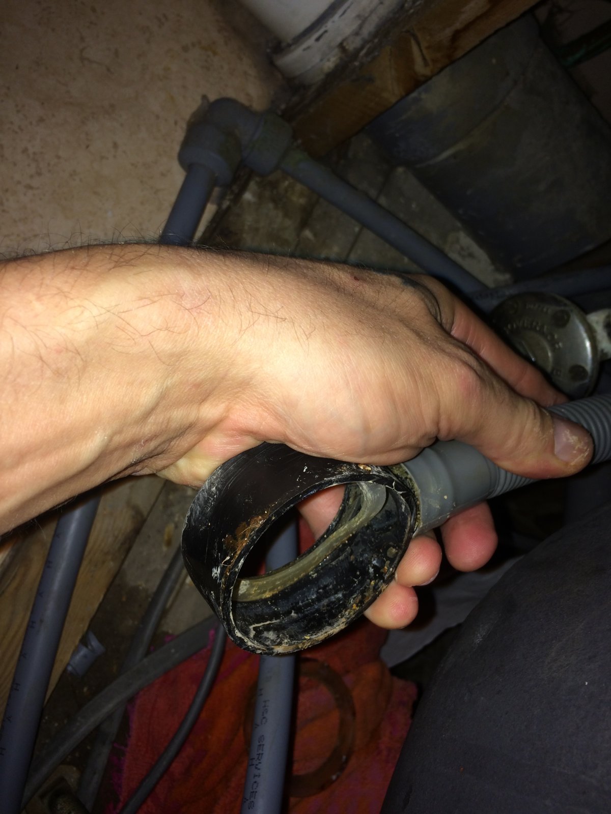

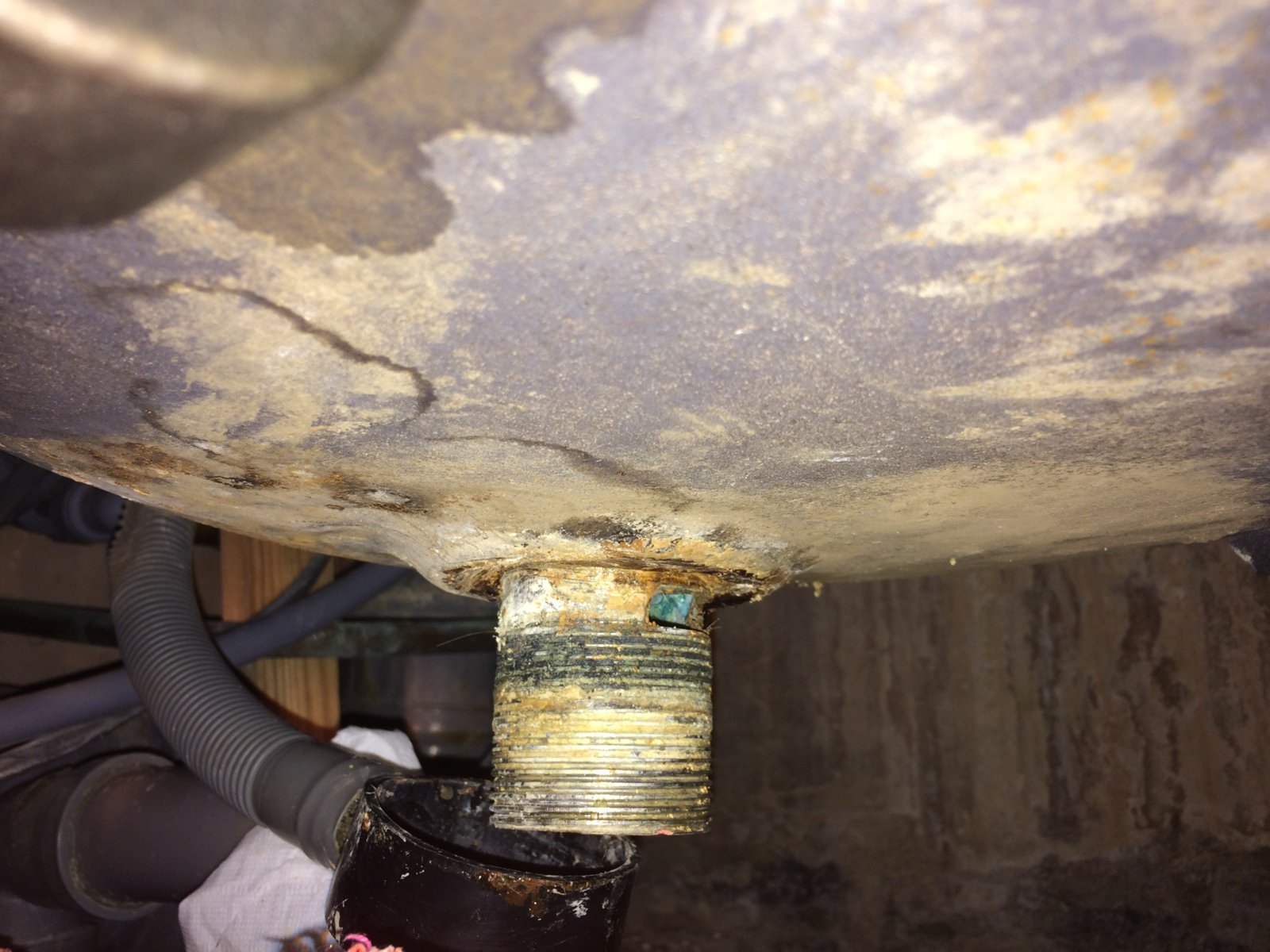

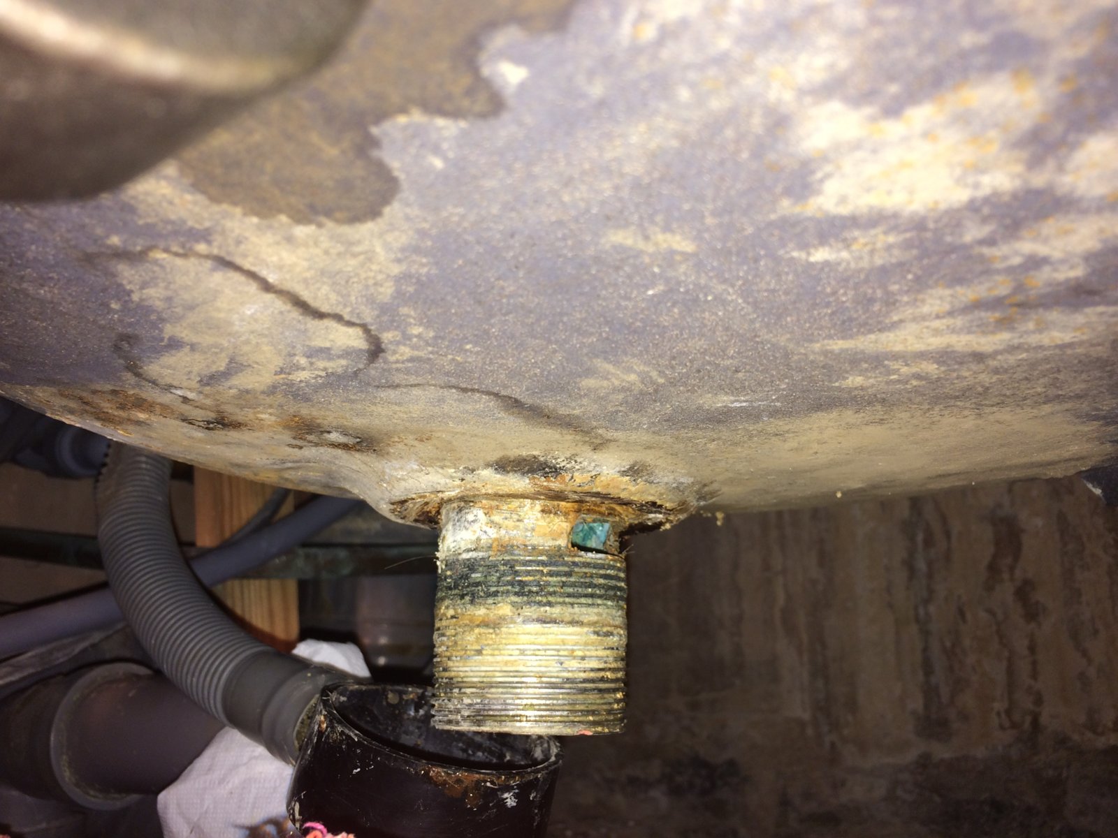

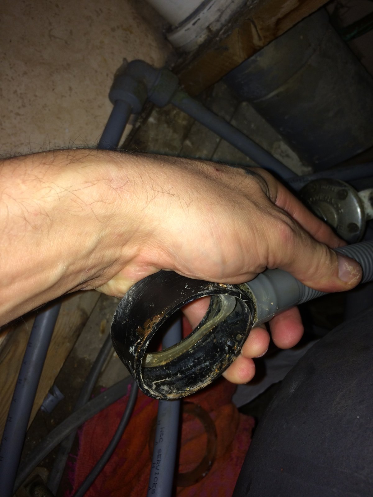

Waste was leaking on my old steel bath. When the bath was emptied water is getting out through the overflow holes in the waste and leaking down the thread. The connection between the overflow pipe and the bath waste thread was not good. I have no idea how the black plastic ring is supposed to seal again the top of the thread.
Everything is rusty mess. Makes sense to remove the waste completely and replace? I've never removed an old waste on and old bath before. Already tried to turn it anti clockwise from the top with pliers but they snapped. What is the correct way to remove the waste and what will be holding it on? I don't want to damage the bath and have to replace it.
Yes.
Clean off all old gunk thoroughly and use silicone on the top surface of the washer btween banjo and bath.
I would also use silicone on the underside of the chrome flange rather than the thin washer..
I'm not a plumber but any sink/basin/bath wastes I've encountered are placed loosely in from the top and held in place by the bottom nut. Perhaps yours has a sealant around the top which has hardened over time and stuck rock hard.
That's what's happened - try a screwdriver through both the slots then yank on it to turn/break the seal - yes, brute force;)
