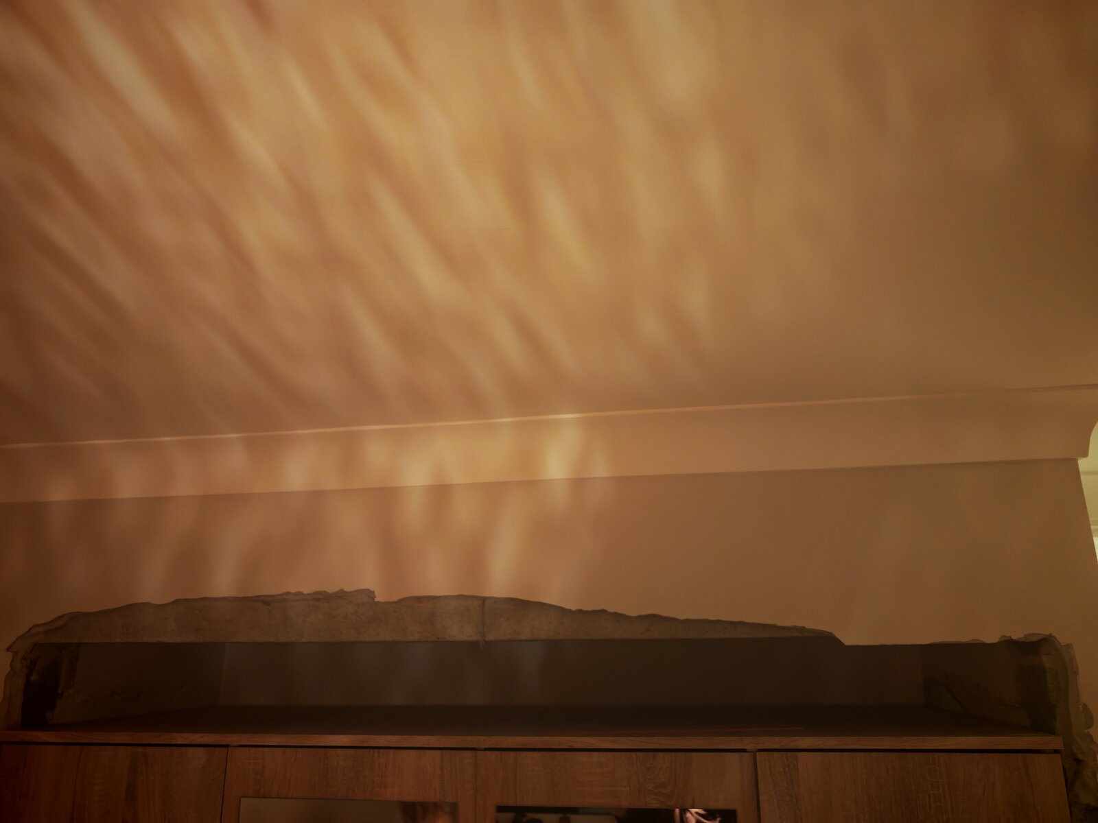

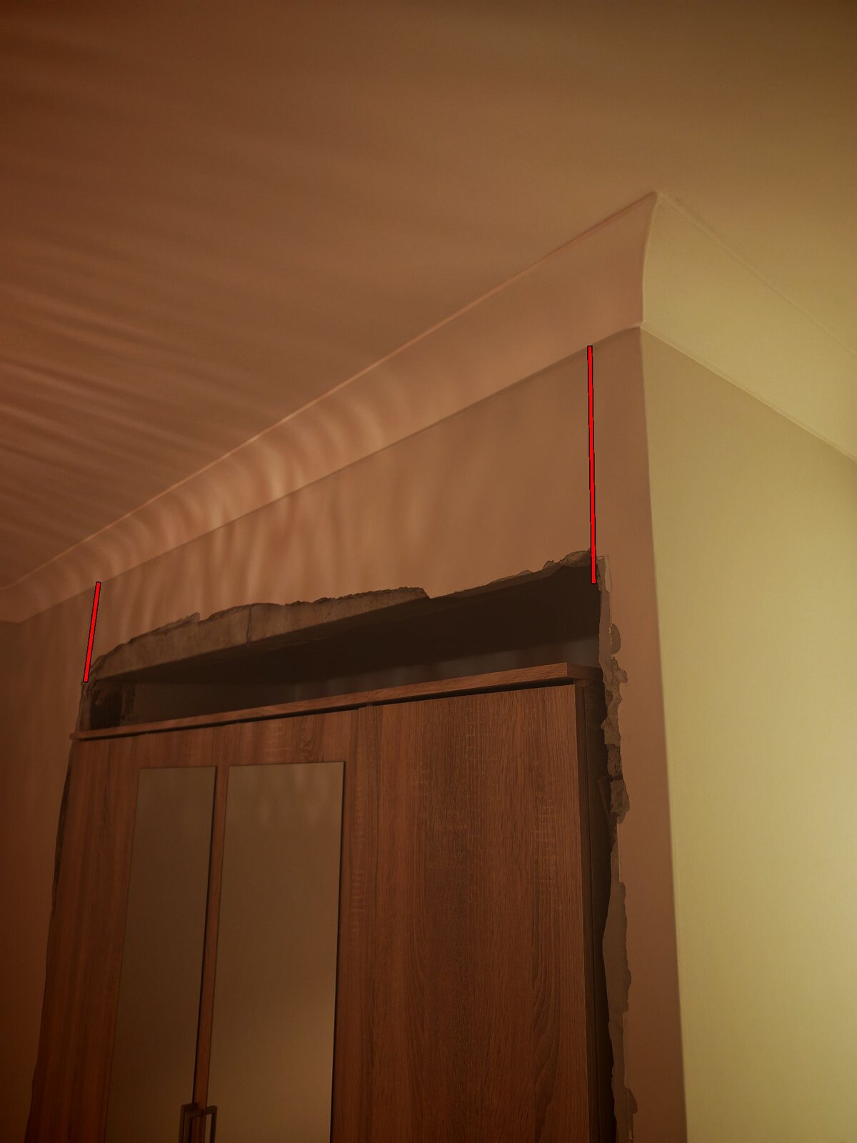

Hi,
I'd like to remove the lintel above the wardrobe and install fit in floor to ceiling sliding wardrobe. Can I tell if this lintel structural or not without hiring structural engineer to come have a look and write a £1000 bill for it.
It's a block apartment, concrete ceiling, block internal walls (can provide more information if that will help).

It's purpose built block of apartments (mine is at 4th floor) above is same layout so it's a wardrobe space
So it’s supporting the concrete floor of that space, right?
It's either that or it supports the blocks above the opening only.
Should I just treat it as structural wall because of the lintel?
I would think that an alcove for a built in wardrobe wouldn't be a structural wall, but that's just a guess.
But the concrete floor is resting on those blocks, surely?
The concrete floor/ceiling is all above, that doesn't mean all walls are supporting the above floor.
This apartment originally had a toilet next to the main bathroom separated by a block wall, and now the wall is not there and rooms are joined in to one. Surely it was not a structural wall supporting floor above.
Are you suggesting that there might be a small gap between the blocks and the ceiling, behind the coving?
Or are you just saying that maybe the floor above isn’t relying on this bit of support for its integrity?
If the latter - sorry, I think you’re going to have to get someone to survey it.
I'm sure there's no gap, but thinking that floor above is not relying on this wall. So seems like it needs to be surveyed.
