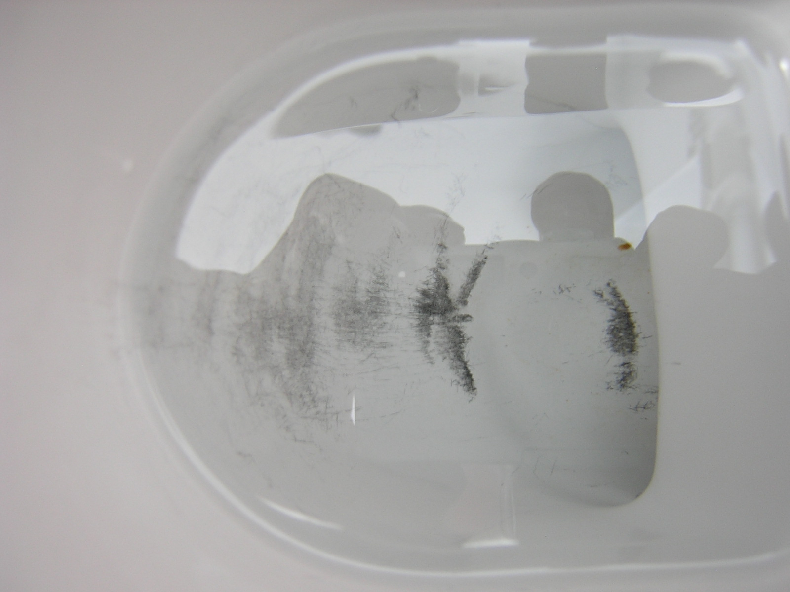

I had a blockage in my toilet - after trying various methods to clear it I finally invested in a 'drain snake'. This cleared the blockage - but I'm left with metal marks in the bowl from the spiral of the snake. Initially I thought it was grease but now I'm not so sure. I'm pretty sure it's not scratched. So far I've tried various ways to remove it with no success:
1. Kitchen pan scourer (one of those green abrasive pads) with a general purpose cleaner
2. Ordinary toilet bleach and toilet brush
3. Washing soda
Any suggestions please?
Before going to the expense of buying something I looked around to see what else I had in the house.
Viakal Ultra took it off, no problems.

No, Sunshine32. My toilet bowl isn't enamel - it's ceramic. The label warns about using it on old/damaged enamel but it's OK on ceramic. It even has a picture of a toilet bowl on the label
