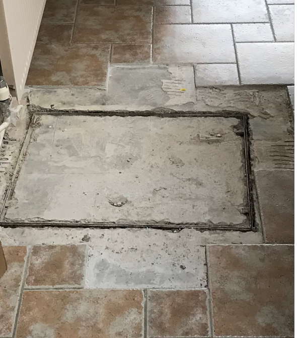

Is there another chamber you are aware of outside the garage, downstream? Possible the issue could be outside of that chamber, (drains are funny things and dont always behave as expected!) May be worth investigating, (personally would prefer to try from externally before internally!)
Also may be handy to keep an eye out to see what comes through if the blockage cant be shifted anywhere else and has to be attacked from the WC position.

If I came to your house and the toilet was out i’d try with my camera first. If you have a soft(ish) blockage I would hope to pass the camera through it then work it free with some water.

I've also spoken to the previous owner today and the manhole in the kitchen is just tiled over. The inspection hatch exists directly below and in his opinion It should easily be recoverable as he was mindful the floor may have to come up if a difficult problem manifested. Ive just ordered a grout removing bit for my oscillator so looks like I'll get that manhole accessible again.
I'm at the end of the run in a cul de sac. I'm the last house on the drain. It flows into my neighbors property through our garages. They also extended and the manhole is accessible but also in their kitchen. The elderly couple are shielding so I have zero chance of getting access. Its all elderly shielding people this end of my road. They all moved in sometime in the 80's and flogged the drainage and now moving our for the younger ones to repair. Lol.

An update. Dyno Plumbing turned up to replace the toilet, which is strange because I was pretty clear with the blocked drainage part of my written explanation to them. So Dyno Rod didn't turn up. I then decided to make good use of my time and started to uncover the hidden manhole in the kitchen.
It took bloody ages carefully uncovering it from tile cement, then to release the securing screws and crack the cover ready to be lifted out. New manhole arriving tomorrow so I'll get it level with the tiled floor and have it accessible.
I then had a knock at the door at 16:00 today and nice plumber was clearing a sewer, three doors down, and asked me to run the water to see if its a shared sewer. I then went to the problematic toilet flushed and it drained perfectly. Lol. Apparently the sewer in the neighbor's property was fully blocked and backed up. That will be the multiple 20litre bucket of water I've been shoving down the system. They had roots in the sewer which was snagging paper. They are reporting to Thames Water as its a shared sewer.
Thanks for all the advice. This is a great site made by all of you who contribute great ideas and challenge.
I thought id share a pic of the uncovered manhole. no point showing it when its lifted because it will be a standard clean sewer which I'm sure you've all see many times

Always worth contacting the water company before you do anything else. Worse case scenario, they'll tell you it's private and either offer to unblock it for a fee, or pass it back to you to engage someone yourself. Afraid I have to wonder if the company who were due to attend would have been that honest.
As its a shared sewer, the Thames will have responsibility from the point it either becomes shared, or passes under the boundary. If you have root ingress, then may need a root cutter sending through the pipework, and possibly lining once clear to prevent a recurrence.
