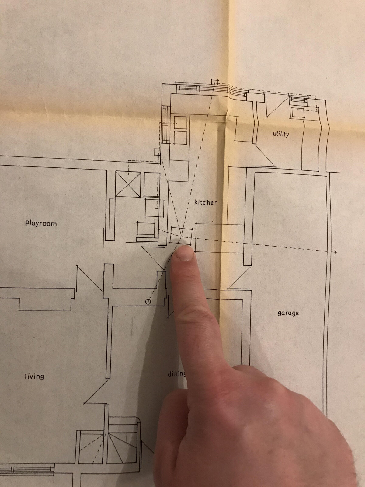

You've been absolutely great. Since the pan is off and I have a clean pipe approx 50cm away from the covered drain I'll give it a go. I've just found the plans from the original extension and thought id share the drainage plan FYI. I'll take the pan off and rod down to the covered drain

If everything else is draining away ok then the blockage could just be in the run from the toilet to the manhole. Don't be surprised if you have a blocked manhole which might need to be jetted.
Andy
Thanks Andy.
Do you think a professional with a Jetta can get down a vertical 4 inch pipe, approx. 70cm and feed to the covered drain approx. 50cm away? I've no experience how flexible the equipment is. I love DIY and engineering but this little problem is beyond the keen DIY man
