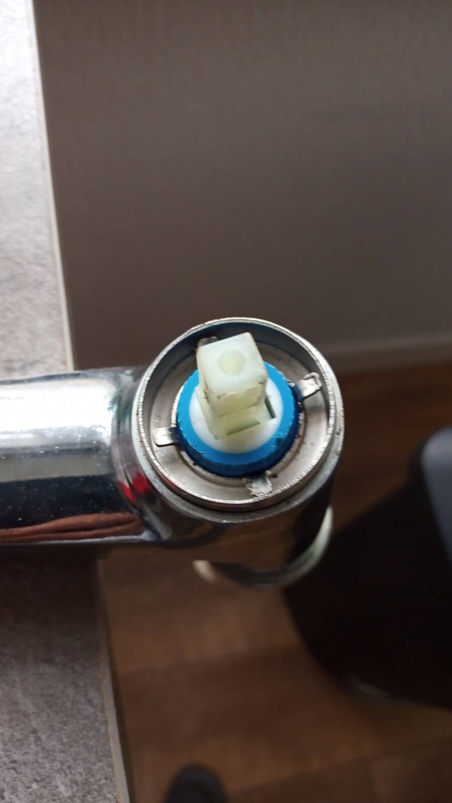

Hello I don't know how to remove the fixing ring from a cartridge in a mixer tap to replace it. Not seen one like this before. I've attached a pic...can anyone help please

Do you know the brand?
I'd be trying to rotate those 4 tabs and see if they unscrew to release the cartridge.
Or even the blue plastic ring.
Something unscrews a retaining ring to release the cartridge.
