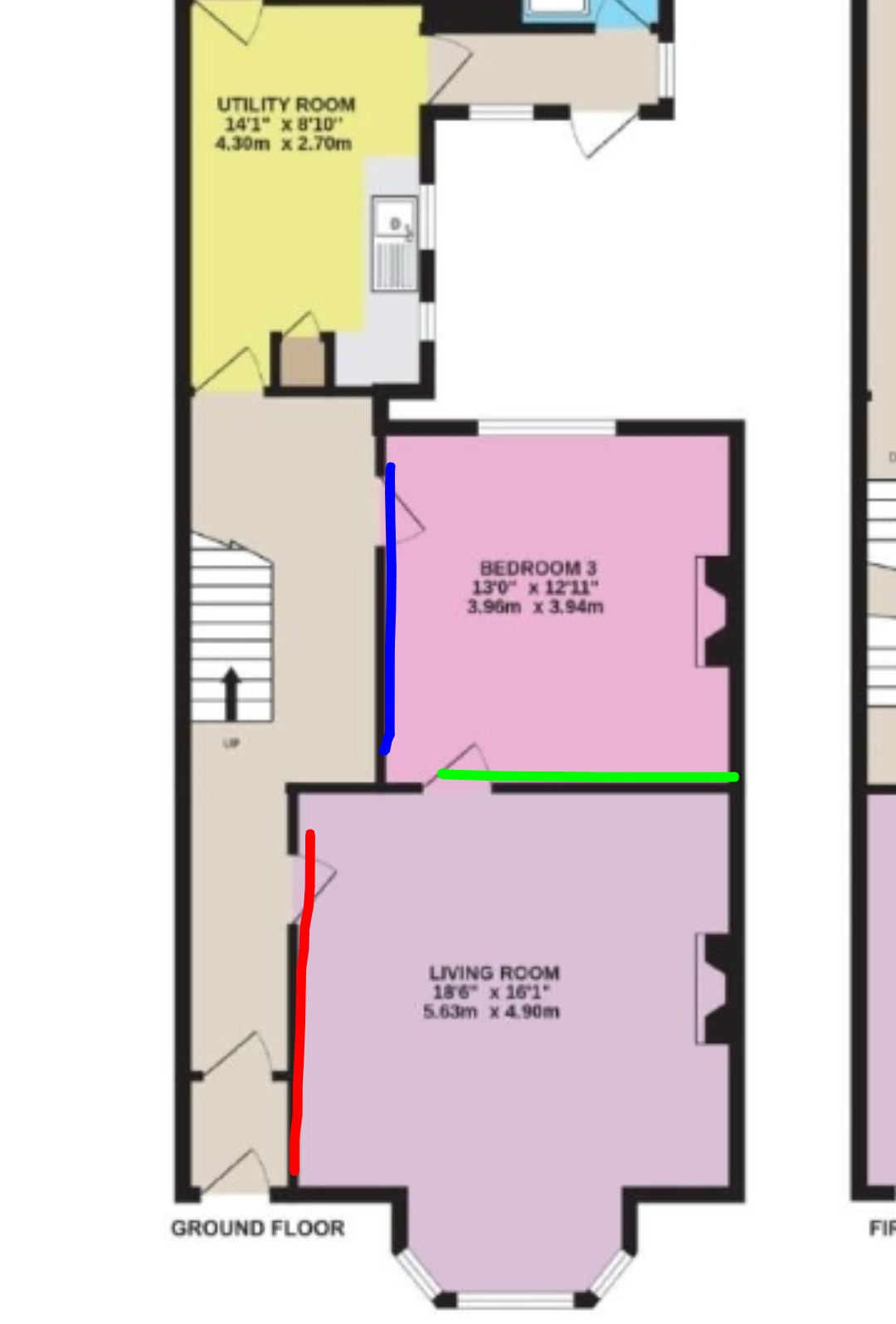

Hi,
I wanted to ask about removing multiple walls in a Victorian terrace.
Is it similar to removing one wall multiple times or is it very likely that the point where multiple rsjs would rest would need significantly modifying to take the weight?
We'd really like to take out the green and blue walls and possibly the red too.
The back garden is steeply sloped so can't have a side return or there would be no way to exit from the back. Any advice much appreciated. Thanks.

You need to add a similar drawing of the floor(s) above that, and likely the roof layout too.
Thanks, I'll get them up. It's three stories, floor above identical except front room all the way across, 2nd floor the front room is divided into two bedrooms.

Then the ONLY person to consult isn’t faceless people on the internet it’s a local SE
I'm not a structural engineer, and you'll need one, but if you would end up with multiple rsjs transfering load through the same spot, then it's quite likely that spot would need additional reinforcement to be up to the job.
What I can tell you is that it sounds expensive!
If you want a cheaper solution to be able to see more, then you could use cameras connected to big screens ... that would be a lot cheaper for the same effect.

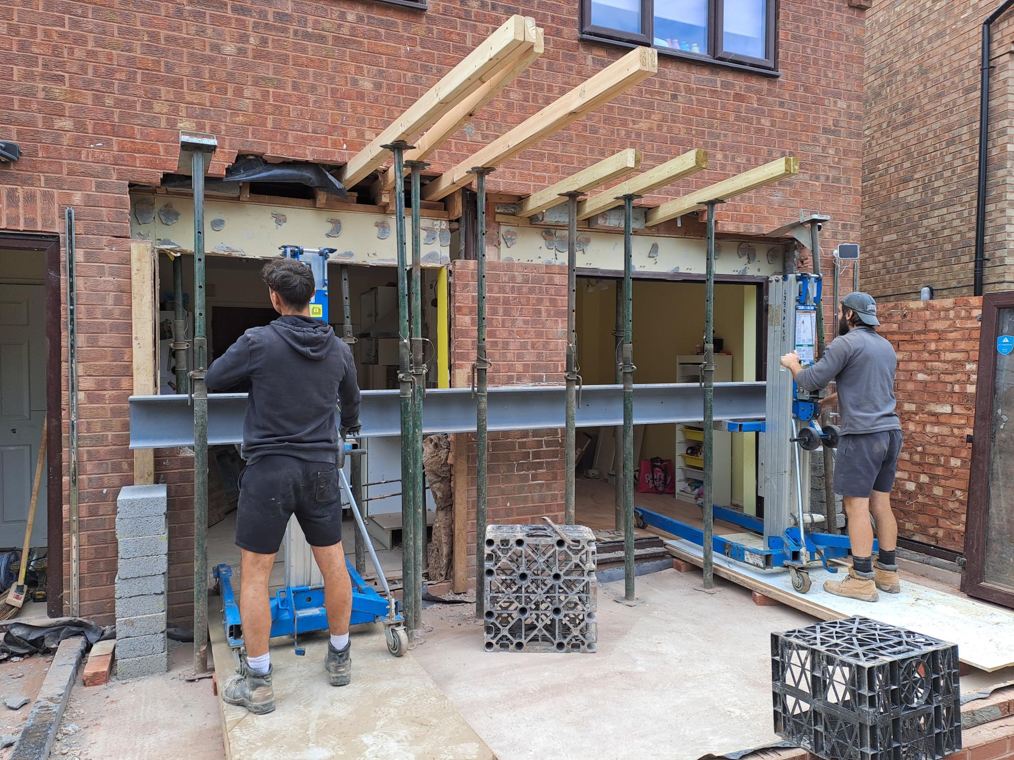

Hefty, heavy gauge (green) steel beam beam in first. Red and blue added after and bolted to it. May need some on-site fabrication i.e. drilling and/or welding.
We've done a few 'steel rich' jobs. I find producing drawings for the steel people the toughest bit.
Perfectly possible, might need some posts or masonry piers. With 3 storeys you need to consider your fire escape route - I don't think you can just "open plan" the staircase.
Hi, that's really helpful. I hadn't thought about the fire safety of an open plan staircase.
You can exit from the first floor to the garden so possible it would t matter but I'll look into it.
