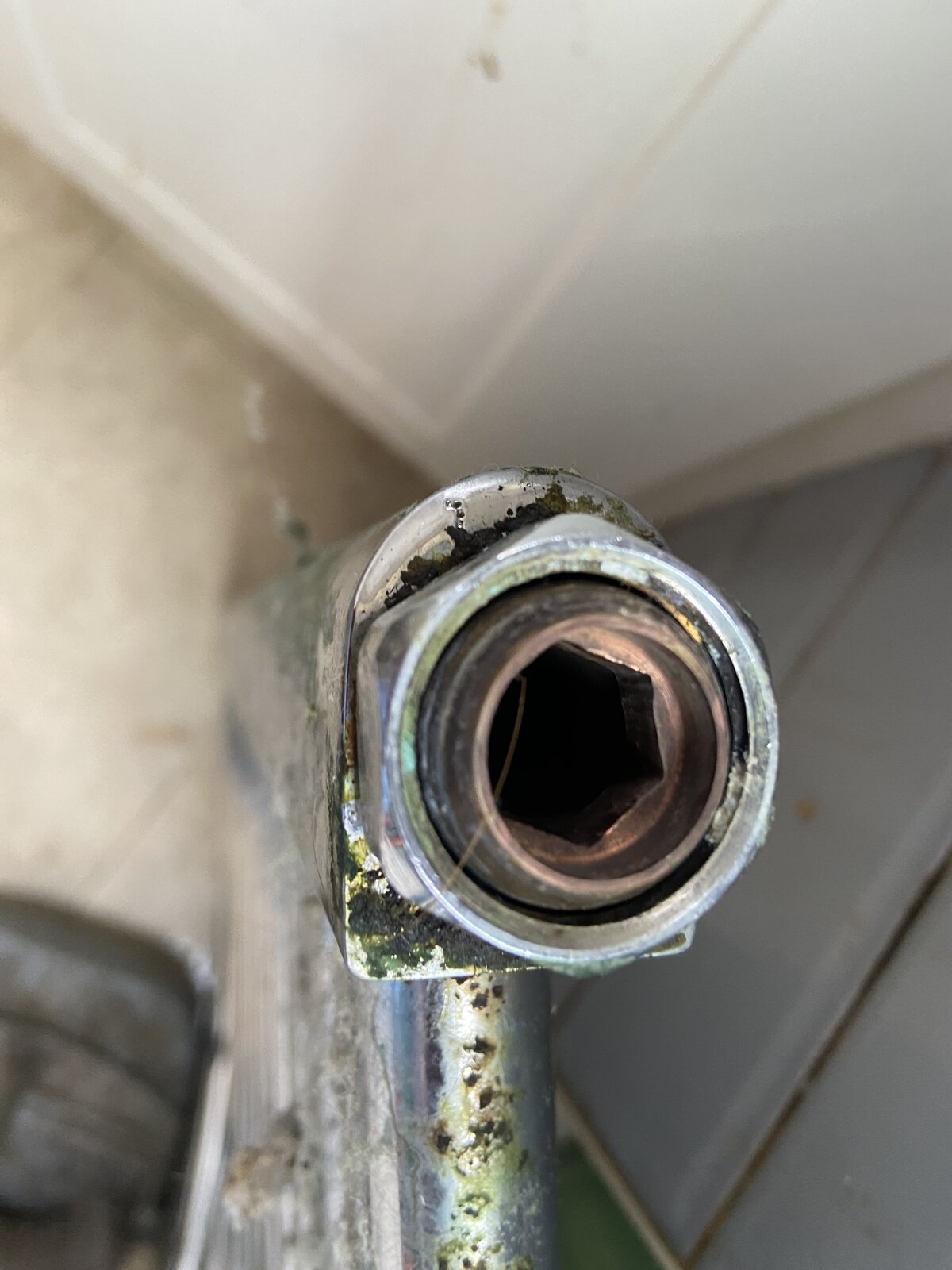

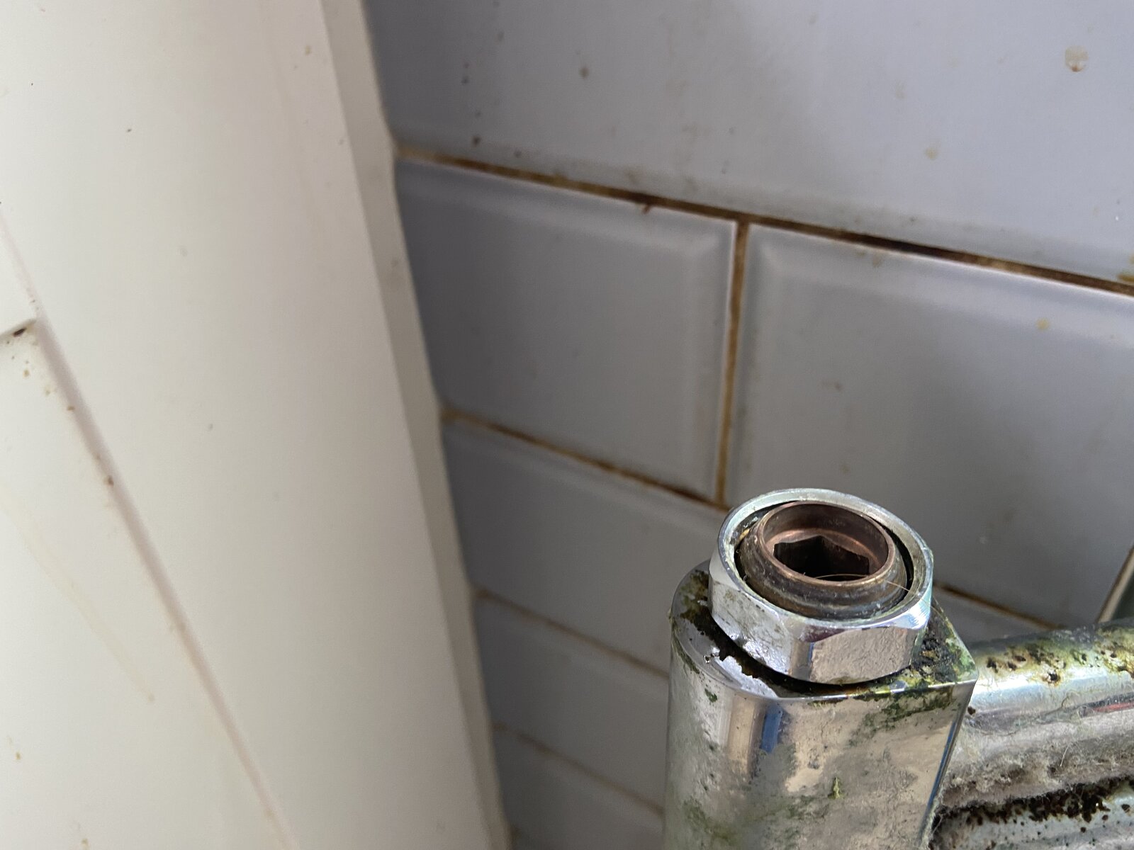

Hi
Replacing ancient towel rad as part of bathroom upgrade. Removed old rad and see the connector in the images. Do I just need to remove the nut with a hexagon key and use this with new rad?
Just asking, as not provided with new radiator.
Sorry for dopey question,
Take care.

Hi again
Typical-biggest Allen key too small. Seems to be about 16mm width. (Just short of 3/4”) Is that what I need?
Regards
If stuck for a correct allen key, I used to insert part of my Footprint grips and tap home with a hammer then proceed to unscrew the union tail. When stuck miles from base, you have to improvise or end up with an irascible customer;)(y)

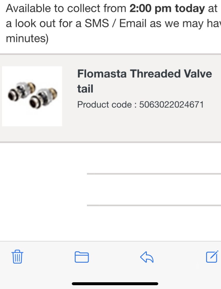

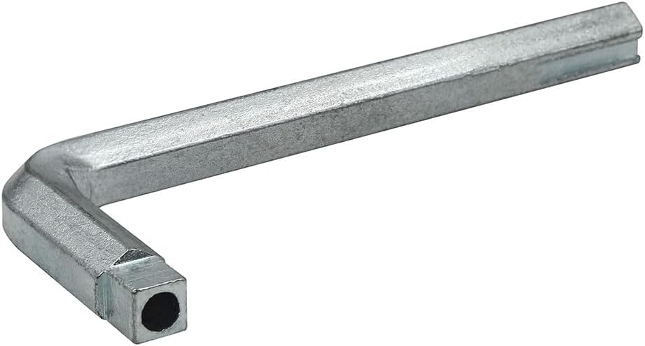

Hi again
Bought the above product from Screwfix. I’ve tried loosening the old ones, as needed the key anyway to tighten new tails purchased.
I’ve inserted the 13mm into slot, and it fits snugly. However, I can’t budge the inserts. If I put key into drill, it just spins around? (Am going anti clockwise)
Any wisdom from sages would be v welcome.
As long as the allen shaped tail key fits nice and tight into the hex in the rad tail then just get levering, it should go eventually. Some can be really stubborn if the installer rammed them in too tight.
If a really stubbornly tight thread won't budge with brute force then try heat to the rad to expand the outer metal. A good well aimed flame usually does the trick as does a knock with a hammer on the key. Remember, a faint heart never won a fair maiden .. give it some welly (y)
Thank you (for both suggestions). I’ve since got some movement, but only by bashing the other part of the L with a mini sledgehammer. However, worried this will knackered the thread. Also curious about behaviour of key in drill, as alluded to in my previous post.

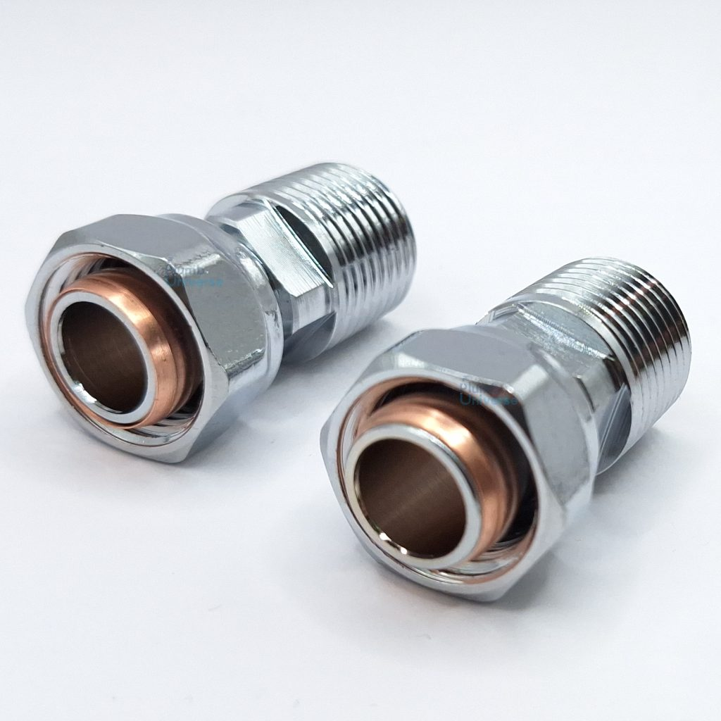

Moving on, the new TRV valves fit new rad nicely, but I only seem to be able to tighten using a spanner on the external nut. No room to get the new rad key that I can see. Is that right?
(Attached image of valves purchased from B&Q.
Sorry to be taking so much of your time.
Regards
They look like 1/2" tails - A bit strange though, not the normal tail you would use, you would use an adjustable on the flats and just nip them up. They use o-rings to seal to the rad tapping and to the valves so no need for PTFE tape or similar. Just make sure the tapping and the paint around it is nice and clean
These are what would usually be 'normal' 15mm rad tails, that use PTFE tape on the 1/2" threads to seal into the rad tapping and a 15mm compression end for the valve/TRV
