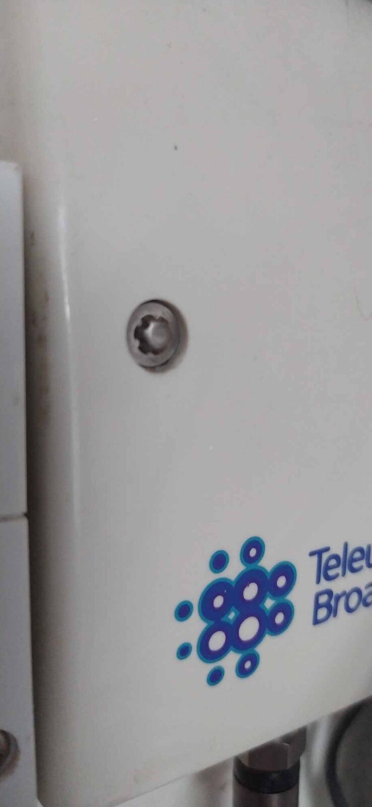

Hi all,
currently in the process of renovating my house. There’s an ancient tele west cable box point (pictured) on the wall that I want to get rid of.
Just wanted to check and see if anyone knew if this carried any voltage? I don’t want to get a shock trying to get it off the wall! Normally I would think not, but the fact the box is held on with two star bits makes me wonder
any advice would be greatly appreciated
The star bits are simply there to hinder Herbert messing around with the connection in some half-arsed DIY bodging way. The cable won't carry any voltage.

Nintendo security screws if memory serves. I carry a set to remove those old boxes when I need to remove wallpaper ect behind and only coax cable inside. Should be another box outside that you can disconnect. Safe to do.
Can't remember if its the 3.8mm or 4.5mm but they come as a set anyway
They are called torx security screws not nintendo, nintendo just happen to use them
google torx security bits to get a set of ends suitable

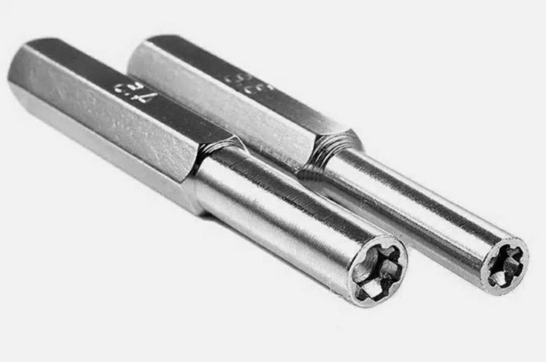

Nope. Around me you need these View attachment 220910
Thanks - will try and find a set!
they are standard torx screws but a flat bladed screwdriver wide enough to go in to opposing slots will sometimes be enough to loosen the screws AMHIKT
Torx is easy to get from screwfix or toolstation but like I said. Won't fit.. Unless they did use them around your area. Screws are like this

Wayners, have you actually looked at the picture above?
It's clearly a socket yet you showed a picture of 2 bits that fit over a screw.
A Nintendo driver can also be the 3 blade/triangle bit too.
A torx will fit this one.

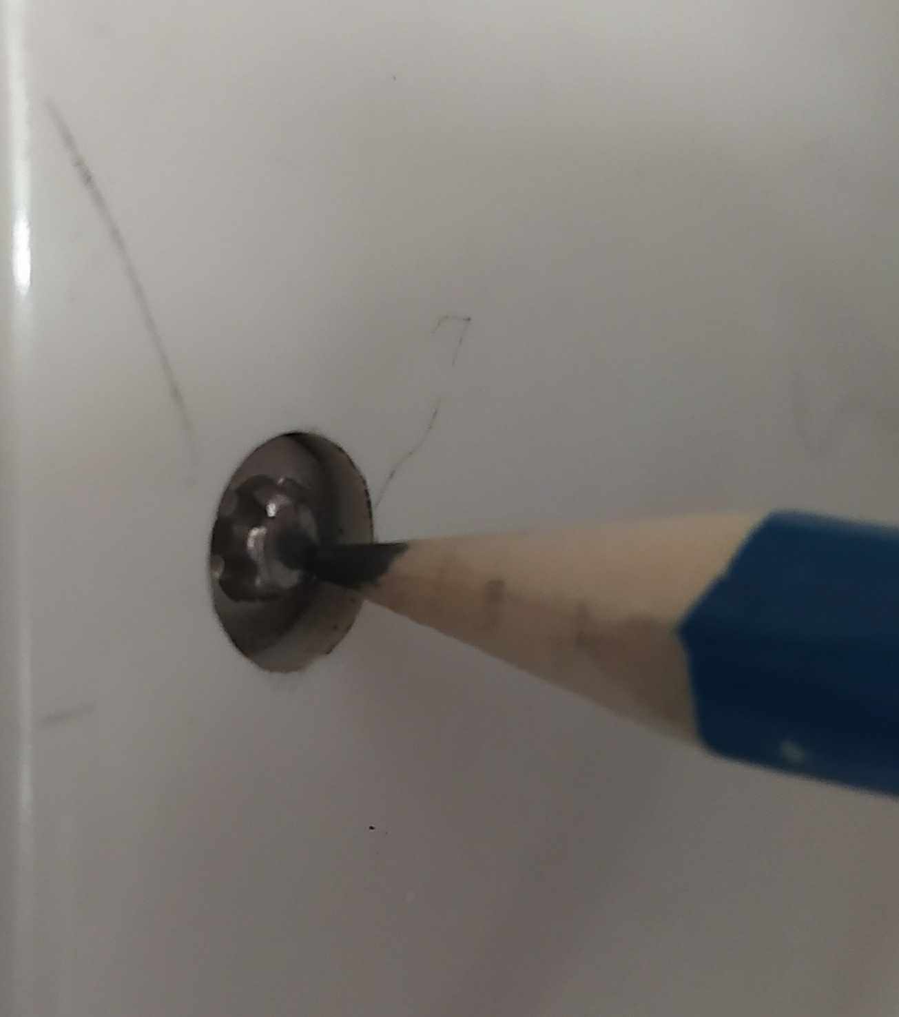

@mattylad
It's not torx. It's a dome not a hollow. Convex not concave. Torx fits inside down in the screw but there is no down inside these. Here is another picture of mine below.
I asked on another forum and many came back convinced it was torx and I have 2 security sets with and torx with and without the centre pin hole.
I'm tempted to make a youtube video but don't want any trouble as it's a bit incriminating.
Here is another picture. Can you see its a dome sticking up. Op picture is the same..
You need a driver that fits over the dome (convex) also there are no sharp points around edges for torx. Some have said they got hold of done with long nose pliers and turned. I could not see how.
ATTACH=full]220947[/ATTACH
Honest. I have a set and removed a few.

OK I give up!
your correct its not a torx, in the ops pic they look like they are concave.
Op, if you don't have a tool to open it just break the plastic, wire cutters at the side will chomp through it.
Heck a little pull and it may even fall off the wall.

We were both cool about the chat and it's good to get information out in the wild. It's why I'm on forums but your right. It dose look like torx. Took some research to find it was Nintendo screws. Honestly. In the words of Victor Meldrew when you try getting them out. Guess they wanted to stop people. Yeah. Hammer is another good tool... Lol
