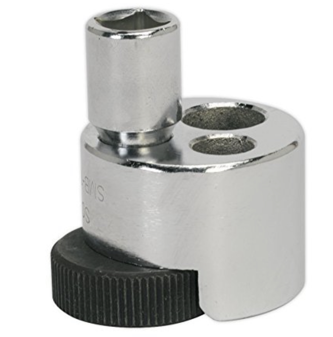

Are you certain the snapped off bolt is only 10mm? Theoretically that means a thread of 6mm unless its a rolled bolt without a conventional head size.....I've only come across bigger sizes.
Anyway, a stud remover as per Mottie -- I've had great success with the top one but I doubt if that would go in - never used the smaller tubular types.
If it was mine, and I was home, I'd MIG a nut on the end of the stud and try that, but wondering why the Germans wouldn't crack on with it?

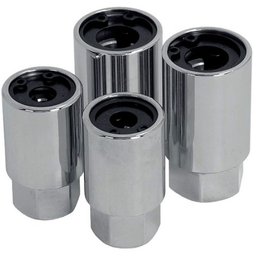

So coming back to the suggested stud extractors, I can see that the top one has (probably) an eccentric knurled wheel and a hole to fit over the shaft - would definitely grip a shaft with a flat ground into it if there was enough room. That's one option, though I may have to dismantle a number of other parts to generate that space.
The second option looks like a concentric (and therefore slimmer) device; but how does it grip, and would grinding flats improve its grip?
Are these stud removers widely available from motor factors? What are their names? Brands if that's relevant?
I personally wouldn't grind anything off. Maybe warm the head around the stud area with a gas blowtorch. Just do a search on Amazon for 'stud extractors'. Plenty of different types on there. (y)
Roller extractors are individually sized....in your case 6mm as per a BGS 1883.
I hope it goes well....you did mention some movement in your original post?
The good bit about the MIG idea, the intense heat produced often helps greatly.
John :)

The Sealey one that you pictured may be too bulky, but at less than a tenner well worth taking.
The socket types are slimmer, and 25mm diameter for a 6mm extractor should fit in the space. Because I can't easily see the method they use to grip I am reluctant to buy just any old Amazon brand - it's a 1400 miles round trip, and not worth buying a poor quality tool (or tools) if they fail when a bit of grunt is applied, eg I have seen one that looks like a drill chuck that is manually tightened; it just doesn't look up to the job.
As I said, the bolt is not rusted into the head, it has radial movement of about 1mm fore and aft when the mole grips are applied, so heat application should not be necessary (but I will pack a blowtorch for plan Z use)
Next stop, You Tube...maybe someone has a video showing these suckers in use....stand by.

Any recommendations on which brand of roller extractor...it's a long and expensive recovery trip, so a poor extractor would be a waste of money.
