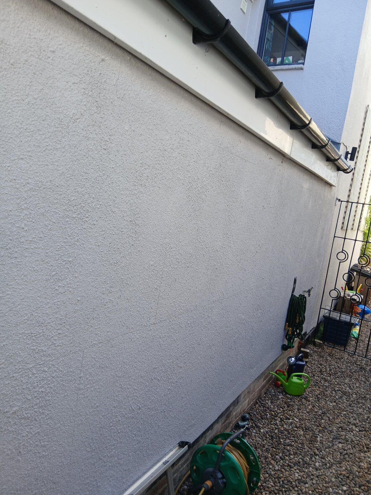

Our kitchen extension is cold. There's cold air through the plug sockets and a chill every time it's frosty.

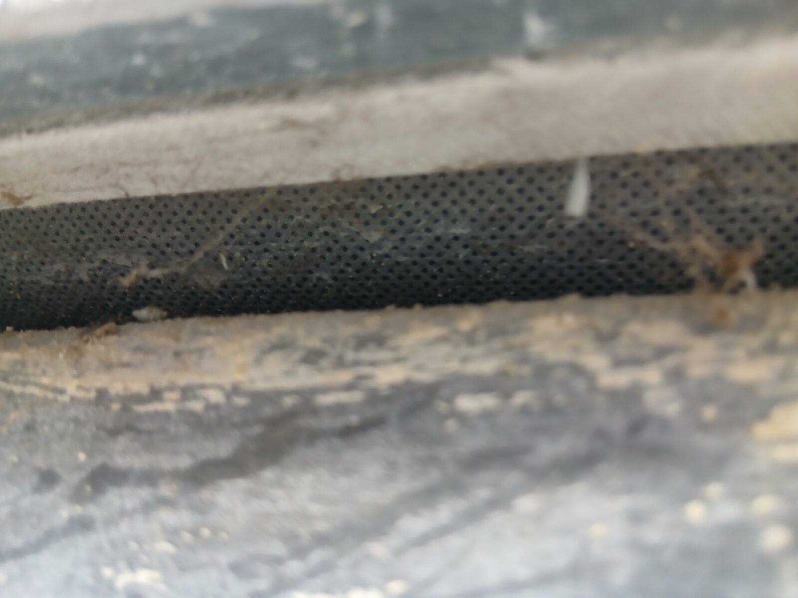

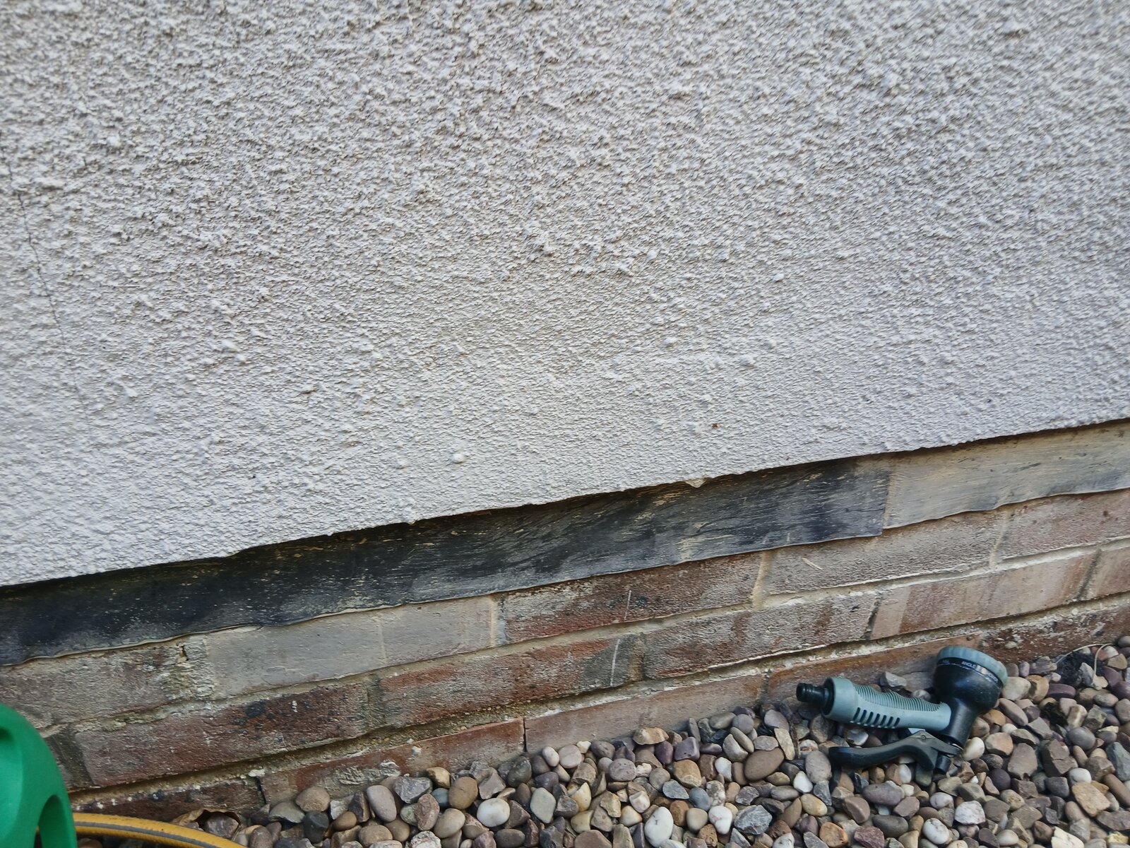

If i put my fingers at the base where the grey render stops outside there is some sort of black mesh/sheet. But it's not sealed.
Could this be how the wind is getting into the kitchen and making it cold?

It's more likely you just have inadequate insulation in the walls and roof.
Most rooms have one or two external walls, an extension typically has three greatly increasing the area exposed to the weather and required more insulation and usually a larger heat source( radiator).
Air doesn’t normally pass thru sockets.
Is this a recent build?
It's around 10 years old. We.moved in after it was built so have no really details. Its a detached house so we have nothing but external walls

You could get some plastic sheeting and use gaffer tape (or Gorilla tape) to stick it over the mesh temporarily. You could then tell if this is causing the draft problem. Leaving it in place for too long may not be a good idea as lack of void ventilation may mean it starts to get mouldy inside the wall.
Is there external insulation? I only ask because of the mesh at the bottom..
Not as far as I know. That mesh is some sort of fabric which is betweek the brick and the grey render.
The mesh should have been cut back to under the beads.
If it is block or brick built air cannot get under the render.
