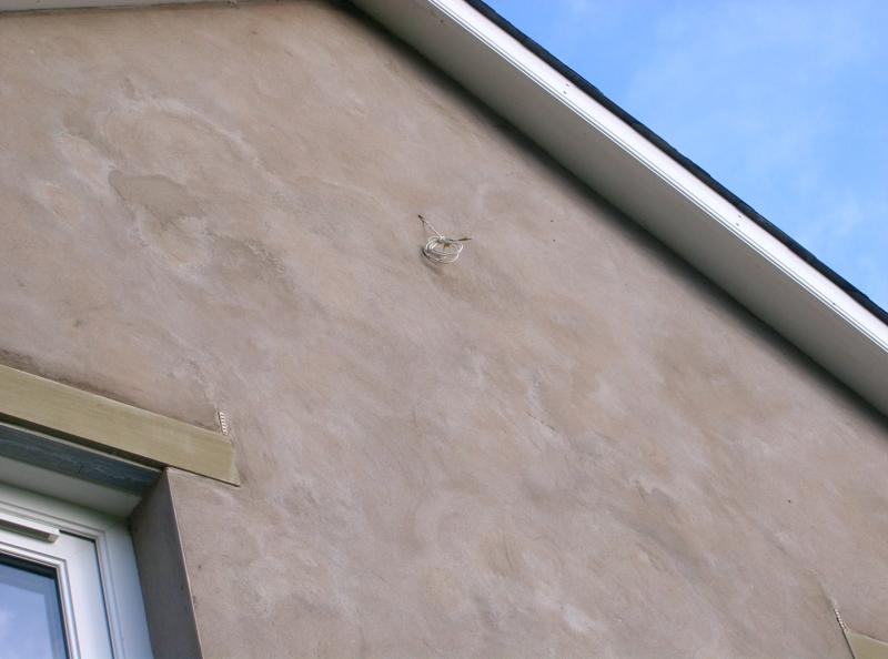

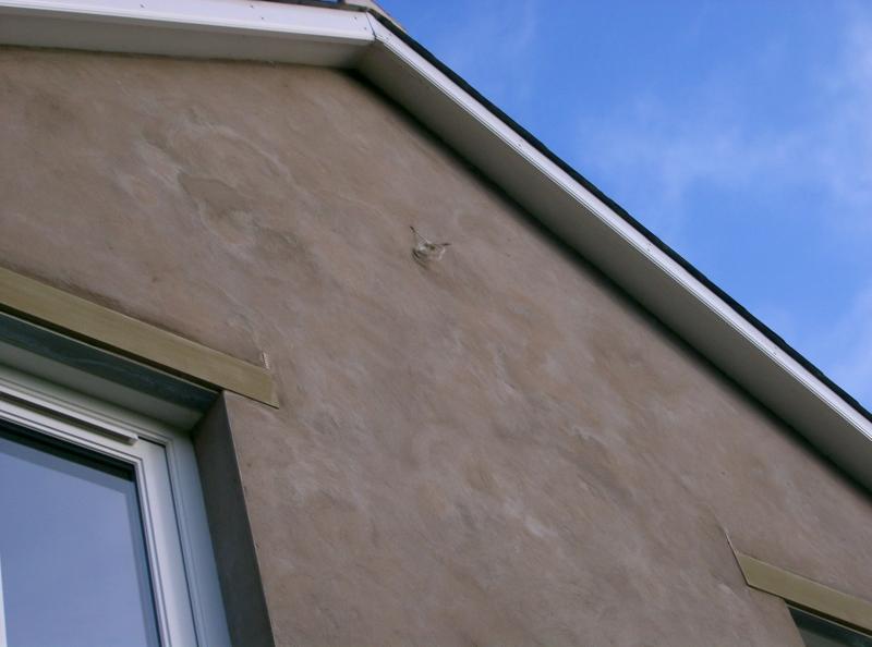

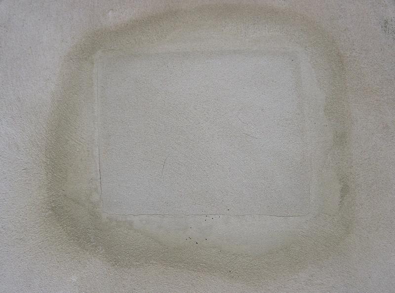

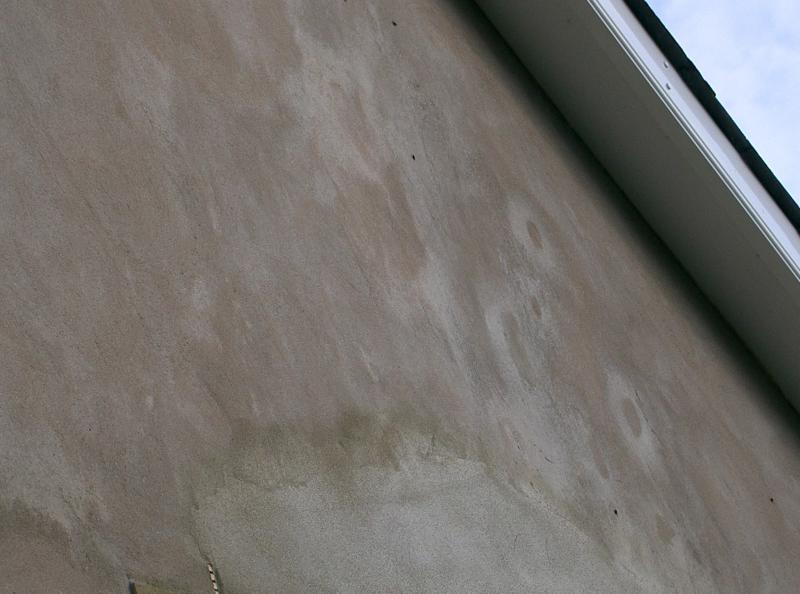

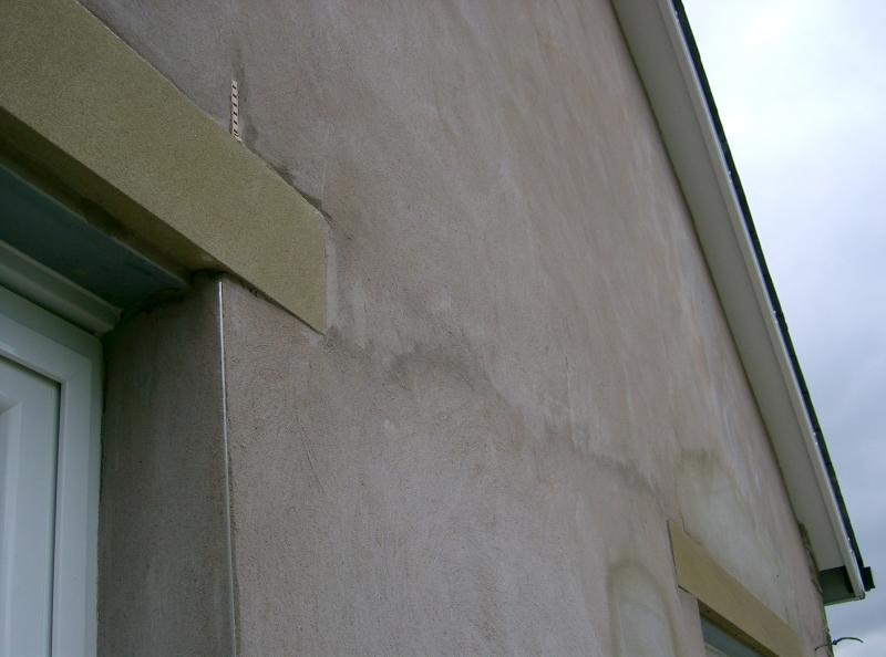

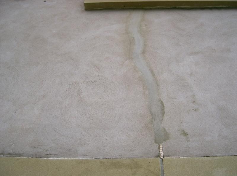

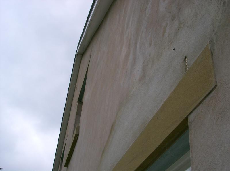

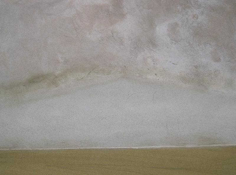

Thanks very much to everyone who has taken the trouble to reply so far. Yes, "yee-ha"'s and riding off into the sunset abound here! The renderer was sourced by the builder who has been working on our house for the last 18 months (as were the k-rend guys...), so we have recourse to him, but after failing to get the job done on the first 2 attempts, we're trying to be a little more proactive this time.
Below are a few more pictures of the work, including some of the patches, which are themselves now cracking around the edges and in their centres. Additionally, tapping on the render with a hammer has revealed several more small "blown" patches.
Ref. the elevation - yes it is entirely new, so I would think some small amount of settlement would not be unexpected?
So we've now had someone who we believe is a professional renderer visit. His opinion is that the job is probably "70%" OK, and probably what would be expected of a job done by a skilled internal plasterer who has turned his hand to rendering. He is advising not to hack it all off, and says this would be expensive for a job that is not horrendous (2 men, scaffold, a week, a skip...).
He is proposing "elastomeric" coating may be appropriate, and says he has worked with both Protex (cheaper) and Liquid Plastics Monolastex (Rolls Royce) previously. We don't like the samples of the "normal" texture he showed us, but the "fine" (not smooth) does look quite attractive (esp. the monolastex). He says that although this will not give a 100% seamless finish, it should cover most of the uneveness, as well as providing a protective coatin that will flex with any movement and resist cracking, including 15 year guarantee (etc. etc.). Including remediating the small patches of blown render - which he proposes to do - he is quoting in the order £1800.
What do you guys think of this approach, and the price? Are we lurching from one disaster to another?

That's 'hor-render-ous. I can't see anything sorting that lot our. I'd be amazed if you got it 'sorted' and never had any further bother. If this new bloke thinks that is the work of a skilled plasterer I'd look in his van for his Stetson and Colt 45.
Don't rush into anything. If it's blown - it's got to come off (sooner or later it will).
I'm sorry but I have to agree with joe on this one... :wink:
Hi rawdon, you say you had a professional renderer look at it, there is no such thing as a renderer. A plasterer yes, alarm bells ringing for me.
Sounds like a lot of money for what he is going to. You could remove the
hollow areas and patch up, then tyrolean the lot. Sure this would be
cheaper than 1.800. Agree also with the above, Find a local plasterer, someone who is established in the area.......If it was my own house i
would take the lot off, and start again. prob days work 2 men with kangos
to remove. your'e not paying, so get what you want.

If the scratch coat they put on was sound against the blockwork, but it was just the finish coat that has blown, would it be possible to remove the top coat & leave the scratch coat. Or is it better (or just as easy) to get all the way back?
