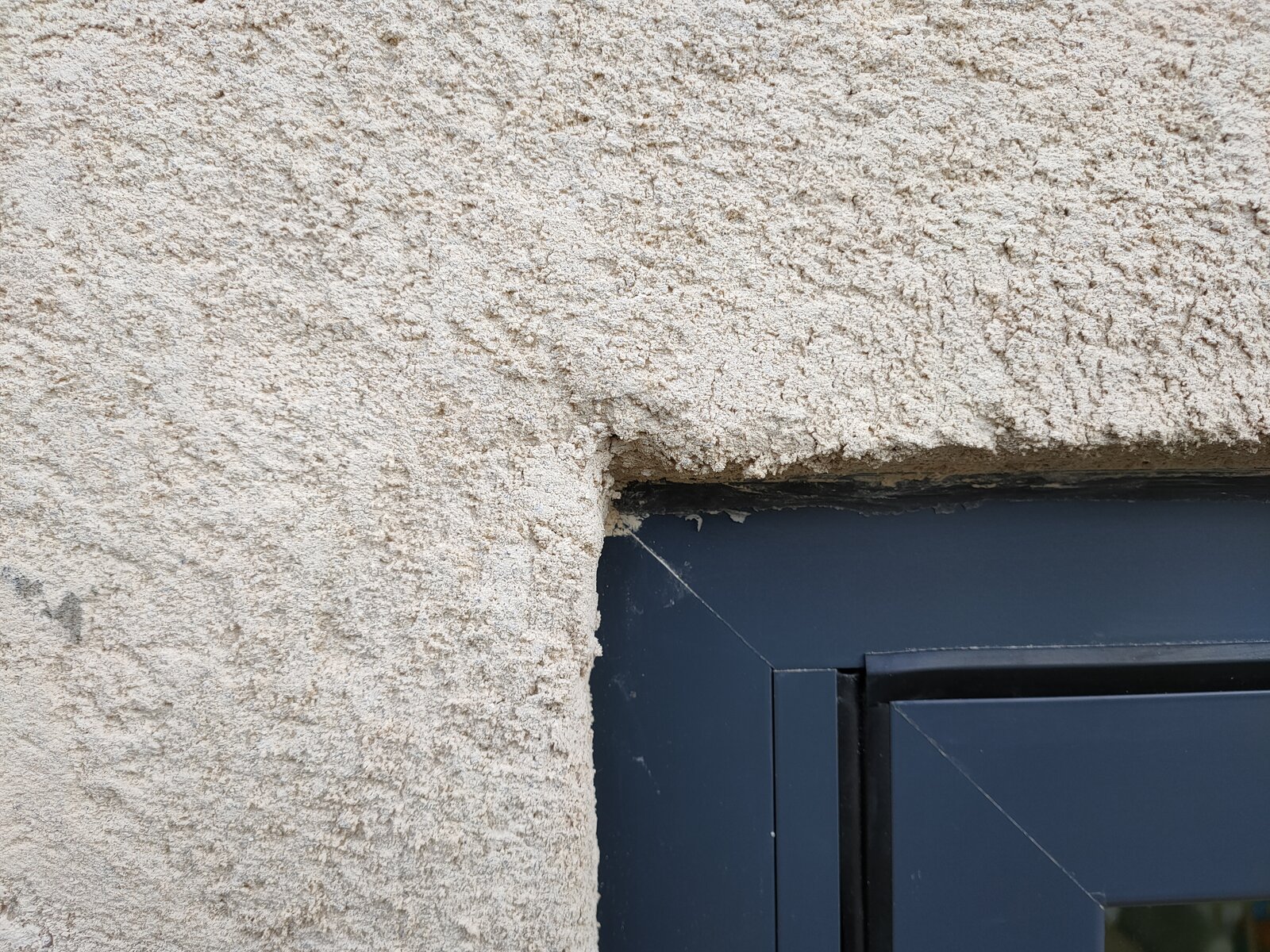

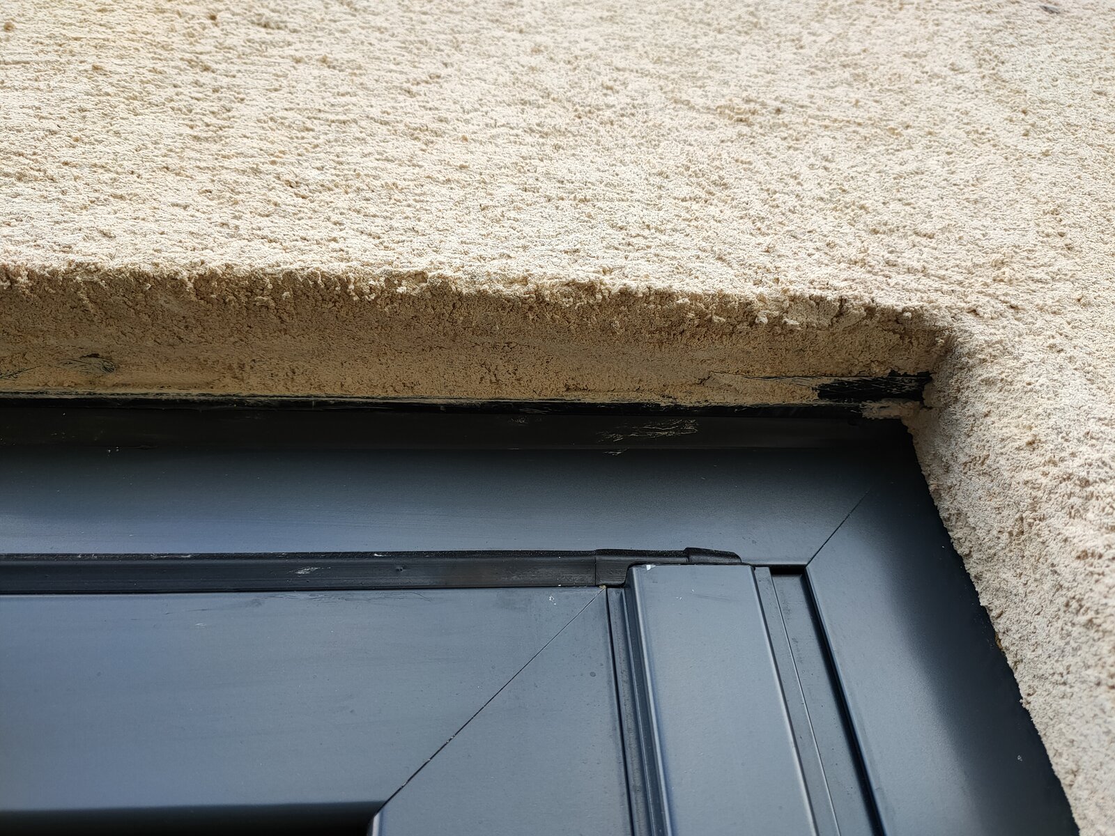

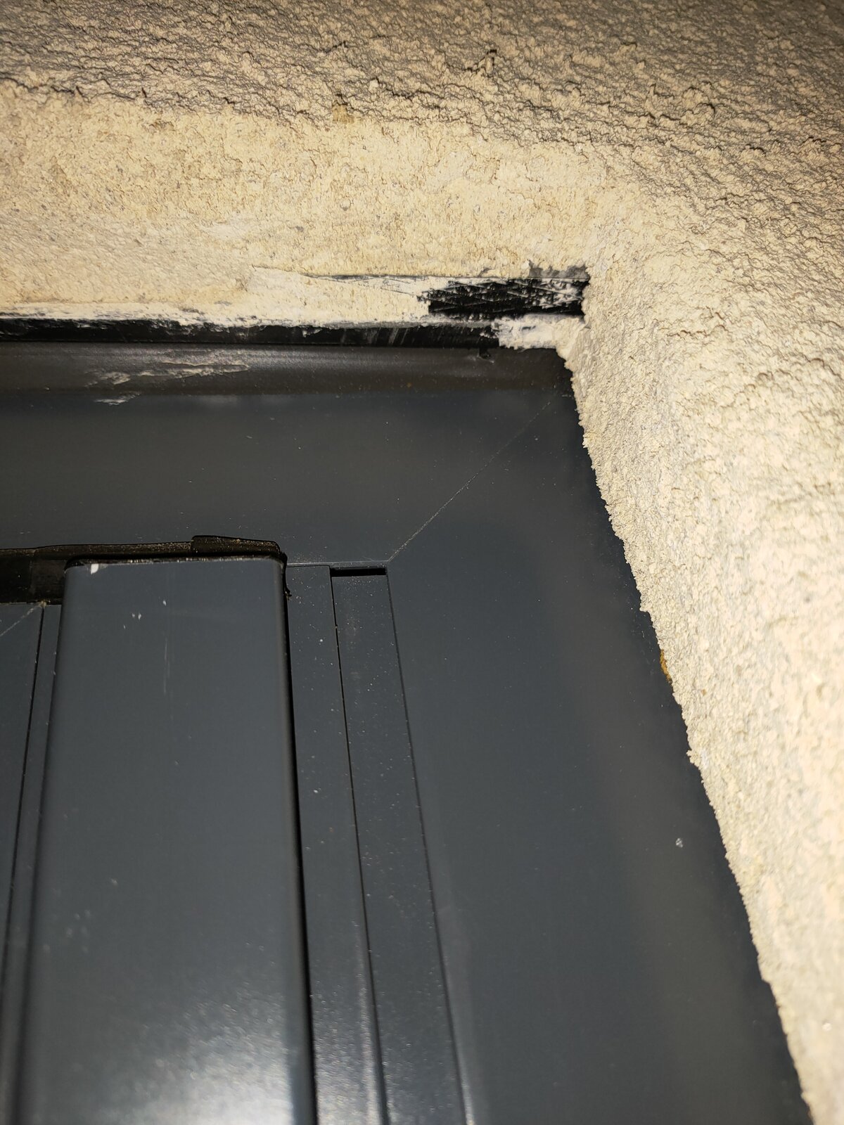

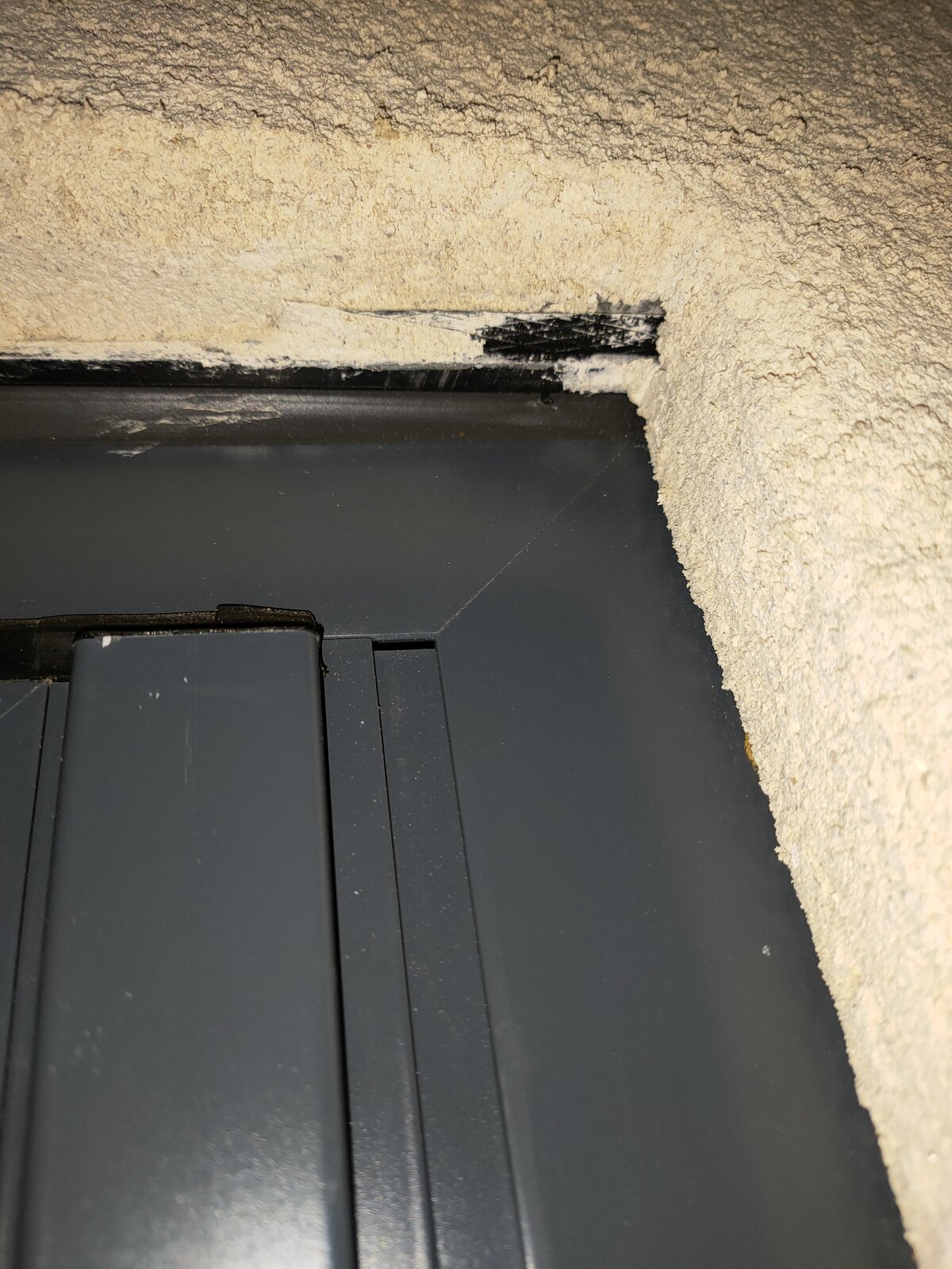

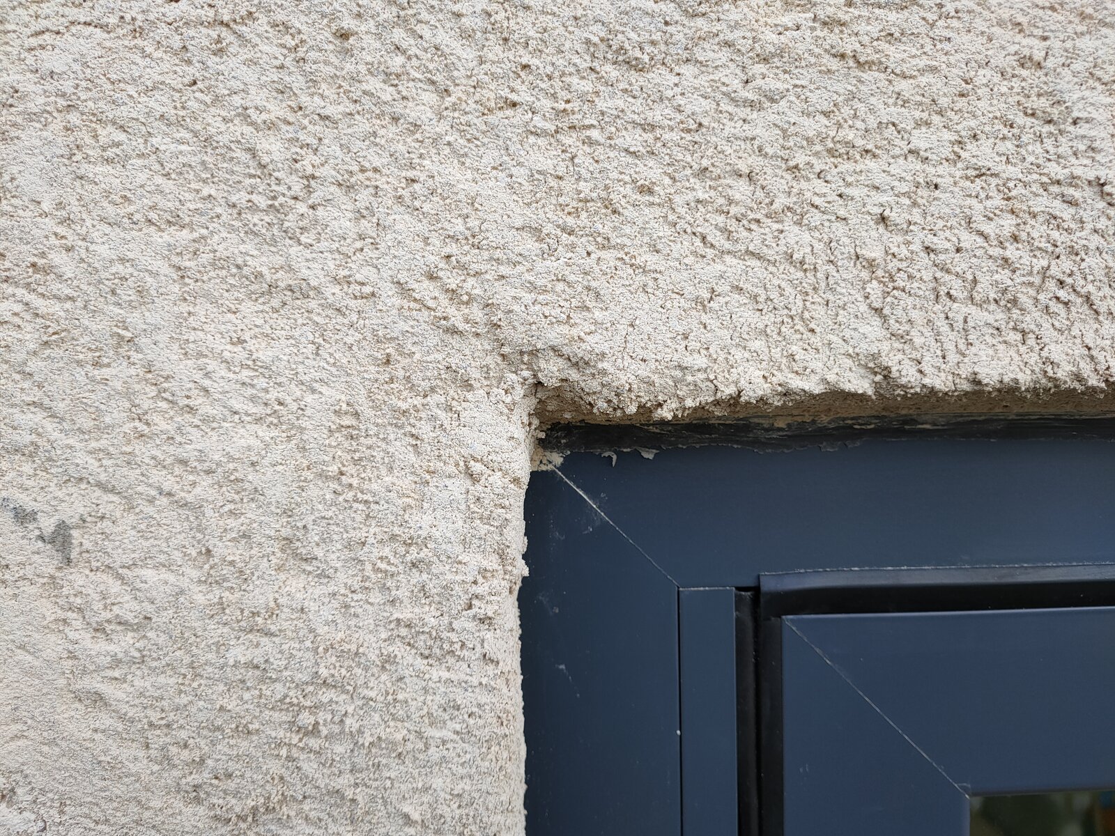

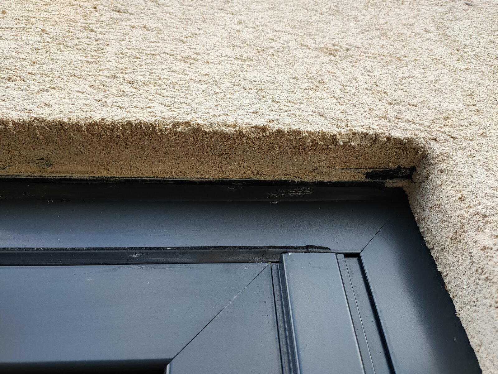

Hi guys, we recently had a new Lintel installed and bifolds fitted on a rendered wall.
We believe the finish, particularly the edge could have been neater. The renderer says that due to the space that is available, a corner bead was not possible. Some of the edging is ok, but some is quite scruffy. I would be interested to hear what you think.
It's not easy to get a good overall picture, which is probably why the rendering guy reckons it's good enough.
Many thanks

Hi,
Personally, I don't think the rendering guy should have even attempted to render into those gaps.
Some cloaking fillet architrave, coloured to match the bi-folds, may have been a neater solution.
