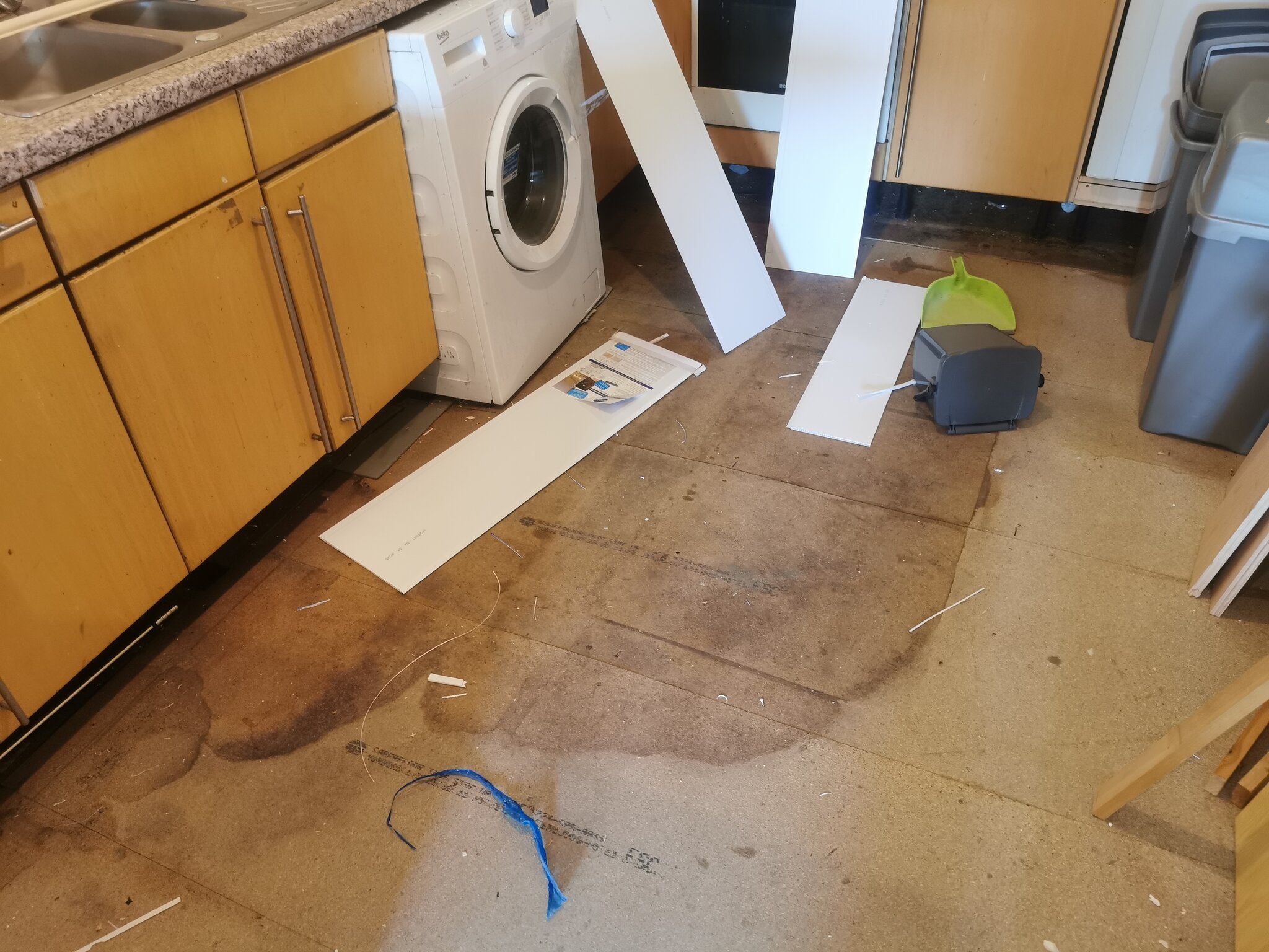

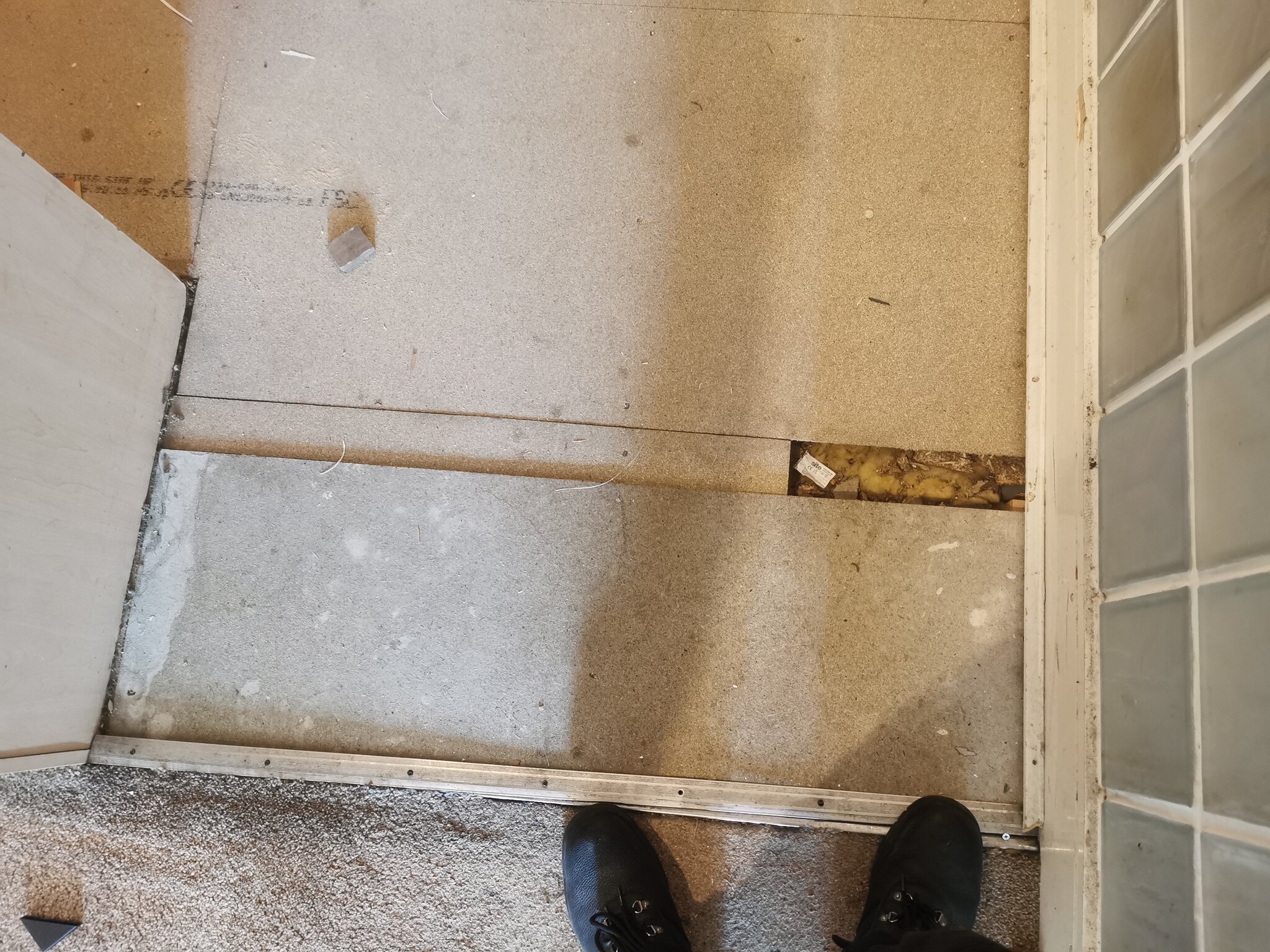

So latest project is to remove damaged chipboard and insert new ones. They are nailed in. How would the experienced folks approach this task?
Circular saw set to depth and run along.
Make sure you drill some large holes in floor and look for pipes ect. The run saw along
Seriously!
If you are going to attempt DIY you need tools. Come on!
They are cheap. Seen one now for £28. Probably less second hand..
Buy one.
Any old make will do.
And a drill and hole saw.

Got everything else you said but the saw. However I'll invest in one!
Cool. Take your time. Any other questions do come back.
