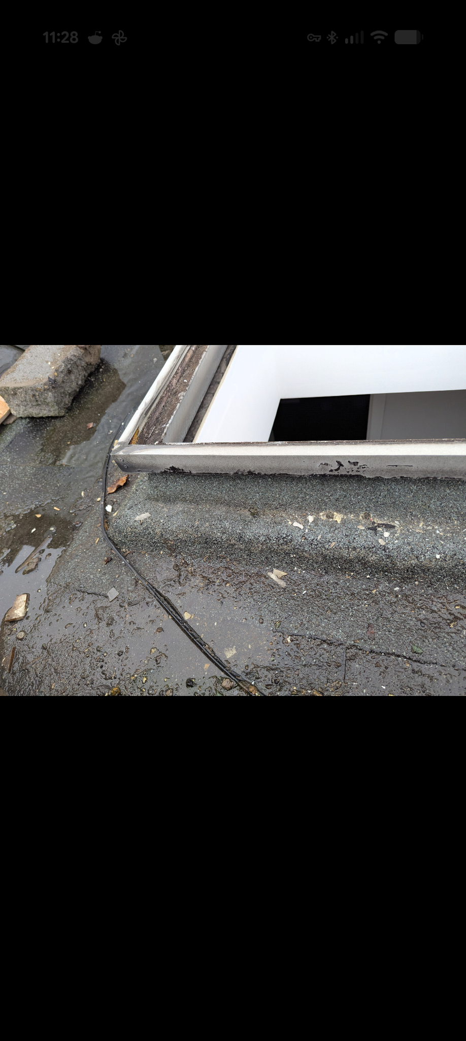

Hi gents any help would be appreciated, I have a small roof light and upstand I need to replace on a felt roof, do all the felt flashings that are secured to the deck have to be removed? I will have to cut around the base of the upstand so that can be removed, I'm wondering what best practice is, should I remove the rest of the felt attached to the deck as it seems pretty well stuck down.
I have tried to get roofers to this but getting a roofer willing to do it is another story, I have some experience using torch on felt/underlay so I'm not worried about that, I just want to make I'm doing it the proper way
Cheers for any help
Normally the roof has a structural upstand and then your rooflight and any upstand it comes with is fitted on the top or over the roof upstand
The roof felt would [/should] continue up the structural upstand as one continuous layer. The new roof light and flashing/flashing fit over the top of the upstand and down the side, but stop short of the roof surface
What's the best way to deal with the installed flashing? Cut around base of upstand and remove, leave existing flashing piece secured on deck, install new upstand, underlay and felt over existing piece of flashing secured to deck?
Does that sound ok?
There is no flashing there.
That upstand is non-standard and below the normal recommended height. You need to may sure that it's properly sealed especially from splashes
