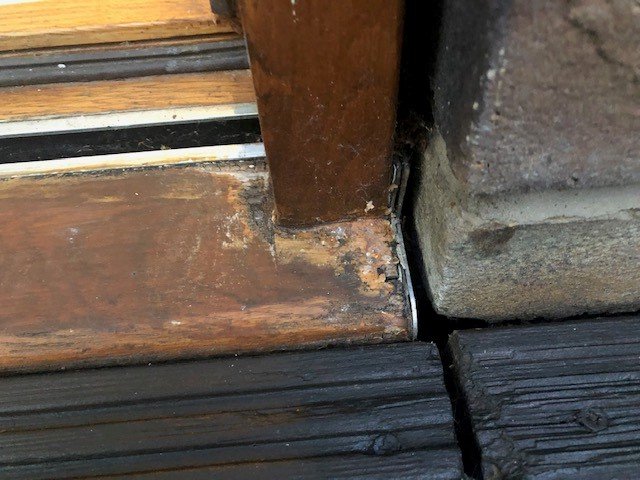

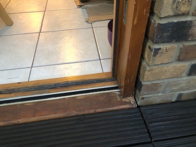

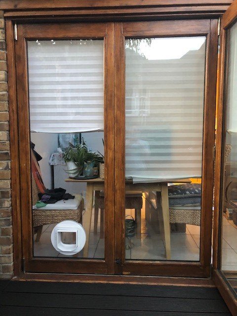

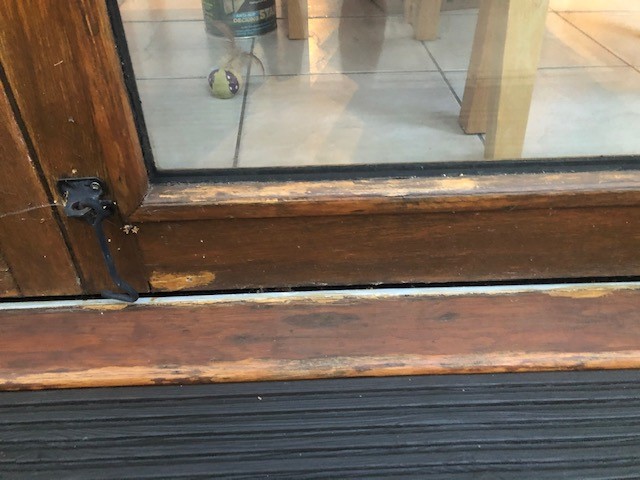

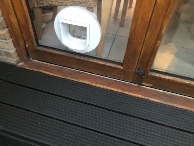

Hi all,
Attached are some images of my conservatory doors.
As you can see, there is some degradation on the doors, they have started to rot.
I have thought about sanding this down, filling any holes, and repainting. Honest opinions - do you think this is salvageable and what is the best way of doing this?
Thanks,
Andy

Certainly look salvageable. The marks appear to be surface degradation which may come out with a bit of sanding, and possibly a bit of filler for deep ones. The tread board may need to be cut/dug out a bit back to solid wood and replaced or filled with filler and sealed. Give it all a good sanding down and re-stain/varnish.
So long as the joints are still solid I don't see much of a problem.
It may be an idea to post this in the woodwork section where there may be some experts to advise you better than me. I'm a DIYer, not a carpenter.
