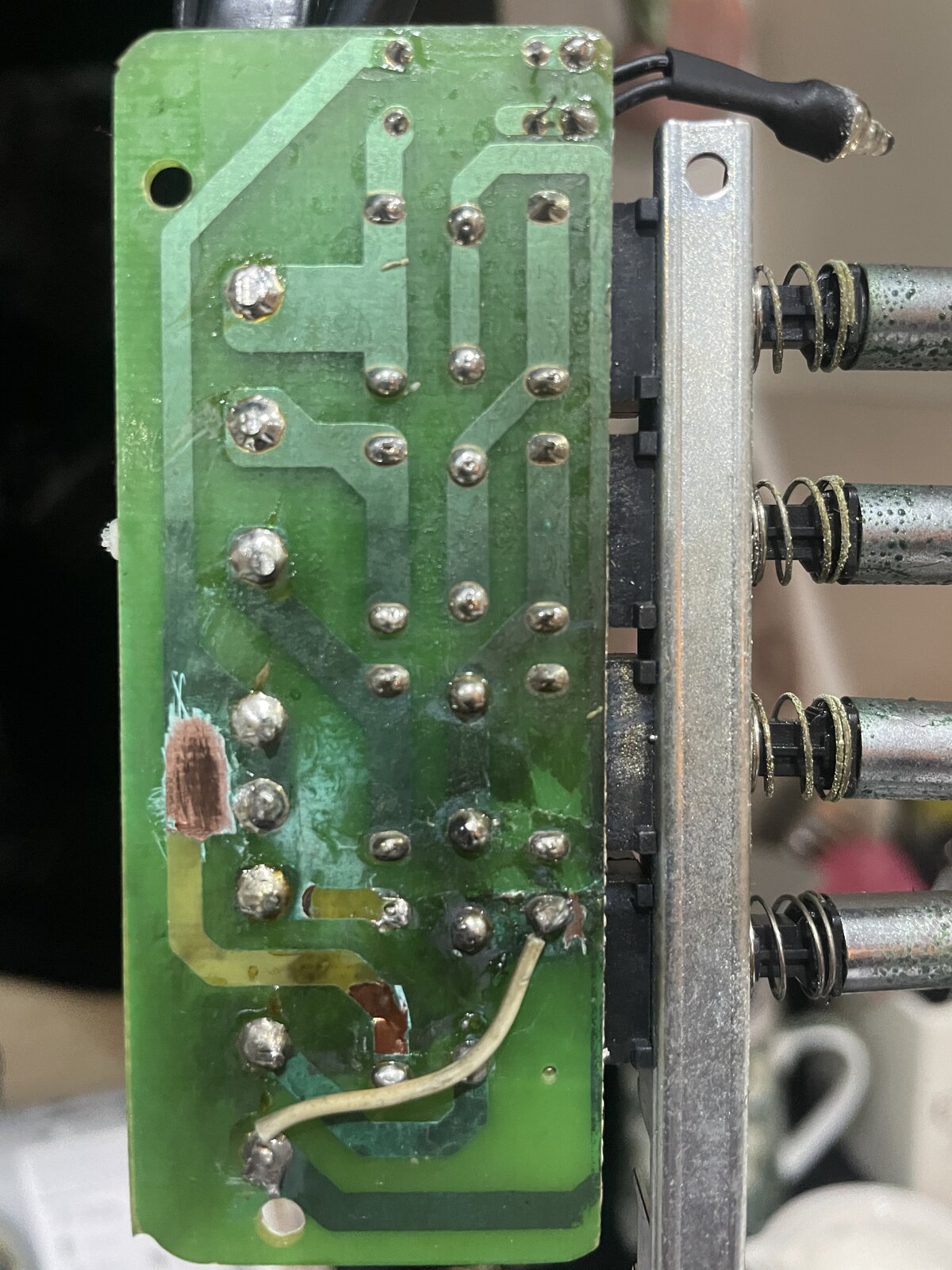

Hi. I’m wanting to repair the pcb on my cooker hood. I’ve attached a picture. My issue is that the tracts are a lot wider (around 5mm) than the jumper wire I was planning on using and I wasn’t sure if I should be using a lower gauge wire; I’ve was planning on using enamelled copper wire AWG ~29. Any advice would be much appreciated.
Cheers
Rich
AWG is American wire gauge. Not available over here. We use SWG standard wire gauge which is different.
To answer your question the wire you have looks OK. PCB tracks don’t normally carry much current.
For some reason, I thought this was an American site so converted wire (0.27mm) to nearest AWG.
Thanks for such a quick reply
For a start AWG size wire is freely available in UK, despite being an American standard, 29AWG will be rated somewhere in the region of ½amp so should handle about 100W with ease.
Cooker hood is rated 190W, so I figure I’d need something capable of carrying about 0.9A? (Or is my reasoning fundamentally flawed here; as you can tell, my understanding of electricity is extremely basic; I’m presuming that it will be 0.9A flowing through the PCB?) May be 0.4 or 0.5mm to be safe?
If you have some of that size then ideally yes, or use 2 or 3 strands of the 29AWG to be sure. Alternatively use a piece of 0.5 or 0.75mm² flex like the piece already in there.

I agree, but I would something more rigid and able to stay put. Rather than enamelled wire, which there is no need for, I would use a bit of earth wire from a bit of 1.5mm twin and earth, match the original route and tinning it on that bend so there is no chance of movement.

Then, if possible, coat the repair with something non conductive. Conformal coating or transformer varnish would be ideal, but pretty much any varnish would probably do the job. (even nail varnish, provided it doesn't contain any metallic sparkly bits)
PCB traces are very thin, and even if those ones are what American types call 2oz copper, that's only 70μm, so a 5mm width is about 0.35mm²

True, but bear in mind they have a large surface area to dissipate the heat and so can carry more current than you might expect. There are calculators on-line to show what they can do.
