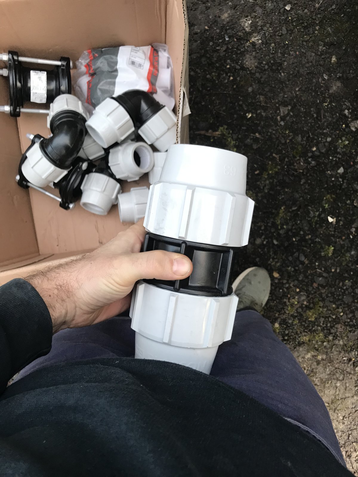

I’ve just dug on a 73mm ish, steel water supply pipe that’s leaking and i’m struggling to find any fittings to repair it.
Philmac UTC’s from my usual place only go upto 59-63mm.
I’m in the North East if that help, wai ai man.
Thanks Nige :)

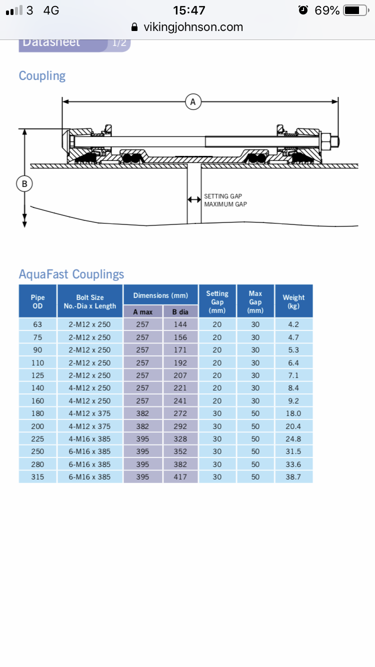

Maybe a 75mm VJ Aquafast? It says it’s for PE pipe but should be good for steel and it must tighten down to 73mm.
Do you agree with my sizing of the pipe:

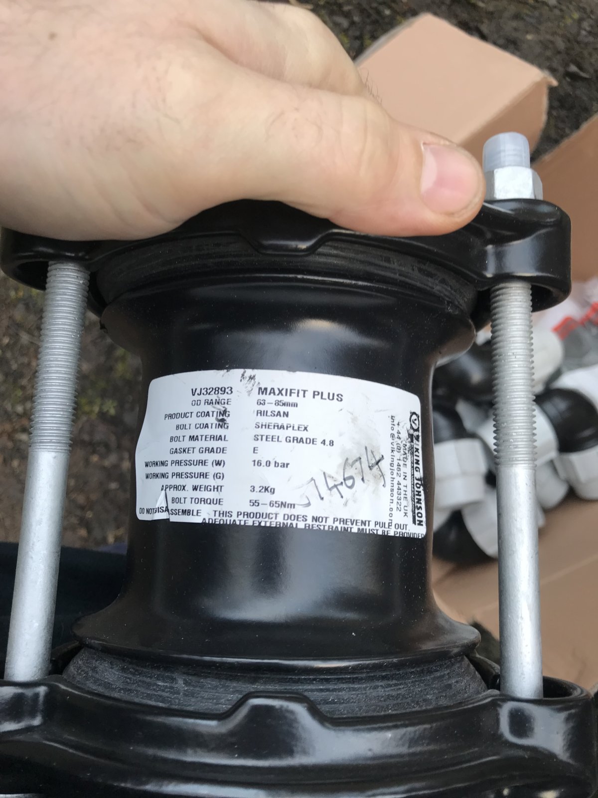

I used these Viking Johnson fittings and 63mm MDPE. They don’t prevent pull out (as I found out before reading the label) so I had to stake the pipe to prevent that.

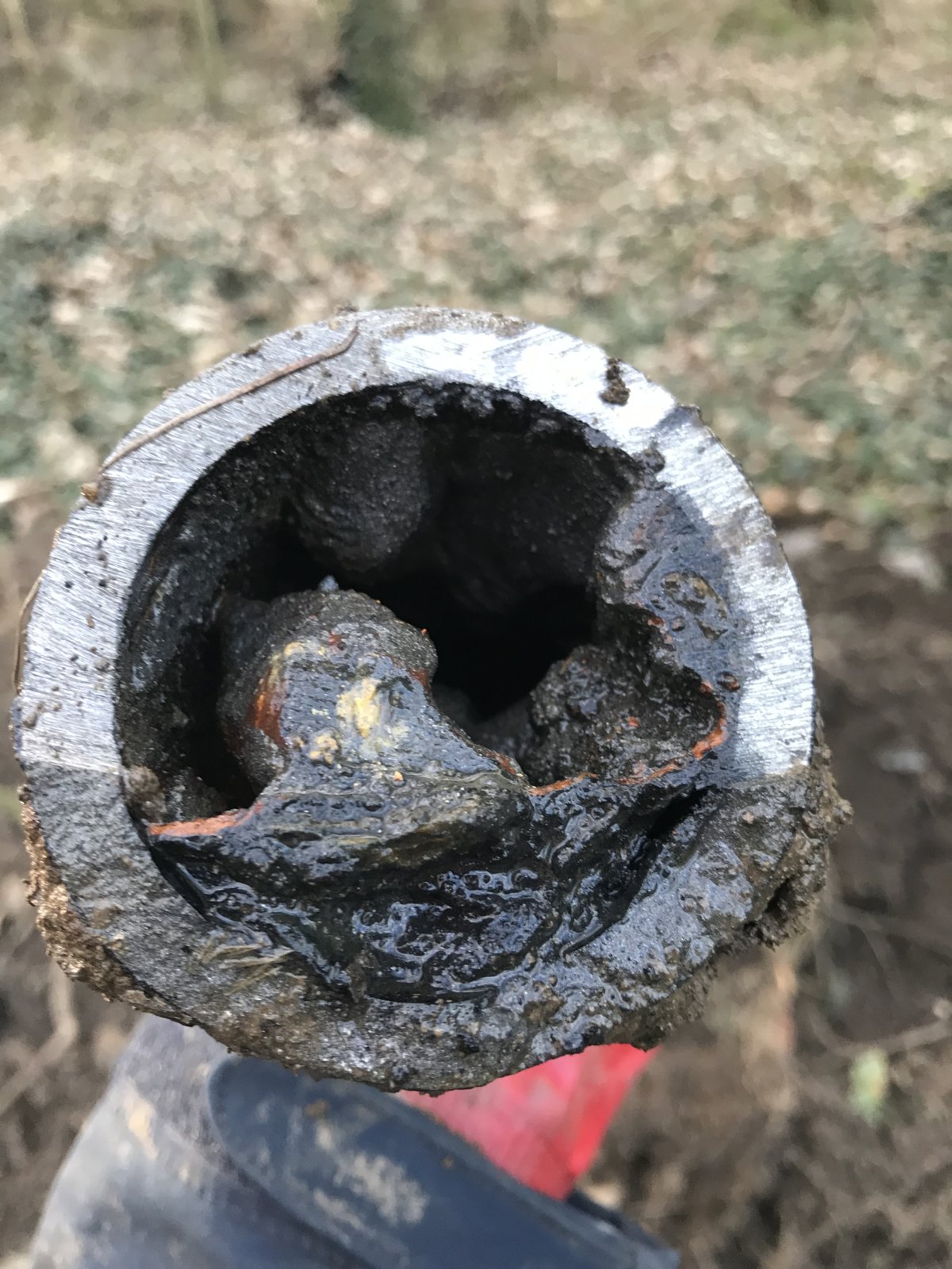

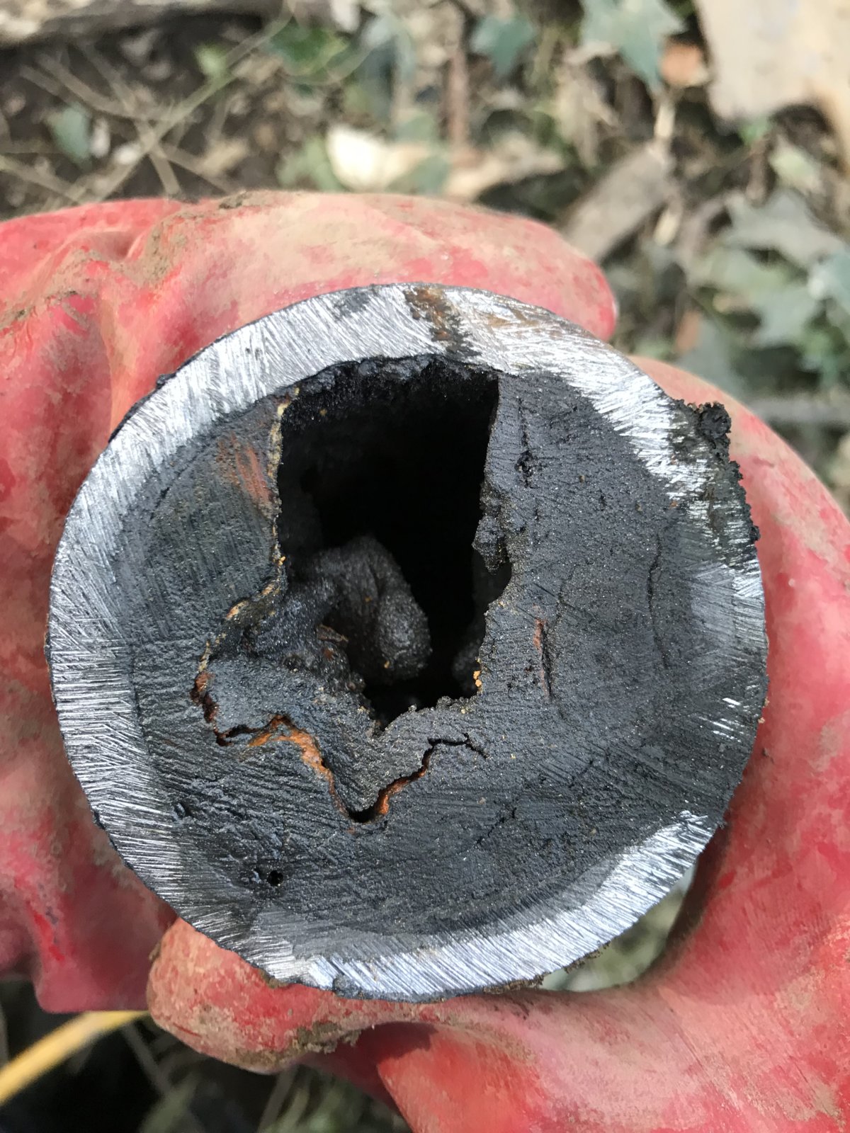

And state on that:
I’d say that requires renewing entirely.
