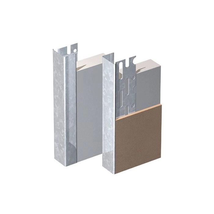

I will say, if your ceiling is original and you have some nice decorative coving - you only need to overboard the centre section, leaving a small shadow gap to the coving.
Edge beading like this can then be used by the plasterer for a neat finish...

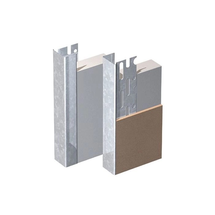

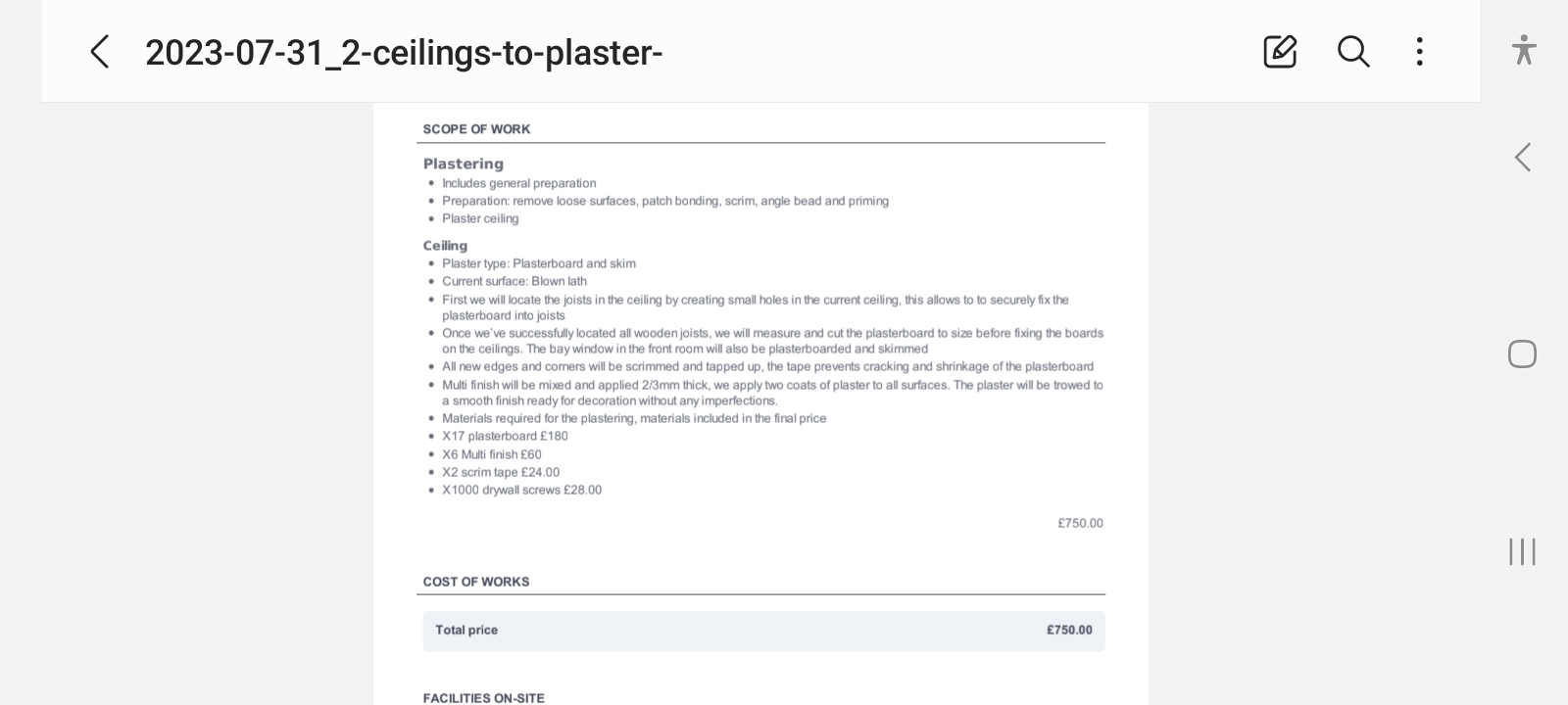

Just hired a guy to remove the blown plaster, pack out from the lath to the level of the original plaster, overboard that and apply 2 coats of plaster.
He's gonna do that, overboard and plaster another (artexed) ceiling upstairs and the same for the ceiling of the understairs cupboard for £750. He starts Wednesday.

Guy told me he'd find the joists. Half the plaster will be off the ceiling anyway so surely he'll just draw a straight line from the exposed lath to find the centres of the joists which are covered in plaster no?
