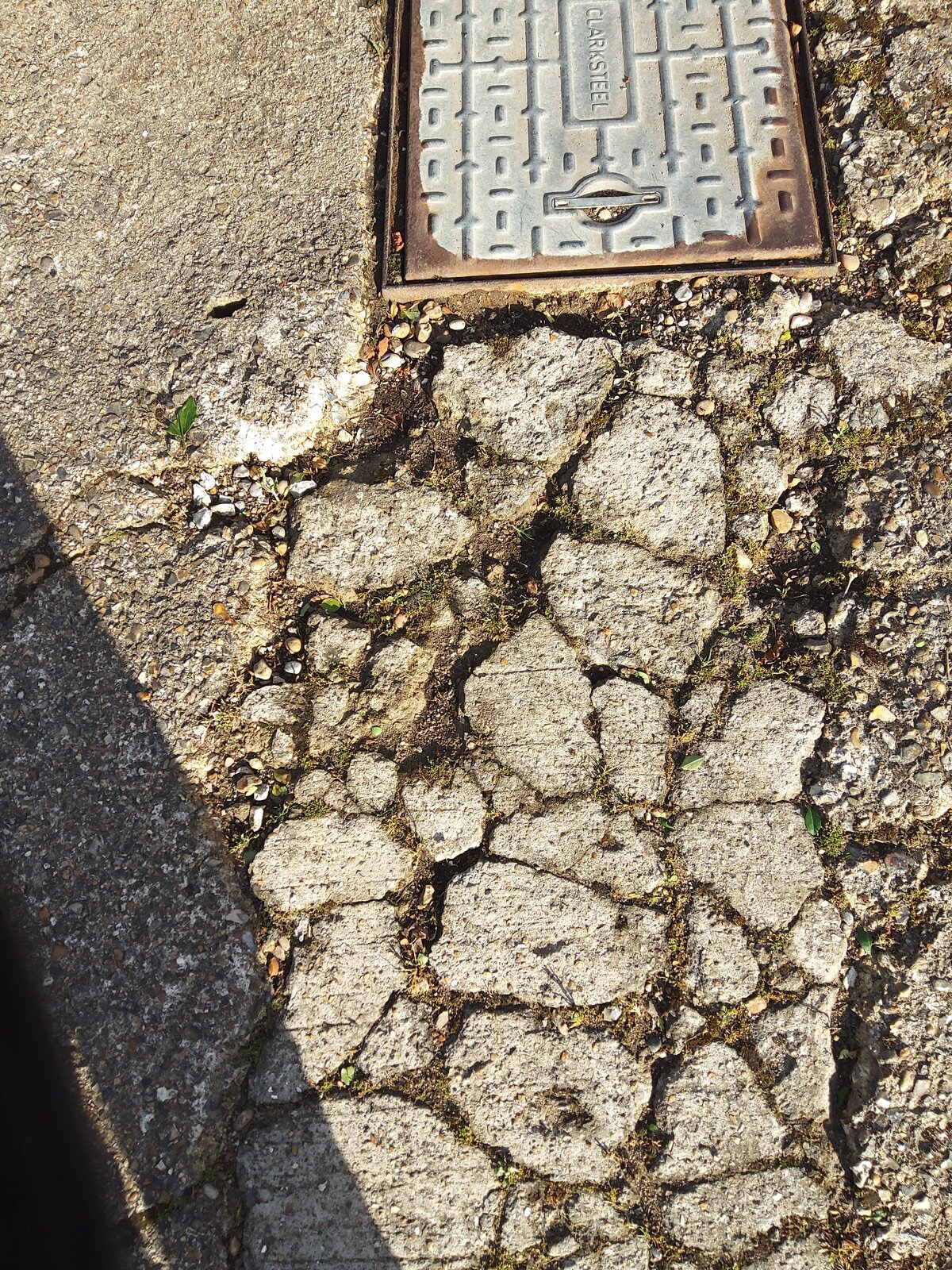

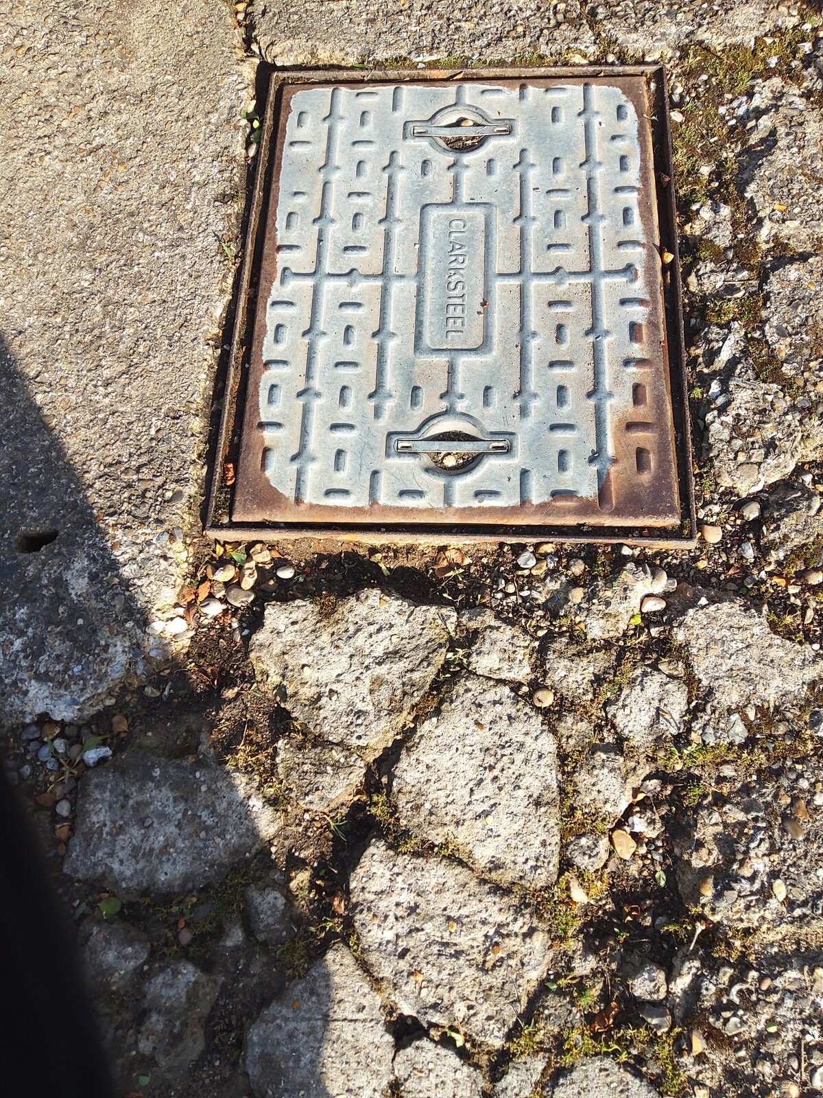

I've offered to help my neighbour tidy up her driveway. I've ordered a new drain cover but many years ago Thames Water did a drain repair and concreted near and around the inspection chamber. This is now in poor condition as vehicles drive over it regularly. She is saving up to have the whole drive renewed but just wants a quick cosmetic fix to last a year or two. Any recommendations for a mix that will do the job? It's a small area so something ready-mixed would be good. I know I'll need to cut out any loose stuff first. 20220526_071256.jpg20220526_071302.jpg
A couple of bags of ballast and a small sack of cement should be good enough for an effective (temporary) repair.
Hi
Quick-drying cement mixed with ballast and before it dries, use some of the old crushed drive bits over the new stuff to make it look like the old stuff.
A few years ago I made temp repairs to a bungalow we rent out to crazy paving where the cement, large bits of it had come loose and several slabs were moving - it was near the front where all of the cars enter and left. I did the repair at my own pace over two half days, the new people moved in a couple of days later and still good three years on - I crushed some of the old suff and put it on the top to match the old stuff.
