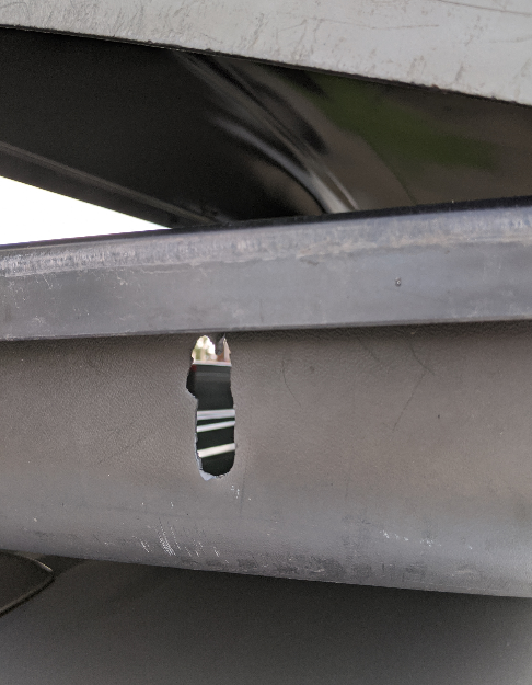

I've borrowed a roof box and have managed to break the arm at the back which holds up the lid. Not sure how I broke it, I was super-careful with it as it's not mine, but broken it is. I attach some photos to show the damage, and would appreciate thoughts on how to repair it or what sort of tradesman I can take it to to fix it. I'd rather pay someone to do it I think. I am thinking of attaching a metal plate over the break and some sort of rivet to attach the arm to that plate - does that sound right, and if so, where might I take it for someone to do that properly?!

Bit of a difficult one to make beautiful Nick, but you're right you need to over plate the hole with some aluminium sheet and secure that with pop rivets - those rising stays are quite powerful.
You could plate the inside too before securing the stay bracket....it could depend on what thickness ally you had available.
Not a difficult repair which would be stronger than original - but I guess that's up to the owner!

I think you are going over board a bit with the material thickness - 3mm is bar rather than sheet, and won't follow the curvature of the box - if it has any. 1mm would be fine if you are using it as a sandwich.
I'd go for 4.8mm rivets (5mm hole), say 10mm long.

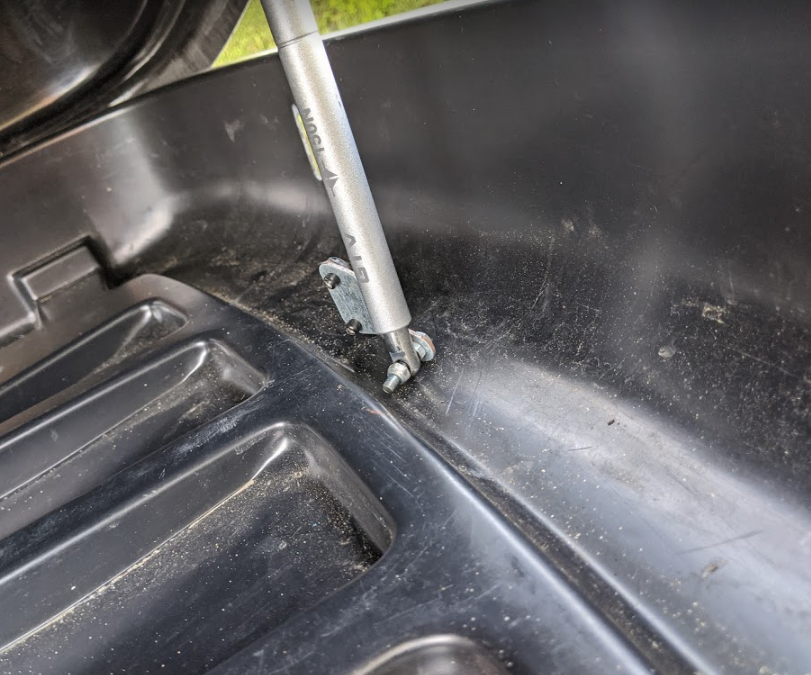

ABS takes to being glued exceptionally well. I would repair the broken part, make good cosmetically and then move the strut slightly. Also you can make ABS paste using Lego and nail polish remover (if you have no Lego, rear lights on cars are normally ABS) the paste can be used as a filler or to thicken the repair area if required. It is easy to test if it is ABS too, apply nail polish remover to a cotton wool pad and rub it on an area not normally seen. ABS will get a sticky surface straight away, other plastics won't react.
..............You can also buy solvent weld pipe to use as a filler/thickener or to make a paste with if you prove the box to be made of ABS
Drill out rivets and patch hole with fibre glass then refit bracket with large washers or a metal plate to out side to strengthen repair.Simple repair.
Get some spreader plates for both internal and external. Drill them off. Apply some from of sealant under both plates.
Then fasten all together. I wouldn't use pop rivets. I'd get some m3/m4 stainless flange dome head bolts and nylock nuts.
If you haven't got the correct grip length rivet you can do more damage than good, or not have it securely fixed.
With the nut and bolt you can feel the materials grip and tighten according to the 'feel' of it.

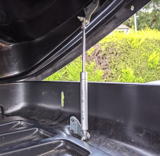

So this did actually get fixed - thanks for the help. At the last minute I myself decided on the course of action that Domdee sets out- it's not my roof box so wanted the owner to be able to undo it himself easily if needed (he's handy). I was looking forward to using the rivet gun, but have two other projects that call for it too so it won't go to waste. It went quite well. A bit of a messy fix, but it's solid enough and won't break. To be honest the plastic fixed well enough to support the arm alone, but put plates on anyway to be sure:
