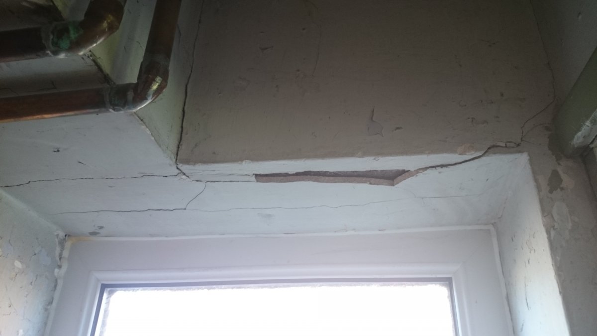

Firstly, I have this loose part of plaster in the window arch. It's not all loose, only a chunk near the already present missing piece of plaster. My intention was to remove the loose plaster to a put it is solid, clean and pva the surface, and fill in to a rough finish, and then put some beading on for a skim. I'm just wondering at this stage does that sound workable?

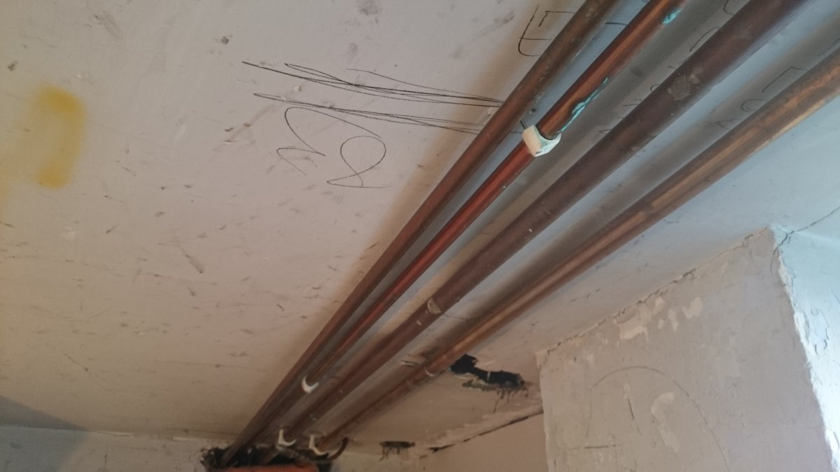

Second, pipework and a terrible little hole in the wall. My problem here is loose piping (audible clunk when washing machine is on), which I want to fix onto the drywall/plaster ceiling, before boxing over it with some, er boxy type stuff. Also, the hole which has cunningly been filled in with a nice paint roller to support the pipes/plug a hole. Here, I was thinking fill in the large gap with foam filler to support the pipes some more, and patch it up with a bit of plaster?

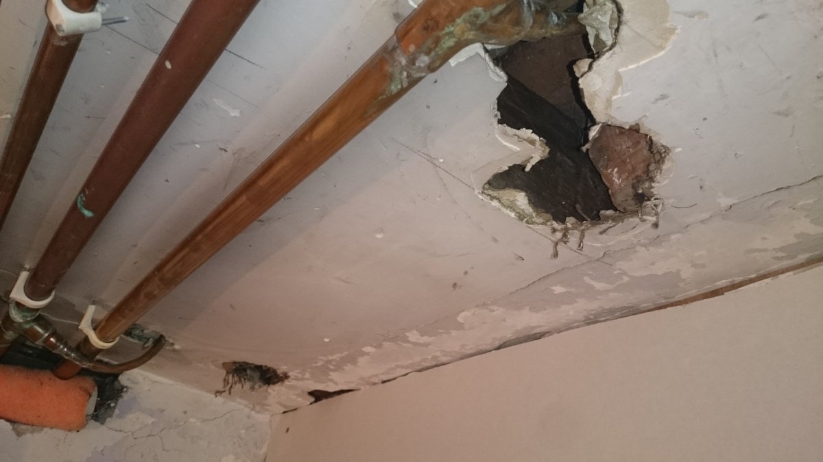

Lastly, a couple of holes in the ceiling. In all honesty, I'm considering just taking the boxing across and simply covering the holes with the same materials I use to cover the pipes. Having just wrote that, I've alerted myself to the weight of boxing on the ceiling materials, with wood being too heavy potentially?

you say the rest of the plaster is sound, but to me it looks like there is more that has come away. Break out any more loose stuff, PVA and fill with bonding , then skim over.
The hole where the pipes go through I would fill with expanding foam and skim over.
As you suggest I would box the pipes right back to the wall, it will look better anyway.
I would be inclined to batten the ceiling out and around the pipes and box with plasterboard and skim over.
If you have enough height in the widow frame in the first picture I would be inclined to carry the boxing around the pipe work into the window reveal too and also up the wall above the window, beading all corners as usual before skimming

I like that idea got a load of plasterboard sitting around. Thank you!
