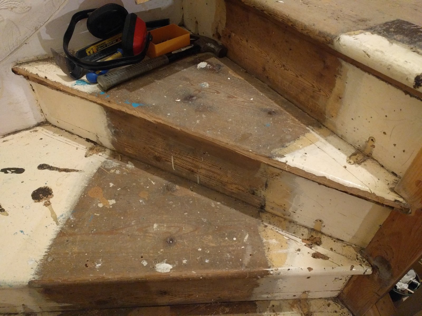

Repairing hacked off stair nosing
26 Aug 2016
6,830
1,009
Lifted the laminate found this hacked off nosing. All other treads are fine
How do I repair?
We will be laying carpet in the long run.
Thanks in advance!

If you've got a router and a circular saw then get a chunk of timber same thickness as the tread, rout the front edge to give you the bullnose, cut the front edge off (so you end up with about 25mm or whatever you need for the tread to project the right amount), screw and glue it to the tread. Or don't bother, carpet will hide the difference.....

Mostly worried that the carpet will be damaged by the edge. Sounds with a go, shall I use the circular saw to tidy up the rough edge first? Or the router? How can I make sure the edges match up properly between the new timber and existing?
what ever you use you will need to use a oscillating saw and or chisel to finish any cut you do close to the string so maybe nail a baton and use an oscillating saw along the front face full length anyway just cut the bullnose first and set the baton up accordingly
if your routering a bull nose it needs to be on a plane plank as you cant router up to a closed edge in situ

my advice
cut it off parallel at a point in front off the rebate under the nosing if possible to avoid the need to rebate the new section
cut off the nosing about 3" longer than you think it needs to initially from the new bit
clean out the housing in the string side for the nosing to go into
just clean it to the face off the newel on that side as there is far less supporting that side off the tread
leave it long and angle to fit neatly in the string side
you should be over length by about an inch or more now
shape the newel end to fit the profile [return end curve] as this will show you have plenty off meat so just go for a good look but a bit long
trim from the string end to get to length
are you buying or routering the nose ??
Thanks again, I'll just router a nosing if I can manage as I have the machine already from fitting the hob.
Would Pu glue be ok and screw it on once I get it to the right size, or normal white wood glue? I have both in stock.
if its a good fit use normal wood glue if many deviations pu and tape underneath
choose a slightly smaller roundover bit than the radius as you need between 1 and 3mm for the bearing to run on
if you use the exact size you may get a very small step
curve a nose on one end using a sander so when you router it its the correct profile for the visible end
