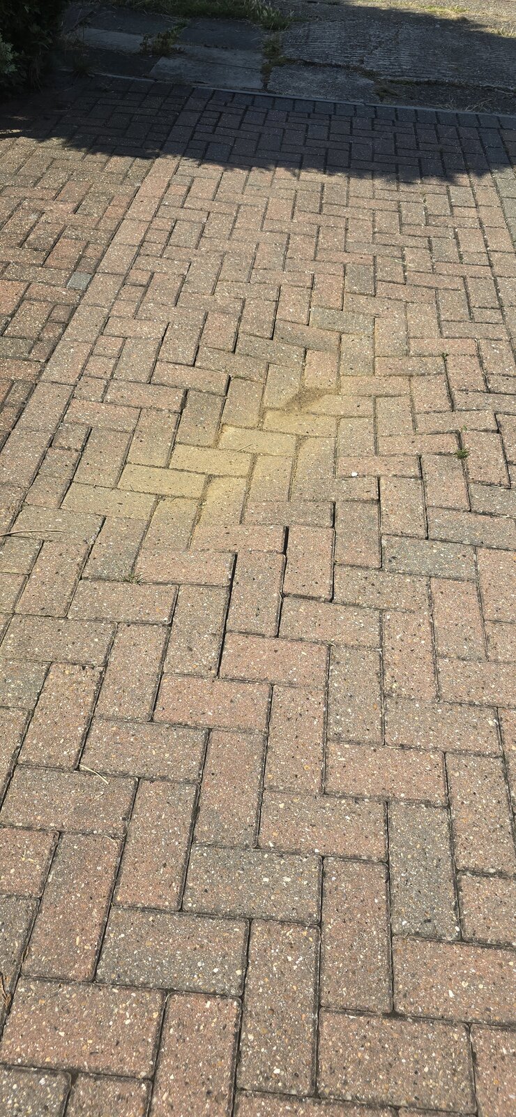

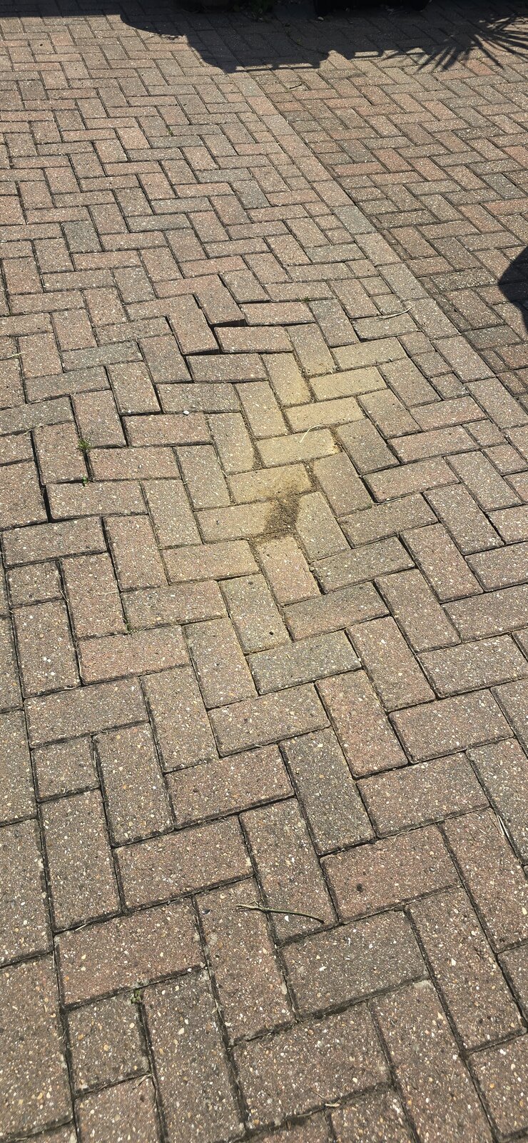

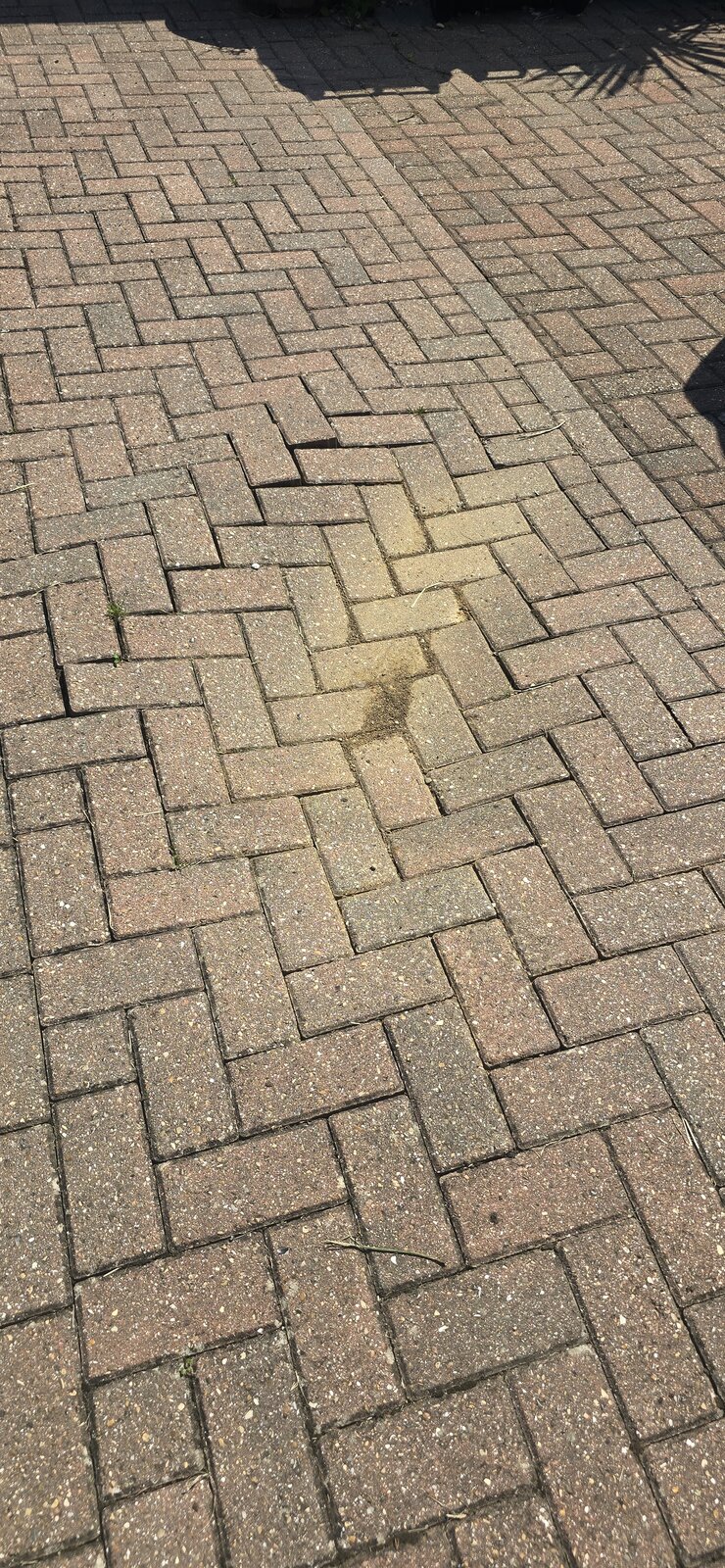

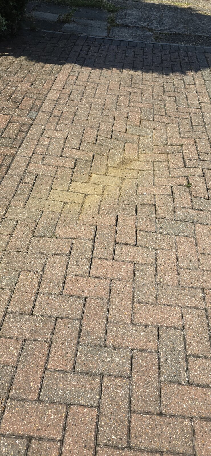

Good morning .
Some of my driveway block paving is sinking.
Any advice on how I can lift them and relevel please?
Do I need concrete too?
Just lift blocks. Fill and replace them.
I have similar problems with slabs that sink. Ground is wet I guess
Kill that ants nest under the blocks, thats what is dragging the sand out, then re level with sand and tap home.
What tool can I buy to lift the slabs?
It's a fiddly one. There isn't a tool, but we use a pair of pointing trowels to get the first block out, then a pick or a brick hammer to ease the others out.
You'll need to remove as much of the fill material out of a single paviour joint. Once you can push a trowel in there, you should be able to wriggle the first block out.
Start on a convex paviour and not a sunken (concave) one.
Once you get the first one out its easier getting the rest out, you need a straight length of timber 6 foot will do looking at your pictures and a lump hammer or a rubber mallet.
