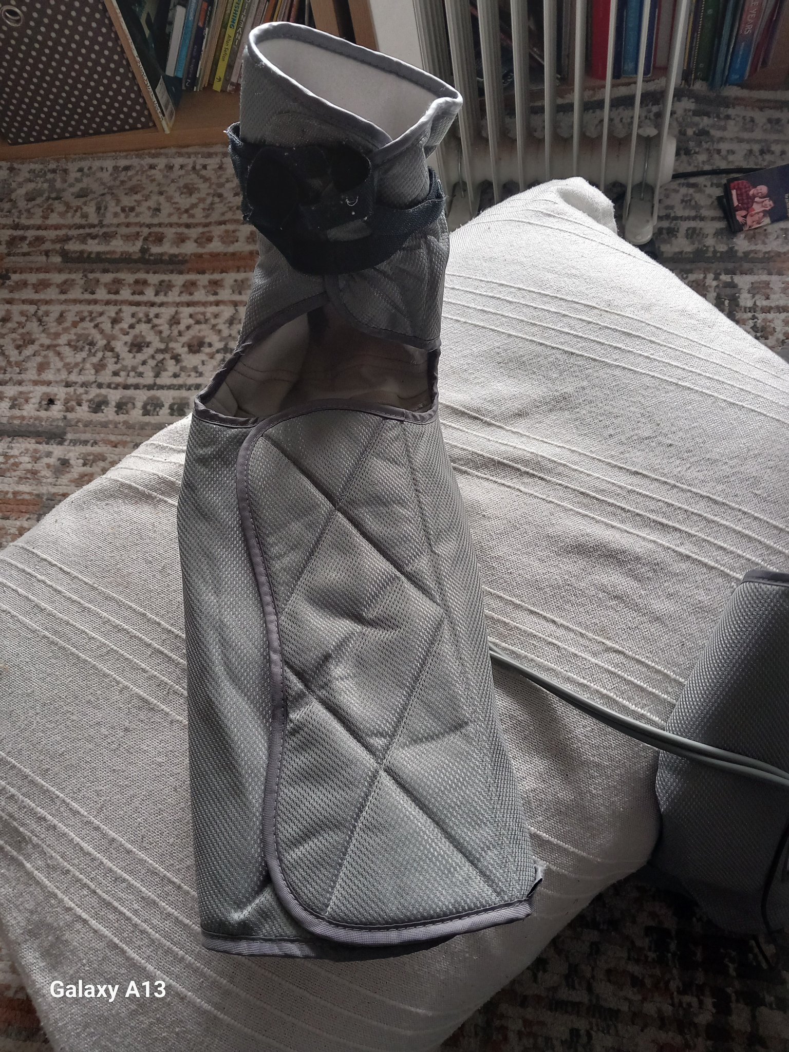

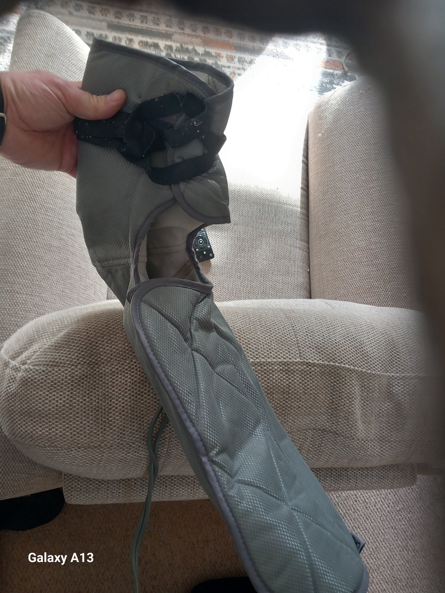

I got a kwg massager where velcro doesn't hold. New velcro or hook?

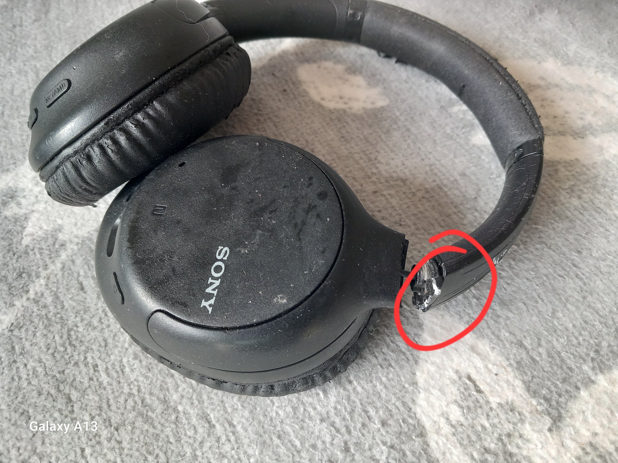

Head phones where a small bit of plastic has snapped- araldite?

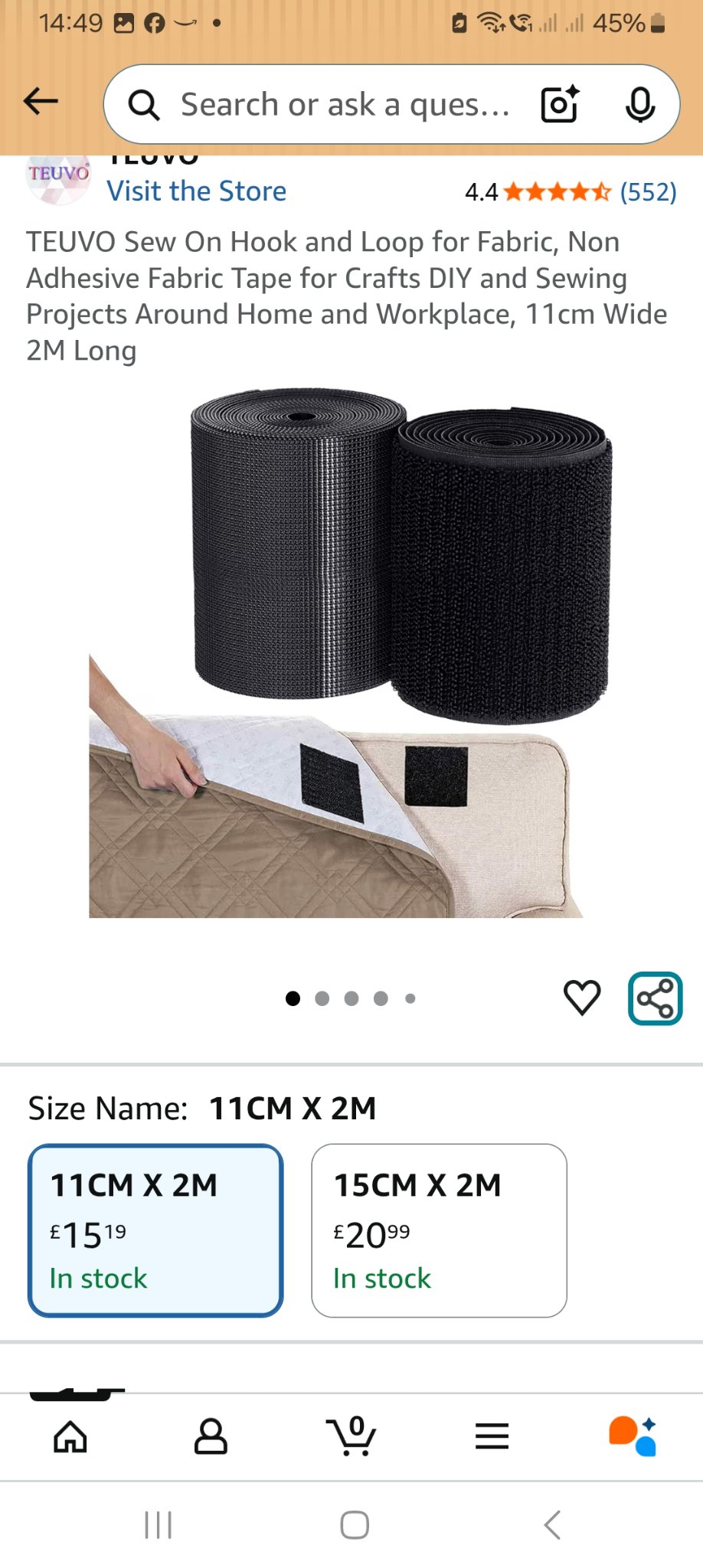

You can buy velcro and cut to width and length off eBay and use fabric glue to stick. Then a few stitches so it never moves...
Anything plastic is very difficult to mend. Plastic can't be glued with any strength but you can buy a heater for wire and melt a joint.
This is overly simplistic and objectively untrue; for example the PVC handle on my vacuum cleaner glued very well using solvent pipe cement
It massively depends on the plastic. Thermosets may respond well to glueing but which is the best glue will vary depending on the type of plastic. Thermosoftening plastic variants typically respond well to welding with a compatible material
There is no one thing called “plastic”, so no one answer fits all
Keitai for your Velcro I would replace it as suggested. For the headphones I’d probably brace the joint with a shaped metal plate, carefully screwed on with small screws, like what the hospital would do if you smashed a bone..

I second the use of solvent glue, it melts the plastic and forms a strong bond (according to the blurb).
It's in my 3D printing plastic glue box for occasional use.
You can but try :)
Wish people would stop talking about plastic like it’s just one thing
Examples of plastics that solvent weld works well on: PVC, ABS
Examples of plastics that solvent weld does not work on: HDPE, LDPE, PP, PTFE, POM, PA, PC, PET, PBT, TPE, TPU
If you want to assess whether it will work for you, dab a small amount onto the work item somewhere inconspicuous, wait 30s to a minute then gently scratch at the area with a sharp implement. If the glue comes away contaminated with the colour of the plastic then it has successfully dissolved the surface and will work. If it just comes off again the same colour it went on, you need something else
Do a test first; loading up a joint with glue that just won’t work contaminates the joint making it harder to use a glue that will work
