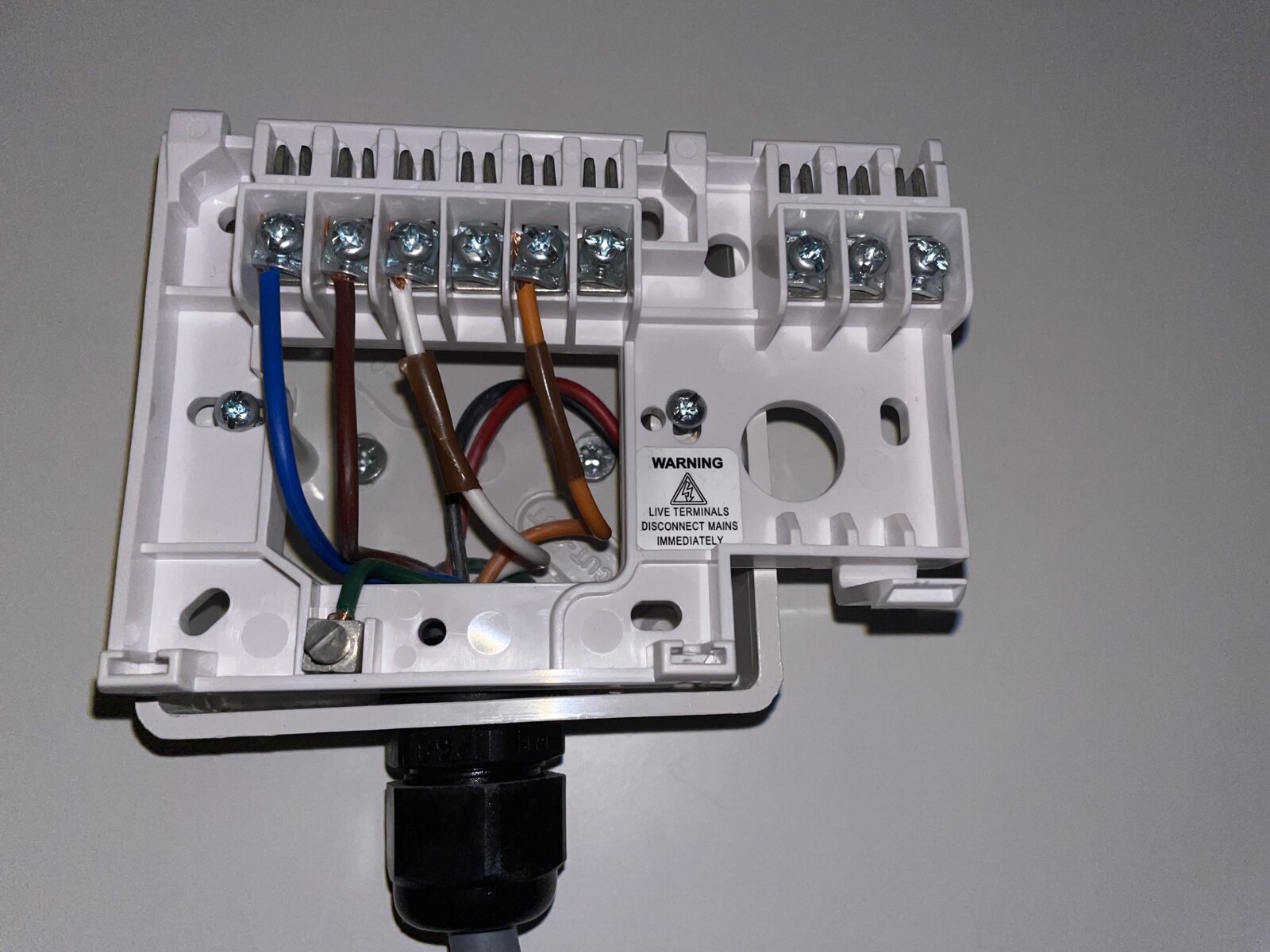

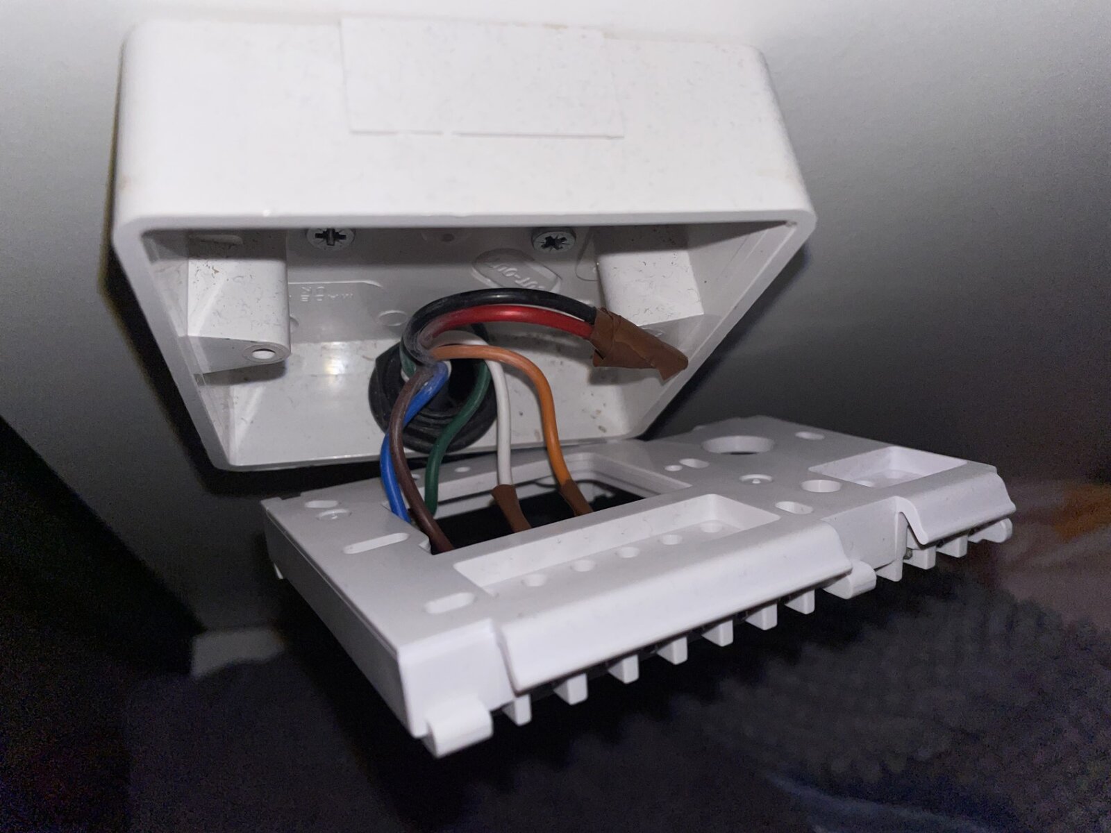

Photos show back plate and unused wires of current setup.
As ever - your expert advice very much appreciated.
The wires with the brown tape are the heating control wires. They should be wired in series with the switch of room thermostat. When the switch inside the room thermostat closes it completes the circuit and turns the heating on.
Sorry, I've never seen a AWOW Smart Thermostat. I'm assuming it will have instructions, so you will have to work out where they go at that end. I guess it will also need a 230V supply to provide it with operating power.

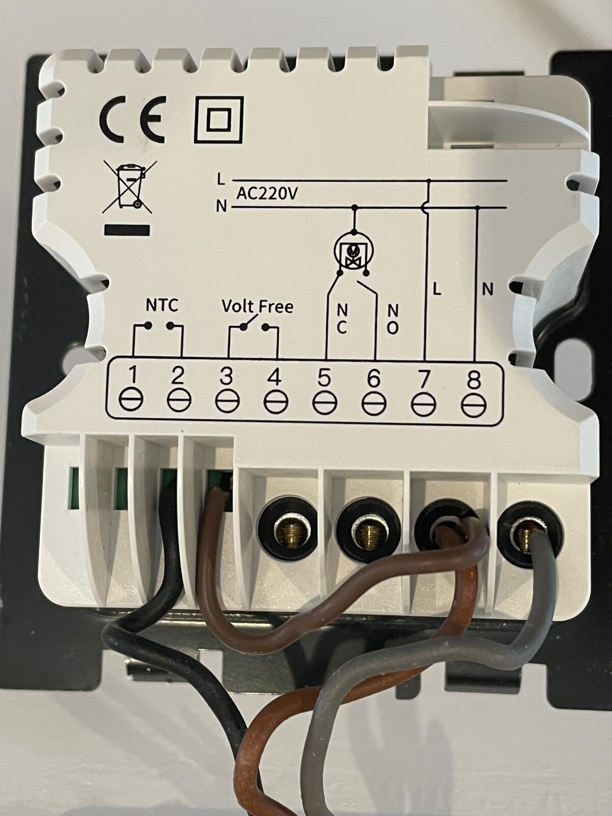

The AWOW is as below - I have one in my place.
3 and 4 would correspond with the two terminals I show. Even the symbol is the same. :giggle:
But the problem will be that when the timeswitch switches off, then the Live to the thermostat which comes via the link wire between 7 & 4 will be lost too, so a separate permanent L is also required to keep the thermostat powered.
However, is the AWOW just a thermostat? or does it include time control functions as well? If it does, then there's no need for a programmer as well and it can be left permanently on 24/7 to keep the thermostat powered.
Thanks - understood.
I have my heating on permanently and operate it from the thermostat only.
The app allows timings to be set (weekdays/Sat/Sun) so there's full control via the thermostat/app. The controller I plan to use is there as a back up only - in case the thermostat or app failed and it needed to be replaced quickly with something manual.
