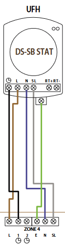

I'm looking to replace the analogue Siemens RAA21 thermostats currently installed in my flat with Moes Smart Thermostats. I am hoping someone here can guide me which would be the correct Moes variant I should purchase and also how they should be wired.
Some further detail...
These Siemens thermostats control the underfloor heating system. A number of these are fitted in various rooms/zones. When the setting increases beyond a certain point, it makes a click sound and I can see that the underfloor heating system is then activated. The underfloor heating system uses the Emmeti EWC-2 8 WAY WIRING CENTRE as its connection box.
Below are pictures of how the existing thermostats are wired:
and this is its official wiring guide:

My hunch is that I instead need the 'GC - Gas Boiler Heating' instead as that involves a dry contact
Yes, it would be the GC version you would want.
If you can show us a picture of the wires within the wiring centre, we may be able suggest how to connect them up.
However, you are likely to need a 3 core and earth cable run between the wiring centre and each stat, in order to obtain the neutral to power it.

Each of the stats is right beside a regular light switch, and those include a neutral wire. So was thinking I could get the neutral from there...
I'm afraid borrowing a neutral in that way isn't allowed.
The power for the stat should ideally come from the heating circuit alone, that enables a single point of isolation for anyone working on the circuit.
Borrowing a neutral could also cause nuisance trips of the RCD/RCBO within the consumer unit.

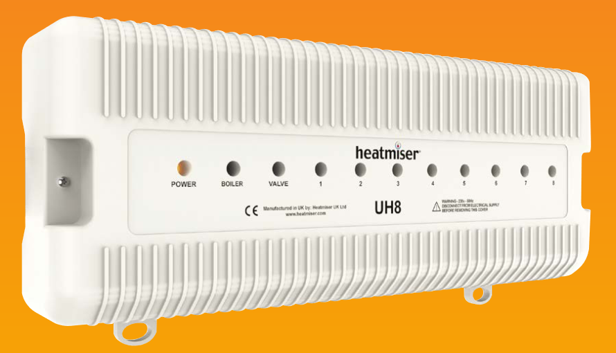

I would assume controlled with a unit like this 1727713738619.png each thermostat will connect to the wiring centre some thing like this 1727714025750.png which has first two wires control, second two power the thermostat, not used with your version, and last is an earth? In which case the GC variant. But the thermostat has two different jobs. One open the motorised valve 1727714281566.pngor actuator, and the other to fire the boiler, so some where there needs to be a wiring centre or other device to allow it to do both.
The normal or traditional motorised valve 1727714520202.pnghas a micro switch in the valve, where the under floor heating wiring centre has a load of relays inside the wiring centre. Both shown at 230 volt AC digital i.e. On/Off units, however there is nothing to stop an analogue unit from being used, slowly opening and closing, which would be a far better control method.
Oil boilers tend to switch on/off, gas boilers tend to modulate first, so a 28 kW boiler will slowly modulate down to say 6 kW and after that point it can't turn down any more so uses mark/space (on/off) control.
If the boiler can modulate, turning it on/off instead of up/down stops it working efficiently, it will work, but it will not gain the latent heat from the flue gases as designed to do.
In real terms true analogue control is rare, it is just a series of steps, so with 20 heat output areas, you have 20 steps even if each area turns on/off, but with 2 areas the steps would be too great, with radiators we use TRV's which have electrical or wax or bellows which are reasonably analogue. However unless linked to a hub or wall thermostat they have no method to turn boiler on/off, so the boiler would continue cycling even on a warm day, so some where it needs some method to turn the boiler on if days is cool, and off if days is warm.
You need some thing similar with under floor heating, and in the main the wiring centre does that job. And we have no idea what wiring centre you have, with radiators the buzz word is recovery time, or how long it takes to heat the room from eco setting to comfort setting, without over shooting, there have been many attempts to improve this, with TRV heads with algorithms built into them.

Thank you missed that so this is the thermostat 1727718292507.pngso 6 core cable, do like the idea of a "Night Set Back mode" however this
does not seem to relate any way to the diagram. Clearly some botch up. Under floor heating only on the boilers output can have one pump, as boiler set to around 30ºC, but if also running radiators or DHW often two pumps, so circulated water in the UFH is 30ºC but the DHW heated to 65ºC.
So still we have no idea how its been cobbled together, or what @ratulb is trying to do by changing the thermostat.
Definitely not a botch.
If you read note 1, without a timeswtch, TL and C should be linked.
With a mechanical stat, there is no need for TN.
NC is unused and NSB is optional.
Only a line and switched line is necessary.
The only botch is the unsleeved blue.
