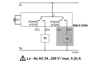

Hi, I accidentally bought a Moes Water heating thermostat (GA) instead of a gas boiler thermostat (GC).
However, it looks like I could use it for the same purpose according to this diagram:

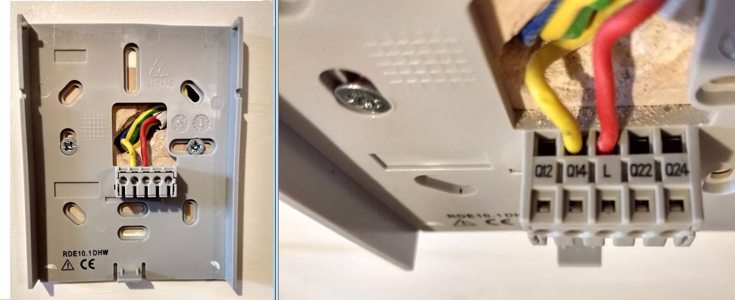

My present thermostat only controls room temperature via a siemens rde thermostat (see attachments). If the diagram referenced in the post is correct, I should be able to put the "Q14" wire to terminal 2 and the live will be routed to the load internally. Can anyone confirm this for me?
