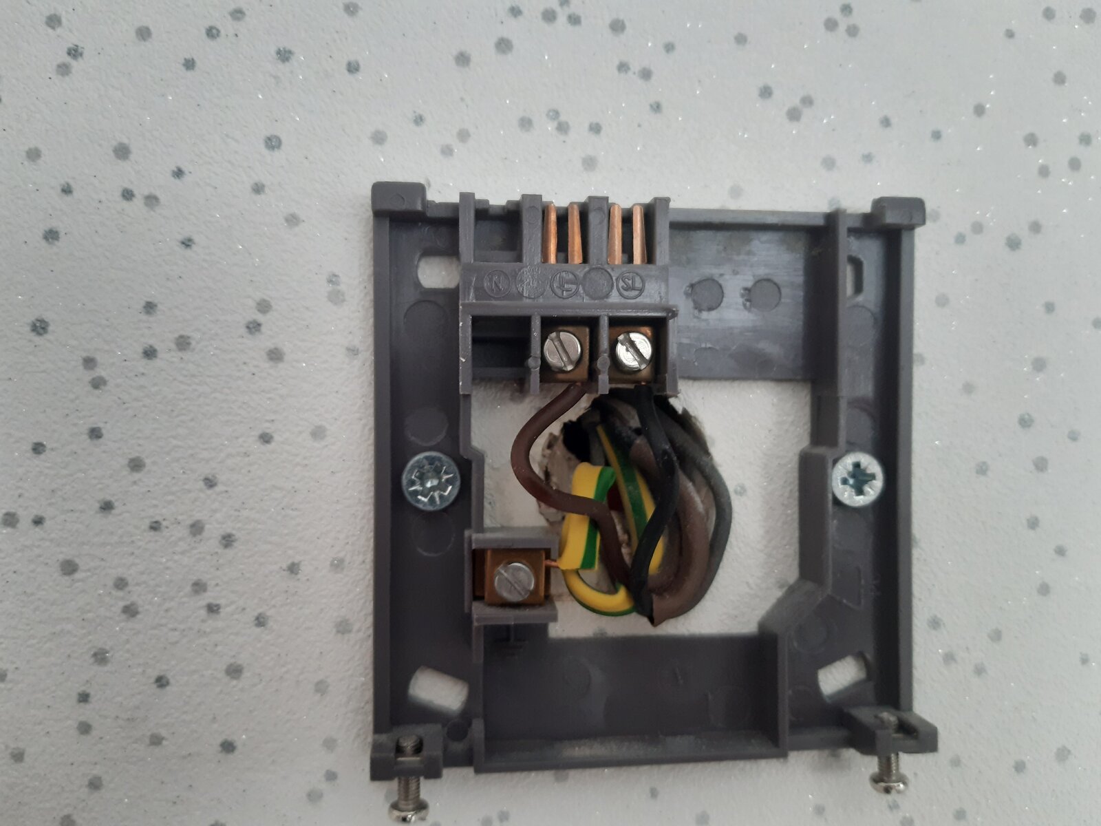

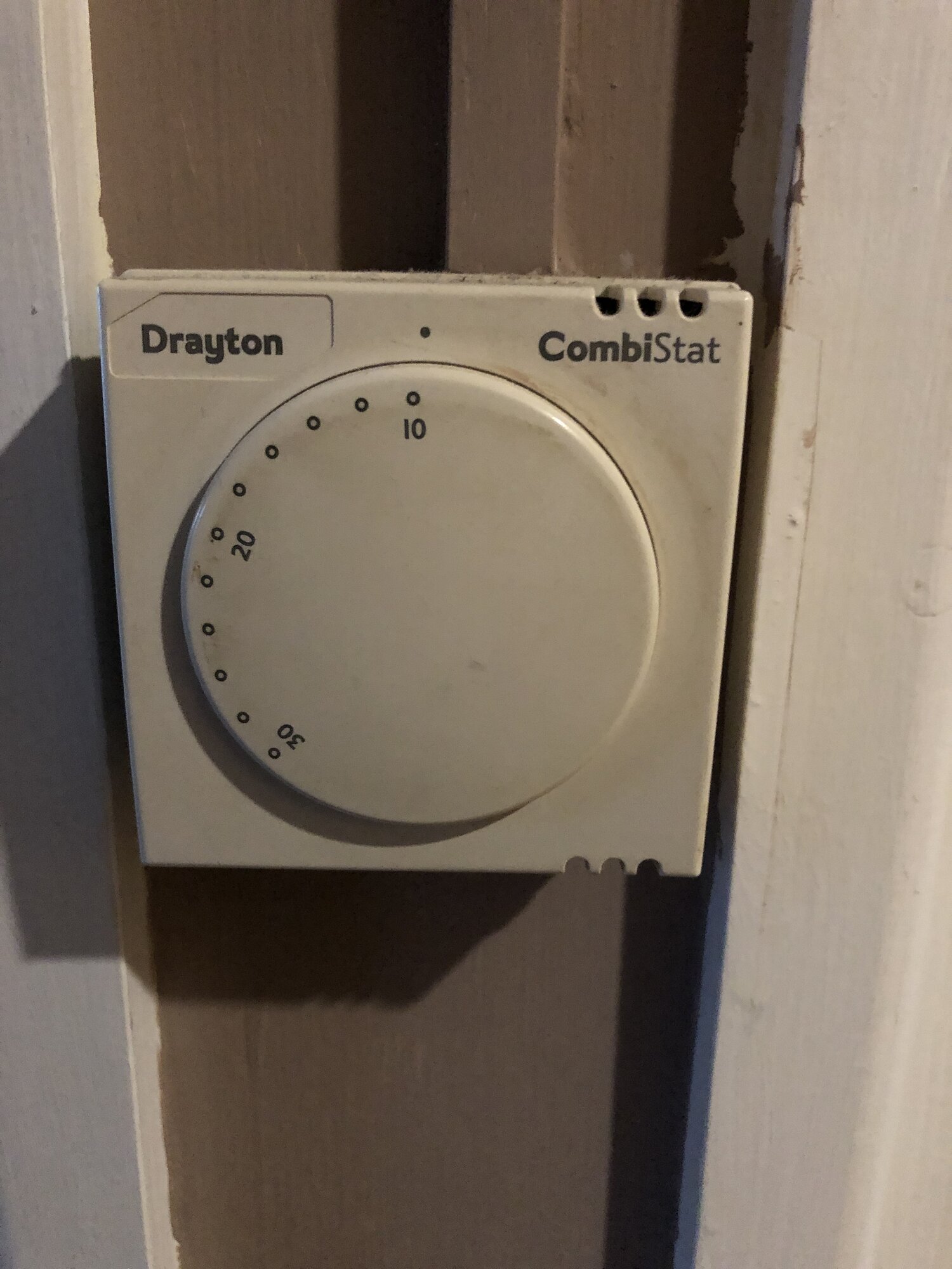

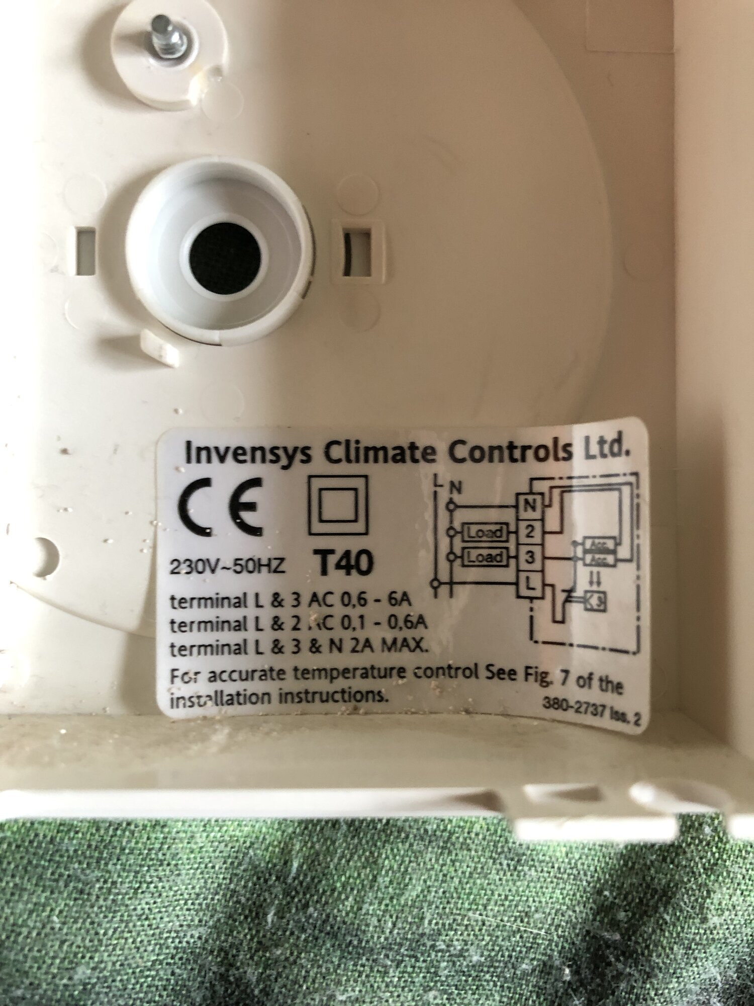

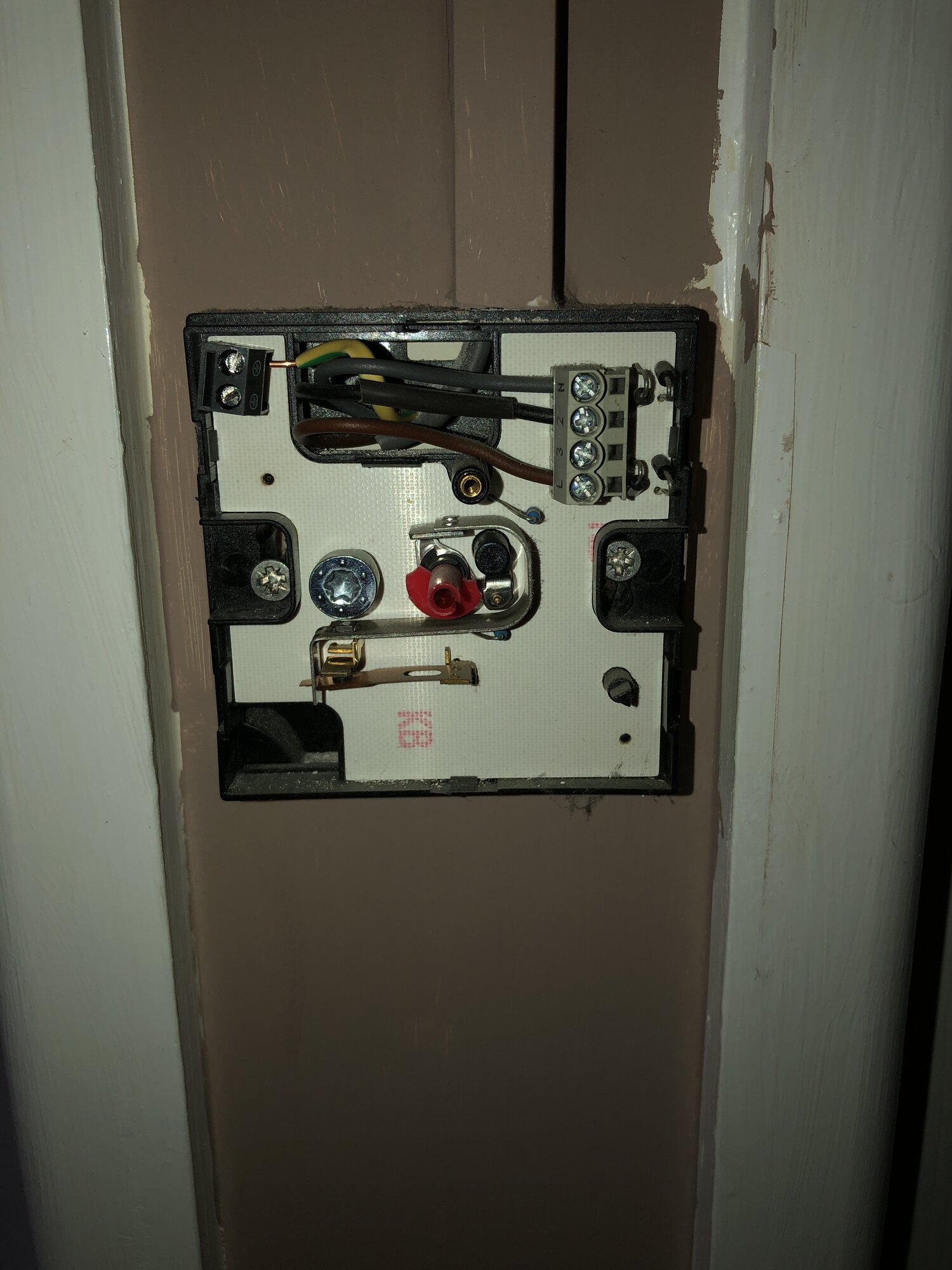

Hi Guys,
I'm looking at replacing my Drayton Combi Stat with a Moes smart thermostat. (The GC model for central heating boilers)
As you can see from the pics, I only have 3 wires going to the existing thermostat. The Moes needs 4. I'm pretty sure what to do here with a bit of research, however I just wanted confirmation from someone who knows or has fitted these before. (Ignore the bad paintwork... will be fixing that too!)
Any advice would be gratefully appreciated!
Thank You!

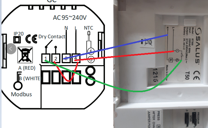

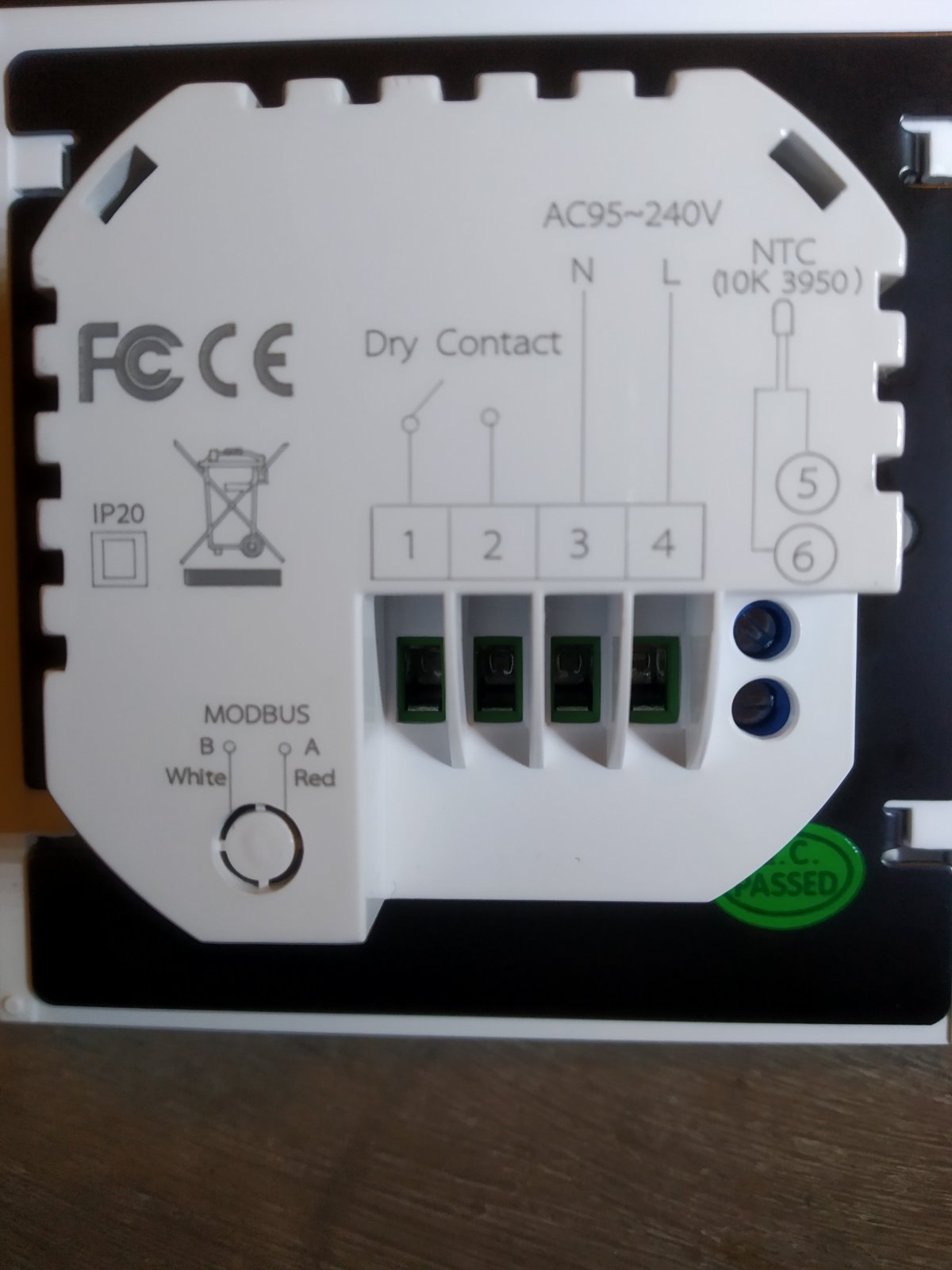

Yes. Connect up the wires as follows
OLD>NEW
L. > 4
N. > 3
2. > 2
then put a wire link between 4 and 1
The thermostat looks like it is really meant as an underfloor heating stat requiring a temperature probe in the floor. You won’t have one, so make sure you select room only as the temperature source.
OLD>NEW
L. > 4
N. > 3
2. > 2
Thank you..... yes this is pretty much what I thought. Just wanted verification from an expert. I have seen the same unit wired with the live linked to pin 2..... I'm guessing that because this is a switch it doesnt matter which way pins 1 and 2 are wired?
It doesn’t matter functionally. It’s normal convention for the live to connect to the centre. ie pin1 in the Moes.
Arrived and wired as you said! Perfect! Thank you!

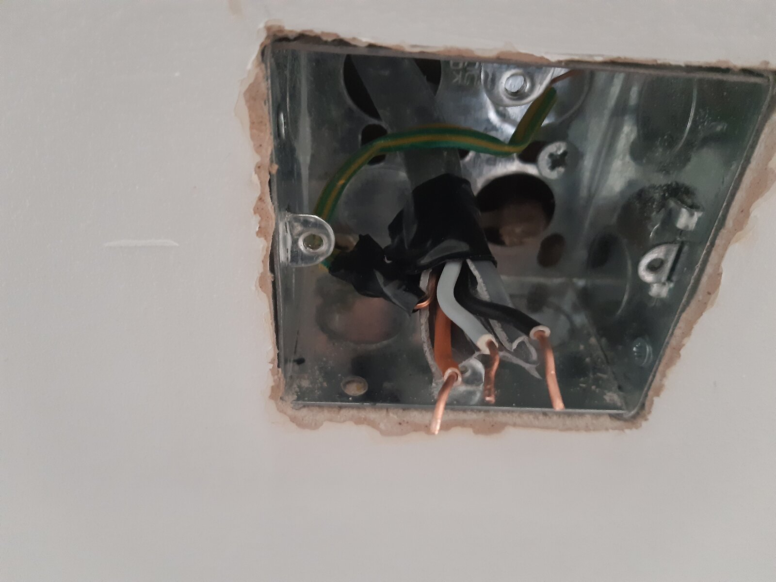

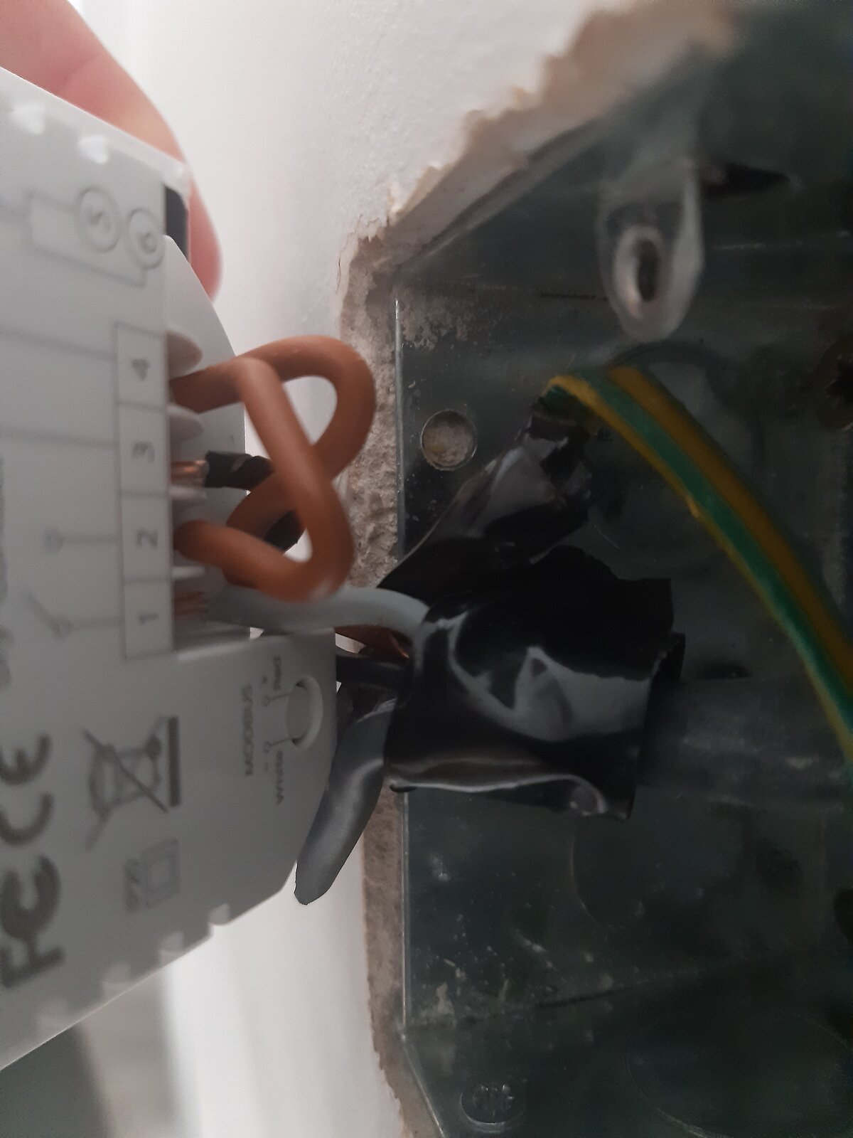

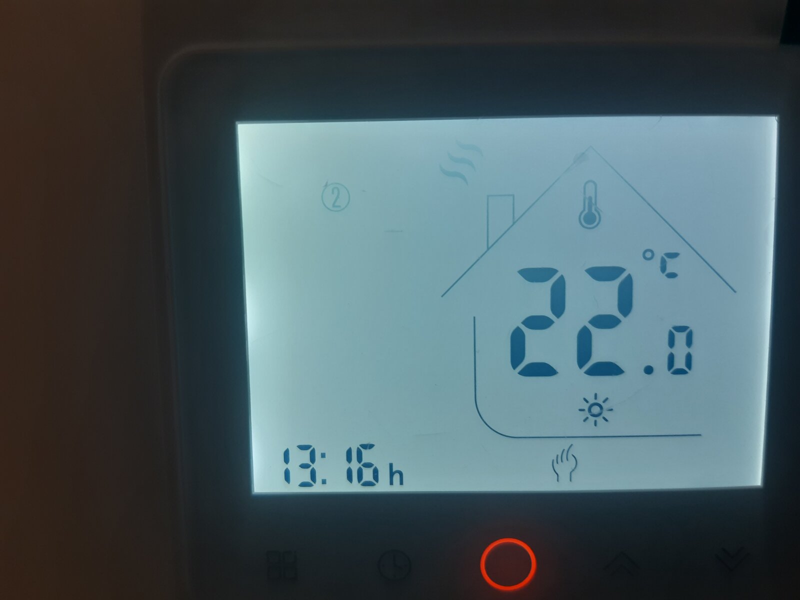

Hello, I don't want to open a new topic , I just have a similar problem, I received many solutions from the manufacturer but my heating does not w turn on. Adds a few photos how my old thermostat was connected, what my connection looks like, I also tried a solution with 4-1 but nothing too. Maybe I have to set something on the boiler, I have two thermostats at home. I will be grateful for your help

As far as I am aware only the Nest e smart thermostat will work without the neutral. But most the old bi-metal thermostats the neutral was only to reduce the hysteresis and they would work without it. Some were used on the 24 volt control so the neutral was simply not there.
Seems likely missing neutral, but only you can test.
Thank you , one wire was hidden in the wall because it was not needed for the old thermostat.
I have to open the boilers and check how the wires come out from it exactly because the manufacturer says that you must work with my boilers and the wires that I presented to them.
Yes, but they may assume that the hidden wire (possibly the neutral) has been connected properly and that it is connected to a neutral at the boiler/programmer/wiring centre.
I think so too, and I don't think boiler is a problem, but I'm looking for a solution, I know the basics of electronics, but I'm not a specialist.
I only have a power on my Thermostat when black is connected as neutral in the old one it was connected as SL , what I want to say that any other configuration prevents the thermostat from working.
