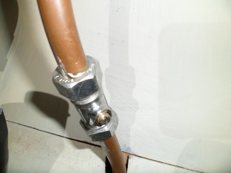

I would like to replace my bathroom sink taps. I have purchased the taps and all of the tools I might require.
The taps are a standard brass 1/2" fitting. I have 15mm copper pipe coming from an isolation valve as seen here;
It then goes up to the tap as seen here;
I would like to fit flexible connectors, I think I need 15mm x 1/2" 10mm bore, 300mm, the toolstation part is 29829 is this correct? Is there a better quality flexible connector I could buy from here?
The part that goes onto the tap just screws on I gather but how do I connect to the isolation valve? Will it come with everything I need?

There is not much a lot of options with regards to quality at ToolStaition, if looking for like for like.
But is the correct component for the task and should be ready to without any other fitting required, it maybe wise to purchase a roll of PTFE or joint compound, to form a leak free joint.
Taps generally come with all the required bits, for them to be fitted safely and securely to the basin.
if you can turn the water off and are able to remove the isolation valve then use one of these - http://www.toolstation.com/shop/Plu...+15mm+x+12+10mm+Bore+300mm/d20/sd2807/p77655.
Otherwise you will have to cut the pipe a couple of inches up from the isolation valve to use for the compression end of the flexi. A pipeslice would be best to cut the pipe with or hacksaw and file the cut smooth
When you tighten the end onto the tap then finger tight and a 'nip up' any more and you can damage the rubber washer.

They can stay where they are. Just cut the pipe and fit the flexis after the isos.
