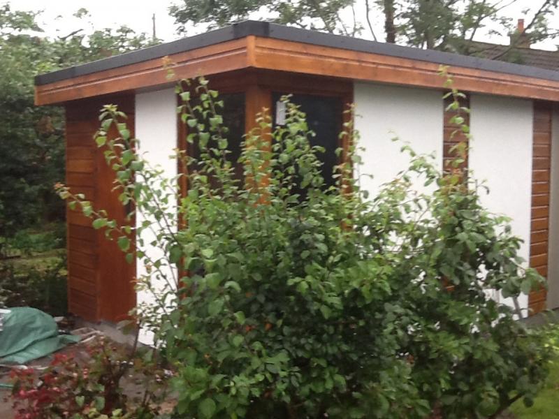

Surprised how much time has passed. Doors are fitted although the garden storage at the back still has a key pad entry to fit. Soffits are nearly done for this I splashed out on marine ply (mad seeing as my facia is pine cladding)

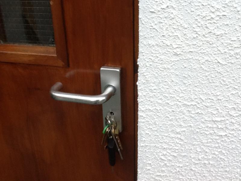

Soffits and doors on although the heavy front one is reclaimed from a refurb but the stain looks a tad naff. Think it needs sanding off and do again.

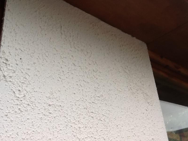

Its straight on roller applied textured render paint. Renotex was the idea I spoke to their rep but it comes at a cost. There are similar cheaper versions by dulux and sandtex. It will be the last thing done probably. I think Renotex quoted £138 + vat for enough to coat all the panels. Mind its all versapanal round the back.

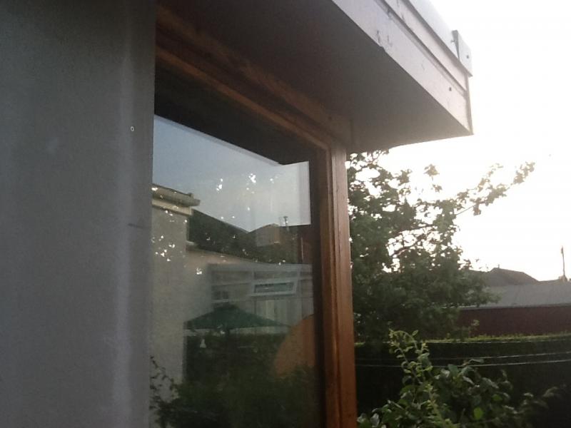

Woohoo full height windows in. Crapped myself with these after one cracking just moving the pane at £250 just for the glass. Both fitted by myself and my star joiner from work. Got the replacement slightly cheaper at £200 but still a heart stopper standing in the garden looking at the crack in the previous one.
Nightmare but now in.
That flippen plastic roof trim is due a piece of bonding. It keeps popping up!

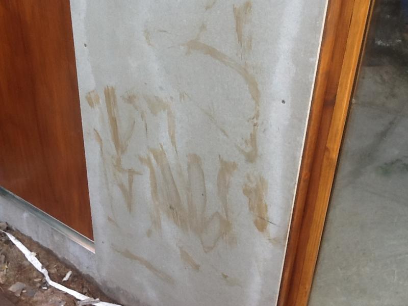

Lesson learned don't put down your brush while staining while your 2year old is in the garden. he likes to help out once you go to the toilet and this is what it looks like after 10 minutes of frantic scrubbing!

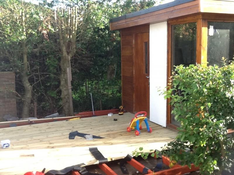

Now were water tight I might push on with the surround decking etc while we have a good dry spell.

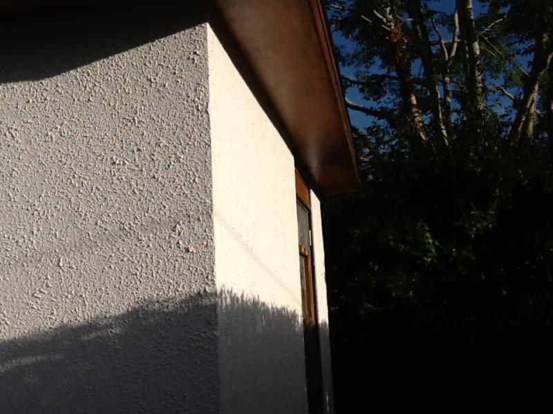

Still researching the finish to versapanal but Still think the render paint is the way to go.
Thinking on putting a couple of windows in the versapanal further back. I was thinking along the lines of a couple of round windows above one another . Not sure.
Fitted a door closer today on the big heavy front door. Its now got a slow swng followed by a click in through the latch. Excellent no vibration hitting the window and no hopefully bashed fingers.

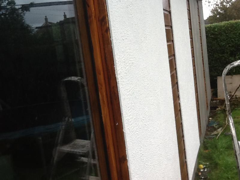

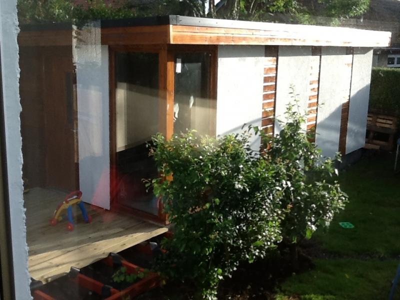

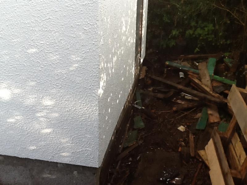

Versapanal now in the process of getting their coating. Its Sandtex high build.
The coating is supposed to be by their high build roller but I found it difficult to evenly spread the material as it is like smearing clay. In the end I applied it with a brush evenly spreading till the whole panel was done then hit it with the roller.

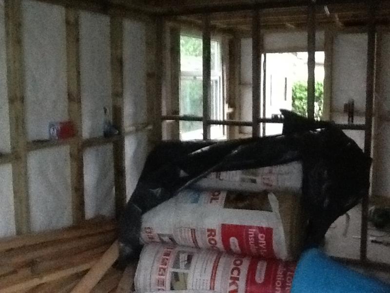

Inside I have started the stud work to seperate the garden room and store to rear. I managed to pick up on gumtree all my rockwool at £4 a roll. Result!

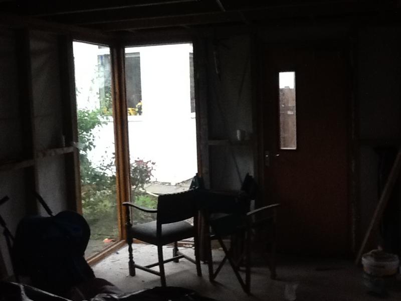

Already I can't resist sitting at my corner window. Be nice when I get the outside decking all complete.

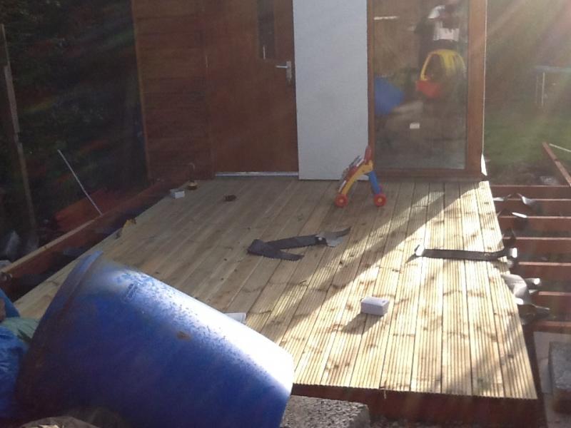

Very slow I know but trying to get the externals finished before winter. Surround decking started and electrics now in.
The new high build render paint. Very pleased with. These pics are the rear entrance to the garden store.
