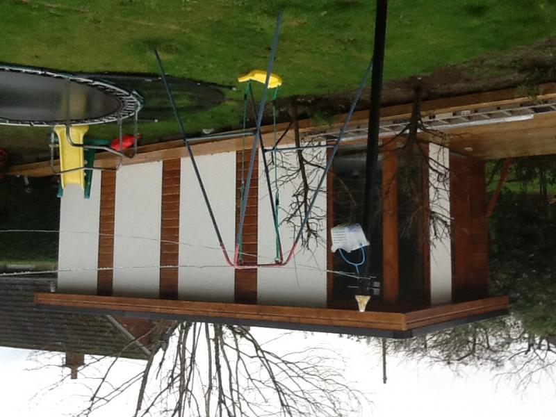

Anyway roof sustained some damage in the storms. I had left the gutter trim off with intentions when I did the gutter I would fit. This hasn't happened so the storm got under the membrane and started to debond the glue. A bit of luck was I was looking at the roof from our upstairs velux window when it started so managed to get timbers along the edge to weigh down. Not good being up a ladder in that gaie. My work just 2 miles away recorded a gust of 98mph at one point ( I thankfully was not on the roof at this point ) Further damage two small cuts in the membrane possibly from flying roof slate have now been repaired.

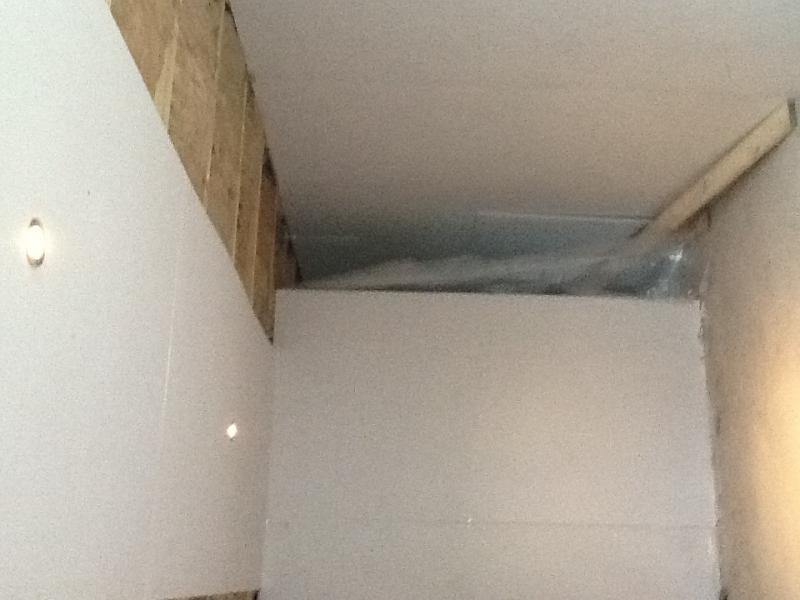

Left a gap in the stud wall to assist in accessing the rear store room. The decking round the back to the garden store room door has also not been completed.
Trampoline also got damaged
Oops these pics seem to have an orientation of their own. Hopefully no one has an old PC with monitor then its a headstand for the last one.

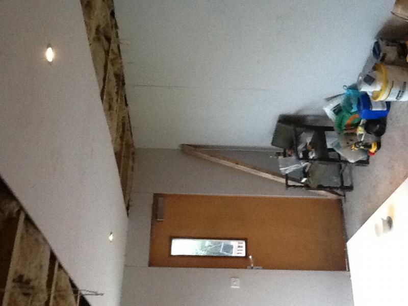

Plasterboard finished and tape and filled joints. Couple of areas will probably require future sanding. painted with Vinyl matt to reduce sight of imperfections. Coving was a nightmare using B&Q Diall lightweight cove adhesive. Had to remove and bin as it did not set.

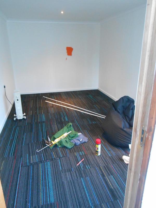

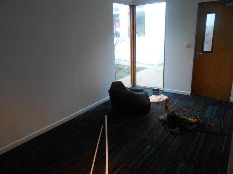

Carpet tiles down and skirting. Painting to be done then its facings round door & windows. Finish decking, fencing & guttering.
Then its finish off the hidden store room round the back.

What did you end up using for the skirting- pins and adhesive?
I'm off now to do final coat on walls and ceiling on mine now.
As I am under strict time limits before the wife cracks under the strain of 3 kids 5, 3 & 1 year old tearing the place apart. I borrowed a finishing gun and rattled it. Ran a bead of decorators caulk round it while being shouted at to come and give a hand.
:roll:
It was cheap n cheerful white MDF stuff from b&Q.

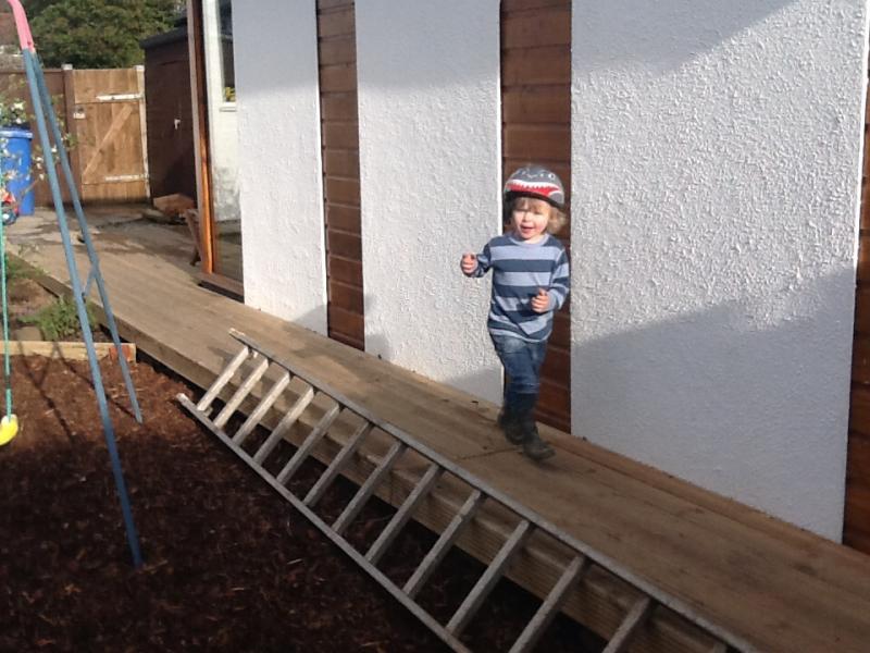

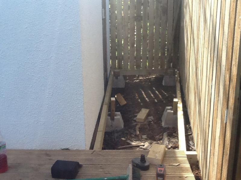

Got on in traditional Easter fashion of erecting fencing and the last bit of decking round the back to the store room.
Found these triangle block things at B & Q for building decking off. Thought it worth a try but a concrete block would be just as good and cheaper.
No longer a obstacle course reaching the rear store door. Decking complete.
I don't make my kids wear a safety helmet on the decking in case anyone thinks so. Made a play area to side with bark and left over decking lengths
for edging.
