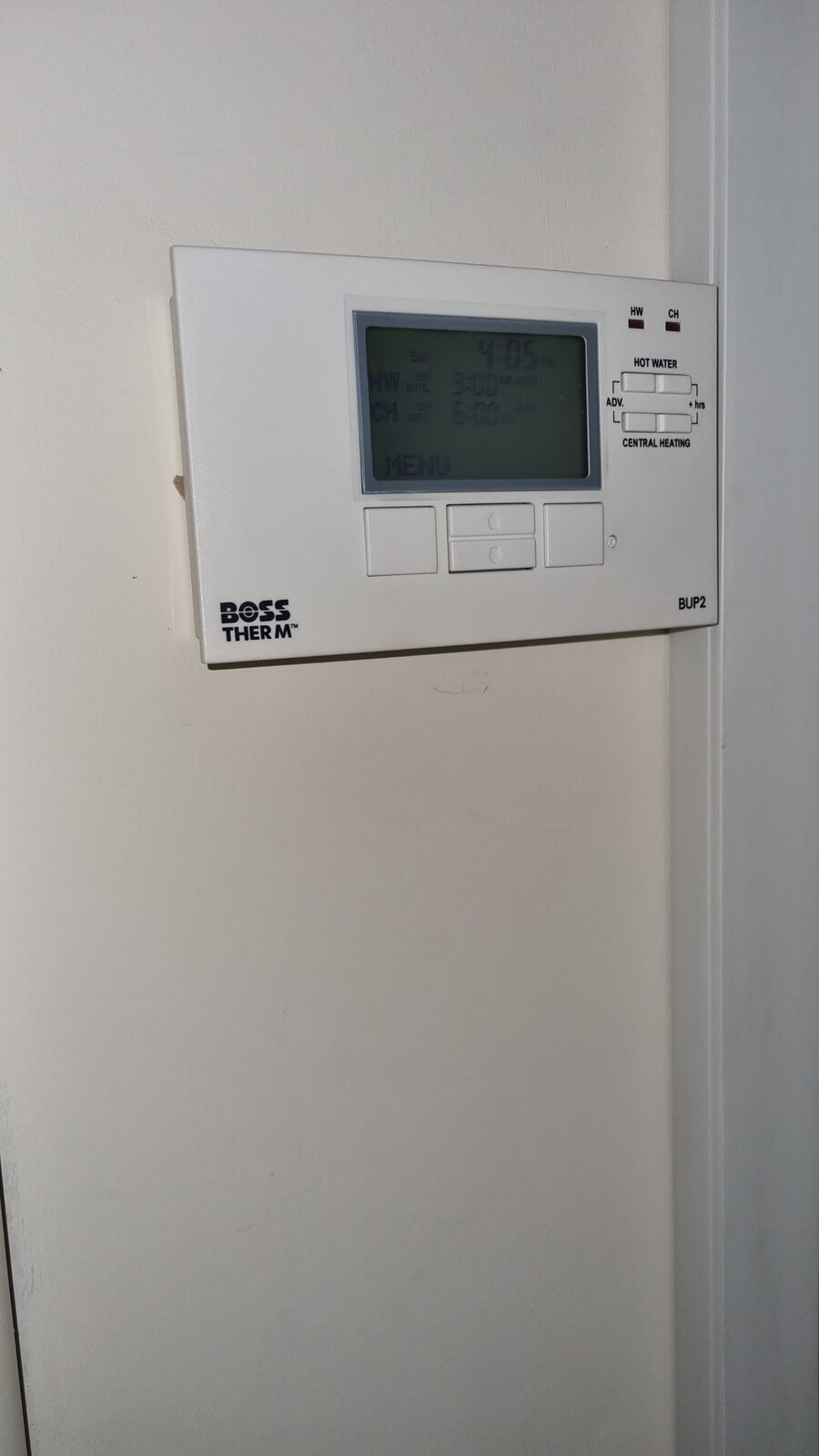

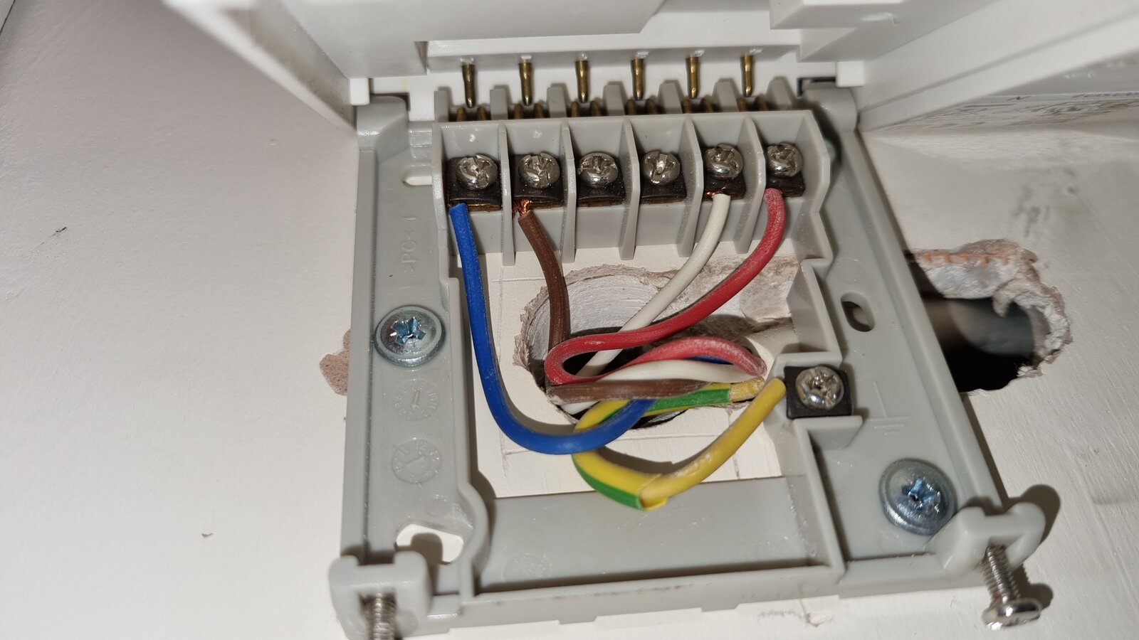

Thanks everyone. So this is what I have next to the water tank. It controls the water tank hot water and the upstairs rads. I only have 1 thermostat upstairs and that is the one in this thread.
I assume that stat has a wire coming into this controller. If that's right, and I swapped this out for maybe something like this, would that then do what i want? If so, which wire do I need to ditch?
No, the programmer sends a live out to the existing thermostat, which in turn sends a switch live back to the motorised valve. You can bridge existing thermostat out at the wiring center, at the thermostat or just turn up to maximum as then the Esi would take over. Esi have a decent following by some engineers on this site.
Thanks. How would I bridge at the thermostat?
Link live and switched live together, or place both in the same terminal which would be 1 or 3 (both wires being used, just terminal 1 or 3 to house both).
